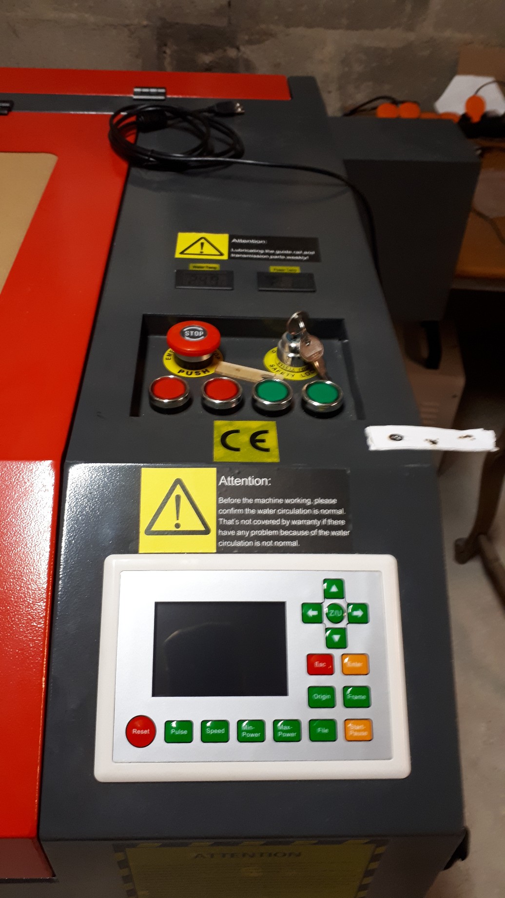

If no solution is found, I wonder if I should use K40 Whisperer. Here is the controller’s display (it is RUIDA M2 I think)
Do you think it’s compatible with K40 W? If yes, can anyone point me to a good tutorial?
I used another laser cutter before, and the job was launched from CorelDraw just as if I was printing. Is it the same with K40? Or do I need to save my model into an intermediate file to be used by K40?
Thanks for your help…
Sorry, I should have added: CorelDraw version is 2019
Here is the picture of the controller (only one pic per post allowed, me newbie)
No, neither K40 Whisperer nor Meerk40t supports the Ruida controllers, at least at this time.

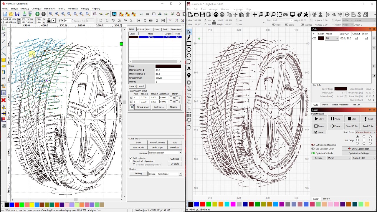

What are the main differences with Lightburn, that would make me to the latter?
For me I use LB because it is faster and easier to use. This is a great video comparing the two;
