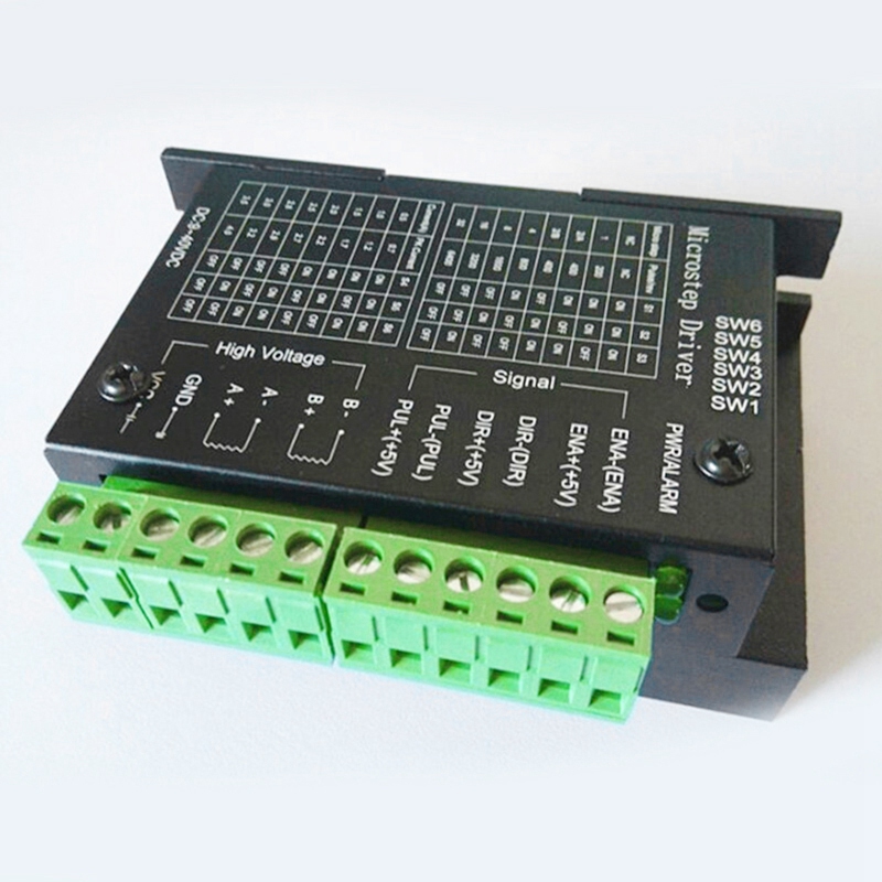

This stepper picture shows what a driver expects to see on the logic input and what it provides fot the stepper motor. It does require a 12 or 24v power supply to drive the motor.

My reason for showing a motor driver was to show what was expected on any driver. I realise that is not what is fitted in this stoneflower printer. What I said about the smoothieboard is valid. M1 M2 & M3 on the smoothie are stepper motor drivers with outputs to the coils of the motors for X Y & Z. It seems from the information given that these all work.

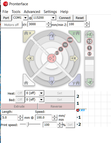

Just one point about pronterface, you can output directly to the extruder on the left side. Marked extrude and reverse. You need to extrude a length set as long as you want when testing.
