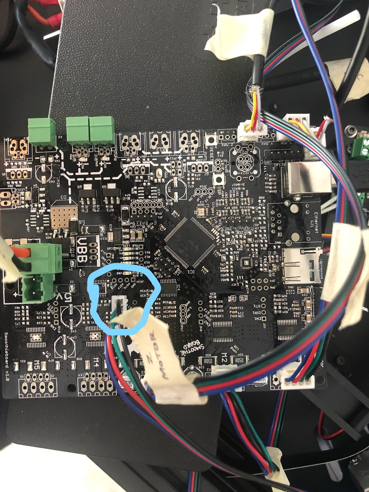

Hi all,
I have the Smoothieboard v1 which I am hoping to use for printing ceramics with a kit from Stoneflower. I already have the 3 motors for controlling my delta printer connected to M1, M2, and M3, respectively. The end effector is moving as expected.
However, I am having trouble sending commands to the Stoneflower control unit, which has its own stepper motor driver for moving the ceramic printhead. I am referencing page 18 of the Stoneflower manual (linked above and pictured below for convenience), which actually uses the Smoothieboard v1 as an example. I did exactly what they said, but no data seems to be getting to the Stoneflower printhead. I am able to manually “jog” the printhead motor on the Stoneflower control board, so I know that the printhead motor is operational.

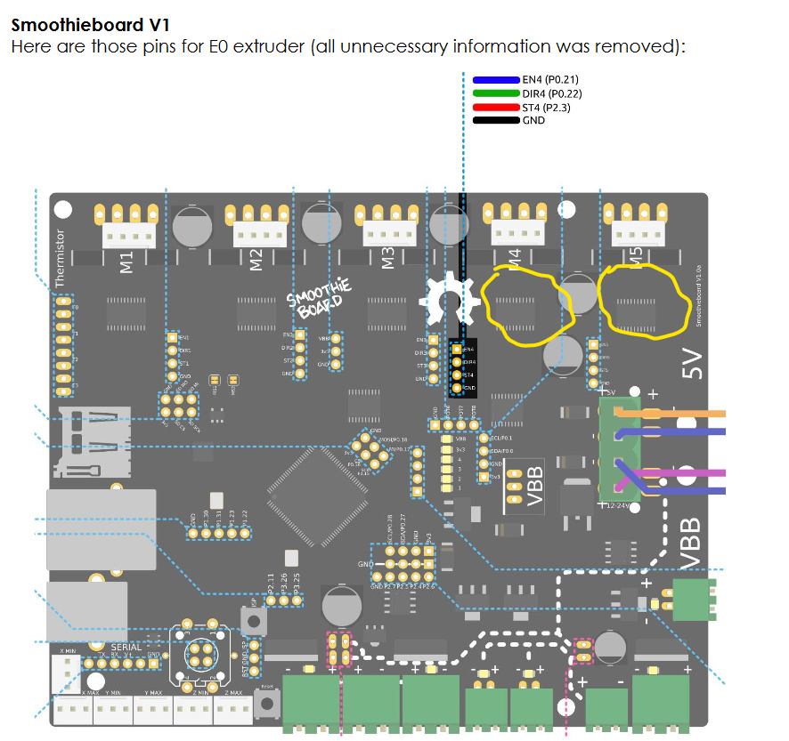

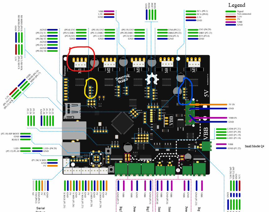

Note that my Smoothieboard does NOT have the two stepper motor drivers that I circled in yellow in the image above (the board just came like this). I figured this shouldn’t be an issue in my case since the ceramic printing kit has its own internal stepper motor drive (as mentioned above). However, for testing purposes, I did try connecting the Stoneflower control unit to M1 instead, and this DID generate movement in the printhead and ram extruder. This part is confusing to me: wouldn’t the signal essentially be passing through 2 stepper motor drivers at that point?
I didn’t change anything related to M4 or M5 in my config file, but I am pasting at the end of this post for reference.
I will also paste the .gcode I was testing with.
Does anyone know what could be going on? Is there something else I need to edit in the config file to send data to the pins labeled EN4, DIR4, ST4, GND on the Smoothieboard?
Please let me know if I can provide any more information about my build. I realize its a pretty specific set of circumstances. Thanks so much in advance!

Could you post a picture of your fully-wired board to make sure there are no missing assumptions?
Sure! Here is a photo of the board in the current configuration:
I circled where the Stoneflower wire is currently plugged in.
The En/Dir/Step connections are 3.3V logic signals. When you plugged it into the M1 you did plug it in downstream of the stepper driver, and you sent the motor voltage to the external stepper driver. I hope it wasn’t damaged by that!
The M1-3 connections are connected to motor voltage, 12-24V depending on what you have connected. This may have damaged the Stoneflower stepper driver if it isn’t protected from those high voltages on what are supposed to be logic signals. :frowning: Those voltages change relative to each other so movement isn’t a surprise. See the bright red warning on page 16 of the manual you sent:

I believe this configuration you have is correct for the extruder pins:
extruder.hotend.step_pin                        2.3           # Pin for extruder step signal
extruder.hotend.dir_pin                         0.22          # Pin for extruder dir signal ( add '!' to reverse direction )
extruder.hotend.en_pin                          0.21          # Pin for extruder enable signal

what happens if you plug your external stepper driver to the step/dir pins for your X axis?
So, plugging the external stepper driver into the step/dir pins for the X axis (or Y / Z) doesn’t seem to work either. I did note on the multimeter that the EN pin for all of these was not showing any signal, however…is that normal as well?
As for your first suggestion: I tried setting extruder.hotend.dir_pin to 1.22 in the config, but still no signal on that pin either =/
Your priority should now be trying to get the stepper driver working off the X driver’s step/dir pins, this is sounding very much like there’s an issue with the external driver itself. Please try connecting EN+ to EN- on the driver itself with a short wire, and only controlling it with the step and dir pins. If that still doesn’t work, try using the open-drain method ( which should make it so the on-board X driver doesn’t work anymore, but hopefully the external one will )
Can you show how you were measuring that? The drivers on board can’t move the axes if they aren’t enabled, and you said that it did move when you hooked it up to M1, which means that you can’t be measuring it correctly if you aren’t seeing an enable signal to the M1 stepper driver.
Ok so maybe I am misusing the symbol “M1” here (apologies if that’s the case), but the printhead moved when I connected it to the pins circled in RED in the diagram above, although we determined that this may not be appropriate / correct, per the Stoneflower documentation. It does not move when I connect it to the pins circled in YELLOW (or any of the other corresponding 4-pin slots for M2, M3, M4).
This is how I was measuring the EN pin with my multimeter:
The DIR pin in this group reads 3.3v as expected. The EN pin reads 0. Let me know if I can clarify any of that any further.
Interestingly, I just measured ~2.4v coming out of both the EN and DIR pins of the 4-pin slot circled in purple-ish/blue above, which I thought corresponded to M5 (which I don’t even have enabled in my config?). I am pretty confused.
