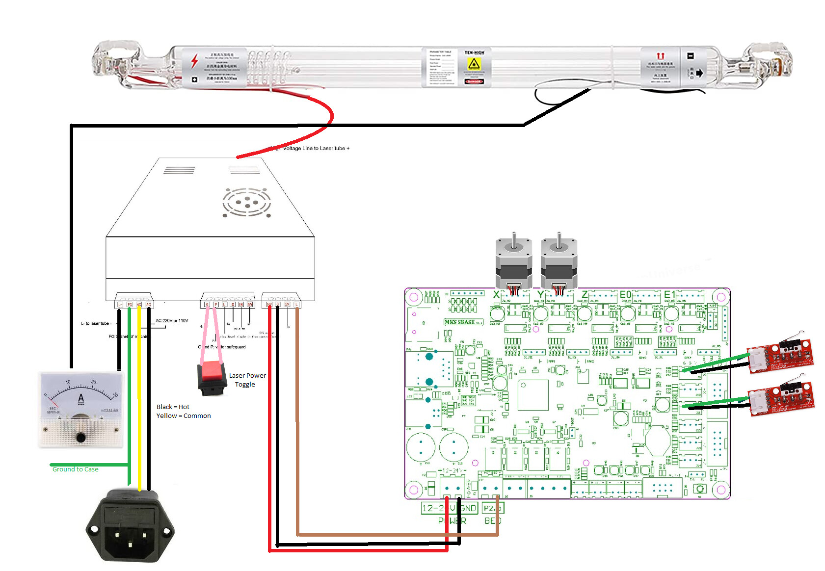

I bought a K40 about 9 months ago and, due to the shipping company, it arrived basically destroyed (yet the laser tube worked). I decided to gut it and build a bigger gantry and also wire up an MKS Sbase as part of the process. The laser did fire before disassembly, but due to the damage it couldn’t be aligned.
I’m using grbl-lpc, preconfigured for the MKS Sbase (thanks a million cprezzi!) and have it all wired up (see attached picture), but when I hit the test fire button in Laser Web nothing happens. I have full control over the steppers and can move the gantry, just cant get anything out of the laser.
Do I have something wired wrong? Is there something in the firmware I need to switch? I’m at a loss right now and could really use some help.
I did notice on the various wiring diagrams, the two "L"s are connected so it doesnt matter which I wire too, correct?
Does this diagram reflect exactly how the Laser Power Supply is wired??
Yup, with the exception of the socket/wall. They’re in the proper order.
Edit: I just noticed I forgot the power toggle, which is wired in on the Hot between the socket and power supply
