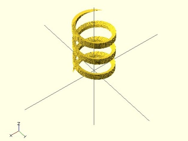

Not sure if this is what you are looking for but if you have access to a 3D printer, this would be the quickest way to do it using openscad.
Here is another solution in openscad
@HalfNormal these are different springs. The goal is to create a constraint, so it’s cutting a spiral out of flat stock, such that the material is held in two axes and can move in one. But instead of being the normal spiral torsion spring, being used to constrain motion to one direction.
