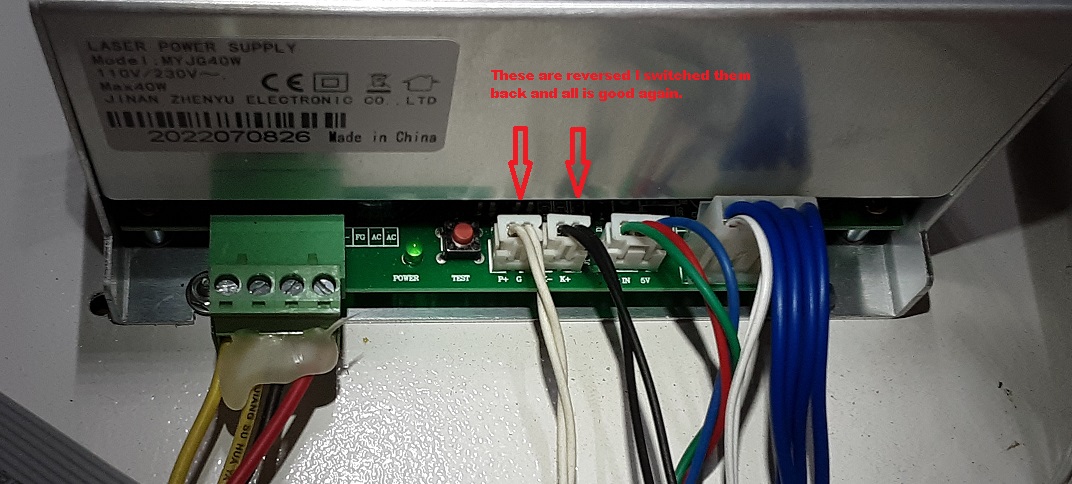

Picture of LPS connectors?

Hi Don…Thanks…Yes, I’m the that guy. I’ll get a picture of the LPS connectors up. My cell is not posting pic out right now so I’ll have to get the DSLR out . Not sure how to post the pic yet. I guessing it’s a drag and drop to the screen or hitting the upload icon. Last night I was thinking about it and I may have, when replacing the LPS, inadvertently switched the 2 pin P+ Grn and K- K+ plugs when putting it back together. I’ve got to go out and check that. What would happen if I did that? Any idea?

“2 pin P+ Grn and K- K+ plugs” Hummm? I did switch the plugs? The K- K+ is to “Laser enable” and P+ Grn is “Test sw”. I’ll switch them back and let you know the results.
OK it’s fixed! I think either my Pot had gone bad or the LPS was failing. Anyway, when I replaced the LPS I accidentally plugged P+ Grn in the left 2 pin receiver and K-K+ in the right. On my setup it will not fire in the program in that case. Thanks for the help Don and Michael. Don, thanks for your hand drawn schematic on your “Don’s Laser Things: K40” site.
