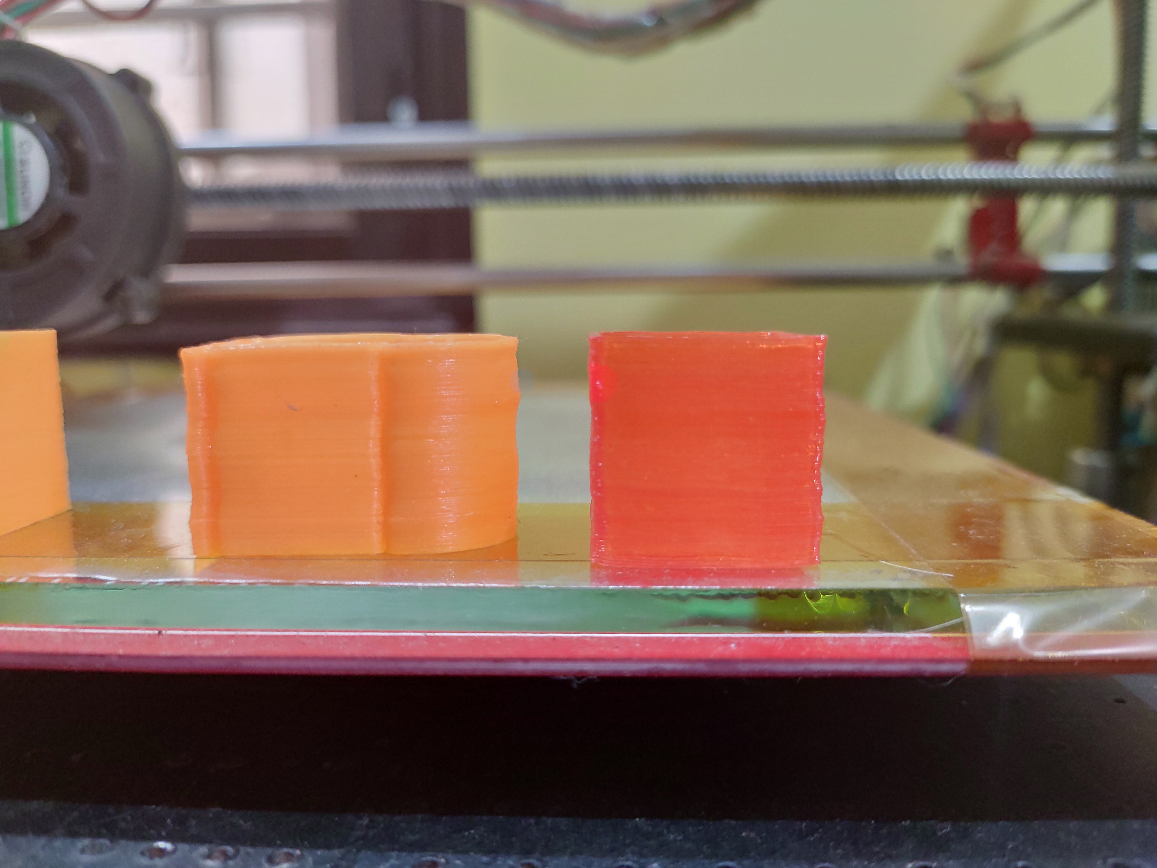

I built this kickass fully hand made 3d printer which i call it the ‘Rex_1.0’ and runs on marlin firmware.the dimensional accuracy of my prints on the XY plane is spot on but when it comes to the z plane the layer deposition seems to be uneven,which looks like a leaning consistent zigzag pattern on the Z plane of any print i try irrespective of the filament material i use.this is mostly noticable when i prints like the calibration cube.i read in many forums that this might be due to loose belts,gears and other moving parts…but i use lead screws for all 3 axes and hence not a belt driven system.I have double checked for all the possible loose joints and screws and all of them are as tight as they should be.i’ve also printed them at super low speeds as low as 10mm/s just to take speed, jerk and acceleration factors out of the equation.the z offset and structural alignment of the machine is right too.ive changed the nozzle, played with different temperatures, z height, babystepping and also different slicer settings too and still the problem persists…ive tried all possible soultions so i really need you guys to help me find out what I’ve been doing wrong!

To give folks here more of a chance of helping, please add some more pictures and information.
  • Pictures of the whole machine from a few angles might give people ideas what else to check.
  • Very carefully focused pictures of a single calibration cube from multiple angles. The focus isn’t good enough in the first picture you uploaded for me to see individual layers.
Those might help others ask more informed questions.

There were at least two possibilities I saw initially; the layers were shifted, or layers were not all the same thickness. As far as I can tell from the album you posted, the layers are shifted, which I would expect with not using anti-backlash nuts and trapezoidal lead screw. I think you’re going to want to find a way to redesign to use anti-backlash nuts. It will be cheaper than buying ball screws!
