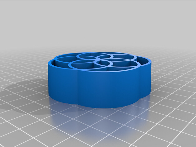

Created another variant to enable making molds by specifying a draft angle for the sides:

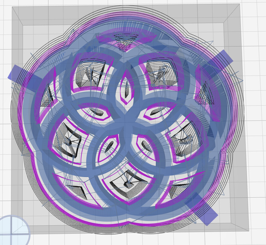

Here’s a top-down view with roughing op with ¼" flat mill as black lines, and outline op with ⅛" ball mill as pink lines, and three tabs in lavender:
It also has a simulation that draws a mesh. It’s not real-time but it shows the path.

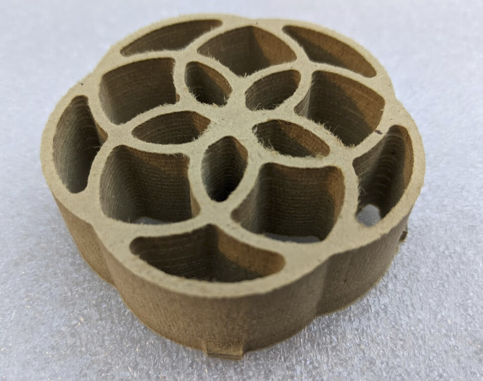

It did a really nice job on my MDF prototype.
I think it’s about 15mm too narrow so I’ll scale up for the aluminum version. I also made the bars a little thicker but not much.

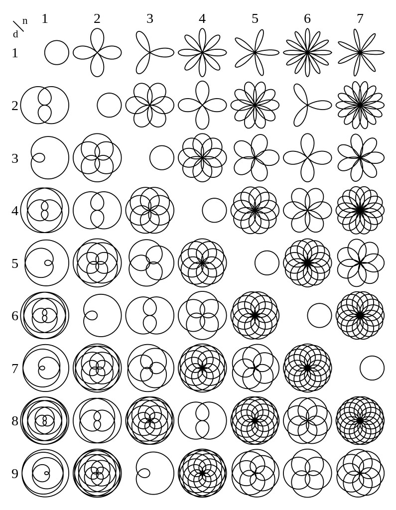

I’m just used to thinking of the curves by numerators and denominator as shown in this chart from Rose (mathematics) - Wikipedia

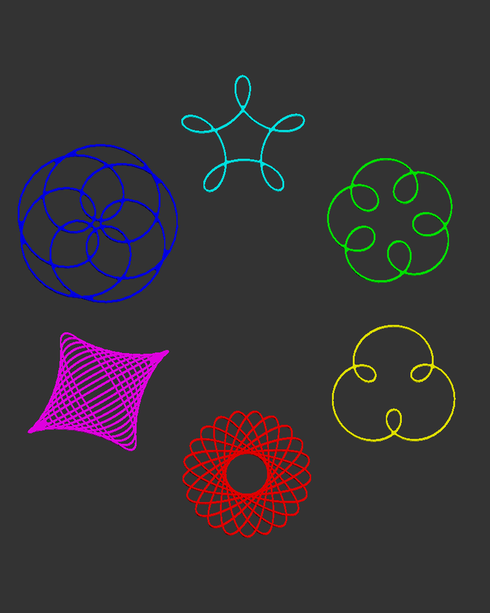

Last night, I didn’t try negative ratios. Those let me do some additional shapes. When I use -5, that gives the 5/3 curve:
I haven’t figured out how to make the integer curves using your approach.
plus or minus changing the rotation …
with Rosette(r1=10,r2=10,ratio=-5/3); i get this.
(the module is in ub.scad) As the module calculates how many turns needed for a closed curve… you get nice results for ratios little bit off like 1.1 or 0.15 (don’t try .14 as this need 550 turns).
Also i made it usable for 3D … so you can just use a 3D child object (cone or sphere).
-5/3 with the code above gave me this:

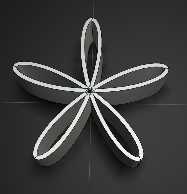

I should consider porting your method to CascadeStudio — the original OpenSCAD model I worked with could also do lots of different trochoids, but my CascadeStudio implementation I limited to rose curves for simplicity.

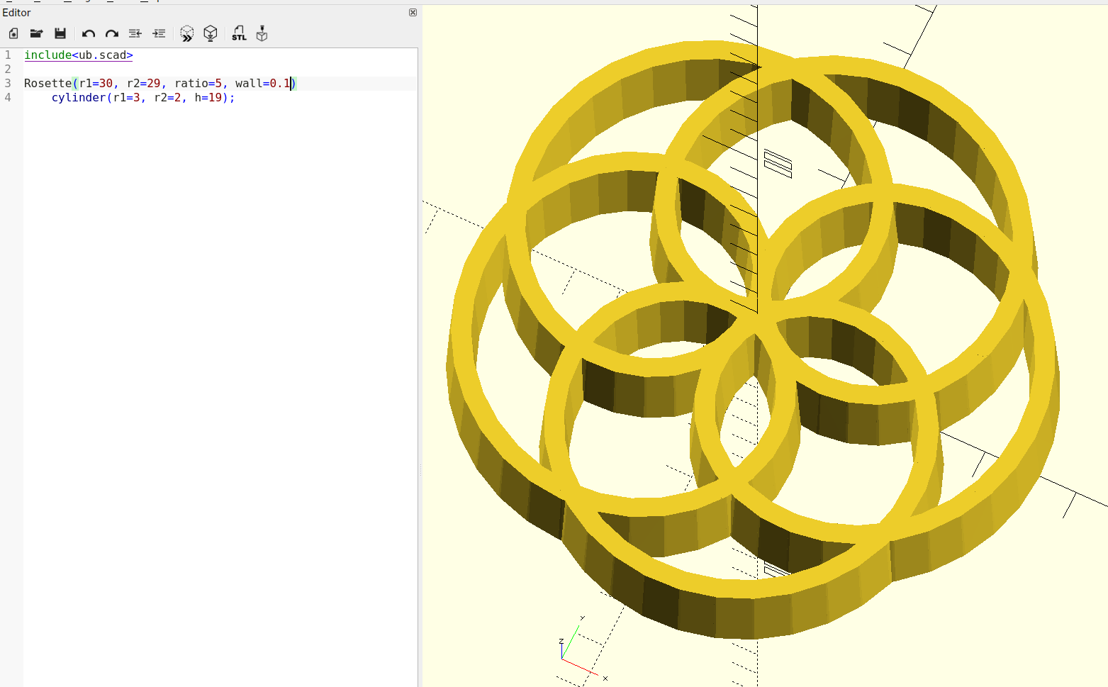

include<ub.scad>
Rosette(r1=30, r2=29, ratio=5)
    cylinder(r1=3, r2=2, h=19);

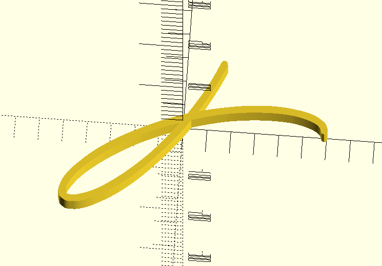

Here’s the quick preview:
Render is slow, though. By contrast, CascadeStudio using OCC means that fully rendering the CascadeStudio version is nearly instantaneous.
I glanced back at my CascadeStudio code, and getting a working model required that the pipes not be self-intersecting, so I broke the pipes at every min and max distance from the origin. The clever use of rotation and translation in your Rosette code means I would need to use another tactic. I think breaking the pipes when the angles are the same mod 180° would probably work. So it wouldn’t be as succinct as your ub.scad code, though it should render faster.
