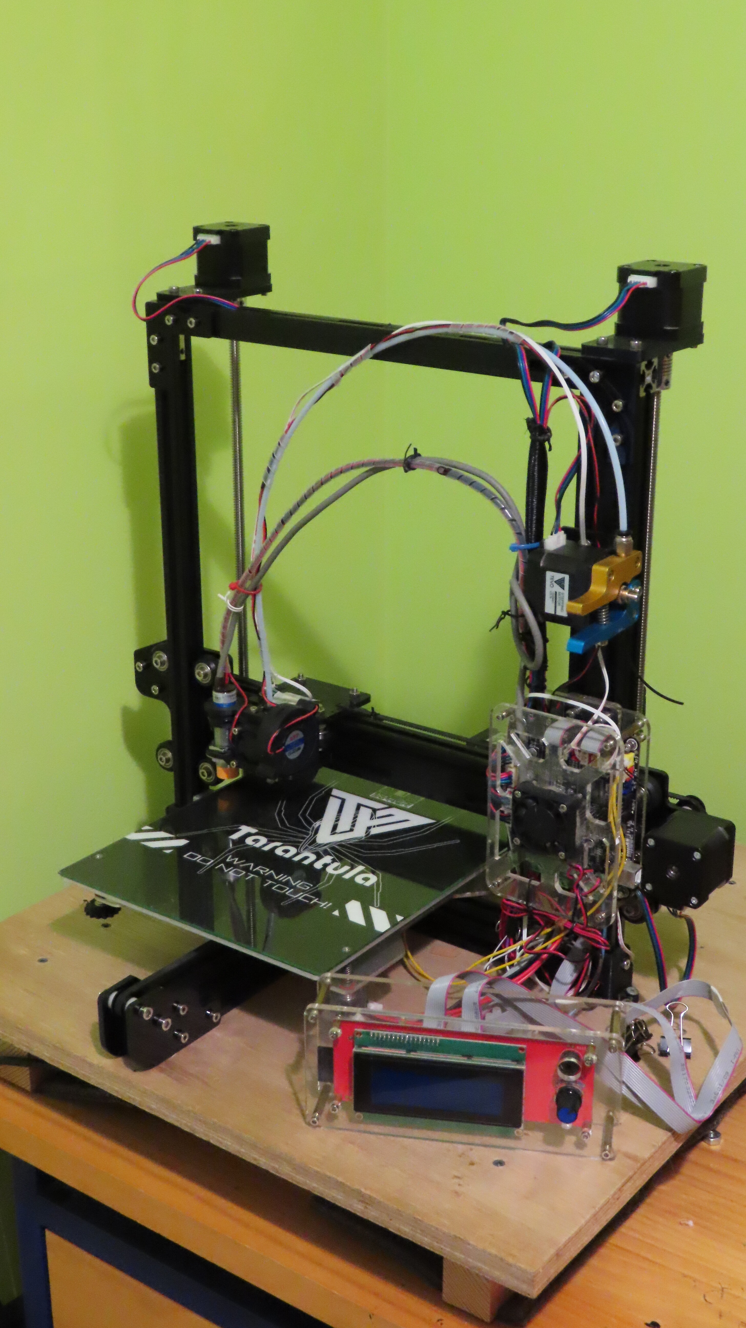

About five years ago, for my birthday, my family bought me a Tevo Tarantula. Not a 3D printer as much as a box with all of the components that when put together in the right way can produce 3D prints from GCODE. I had a LOT of fun putting it together, and upgrading it, by adding a second Z axis lead screw and motor, automatic levelling using a capacitive proximity sensor, etc etc. and I produced a large number of 3D prints for friends family and my workshop. In spite of the cool name, the Tarantula looks like a bit of a Frankenstein Monster, and I feel that the capacitive proximity sensor was a mistake in that the triggering distance is temperature sensitive and so the Z offset varies from print to print.
