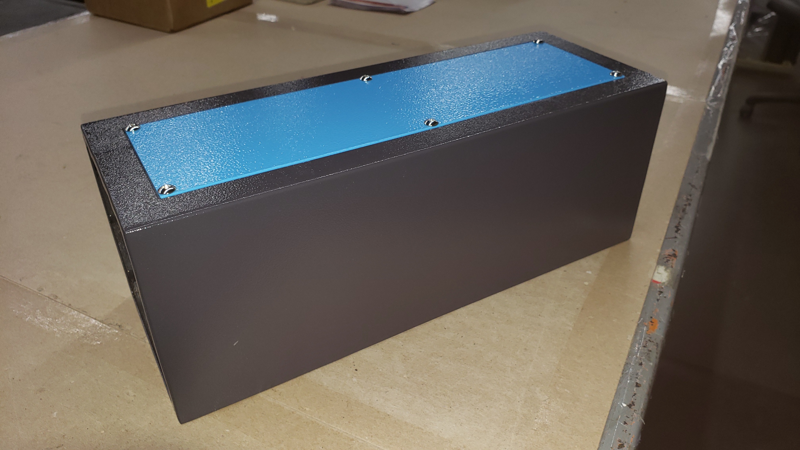

I got the extension tube on Friday so I was excited to get going. The extension tube is pretty nice, better than what I was expecting.
It came with 2mm hardware but I used 3mm in place because they are slightly larger.
I cut a hole in the side of the machine, made a pattern for the screws off of the extension tube and used VHB tape as a gasket. Getting the nuts on the bolts inside the machine was a practice in patience. If I ever do another K40, I will fit this before stuffing everything inside.

Where did you get the extension tube from?
Awesome project :+1:
It appears to be a Light Object extension.
https://www.lightobject.com/K40-Upgrade-Parts/K40-Mini-Laser-Machine-Tube-Extension-Case
The tube is the SPT 850mm CO2 Sealed Laser Tube (40W) from light object and the extension tube was purchased from light object as well but it was ordered through amazon.

His new tube is an actual 40W tube vs the 35W tube the K40s actually come with, so it’s more powerful. Power scales with tube length so the 40w tube is 130mm longer than the normal 35W tube, hence why he needed to add the extended enclosure.
