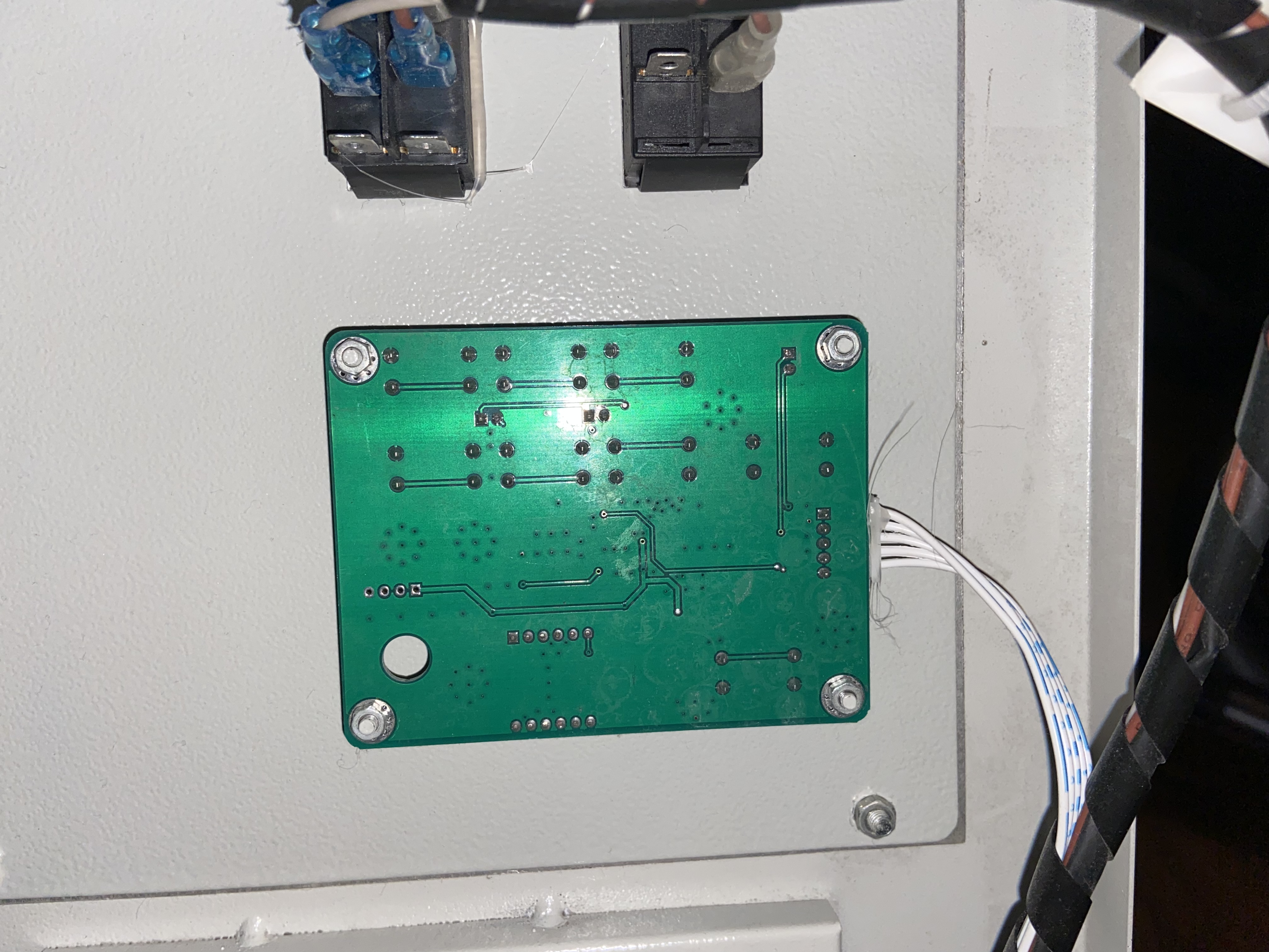

Post picture of:
Control panel front and back

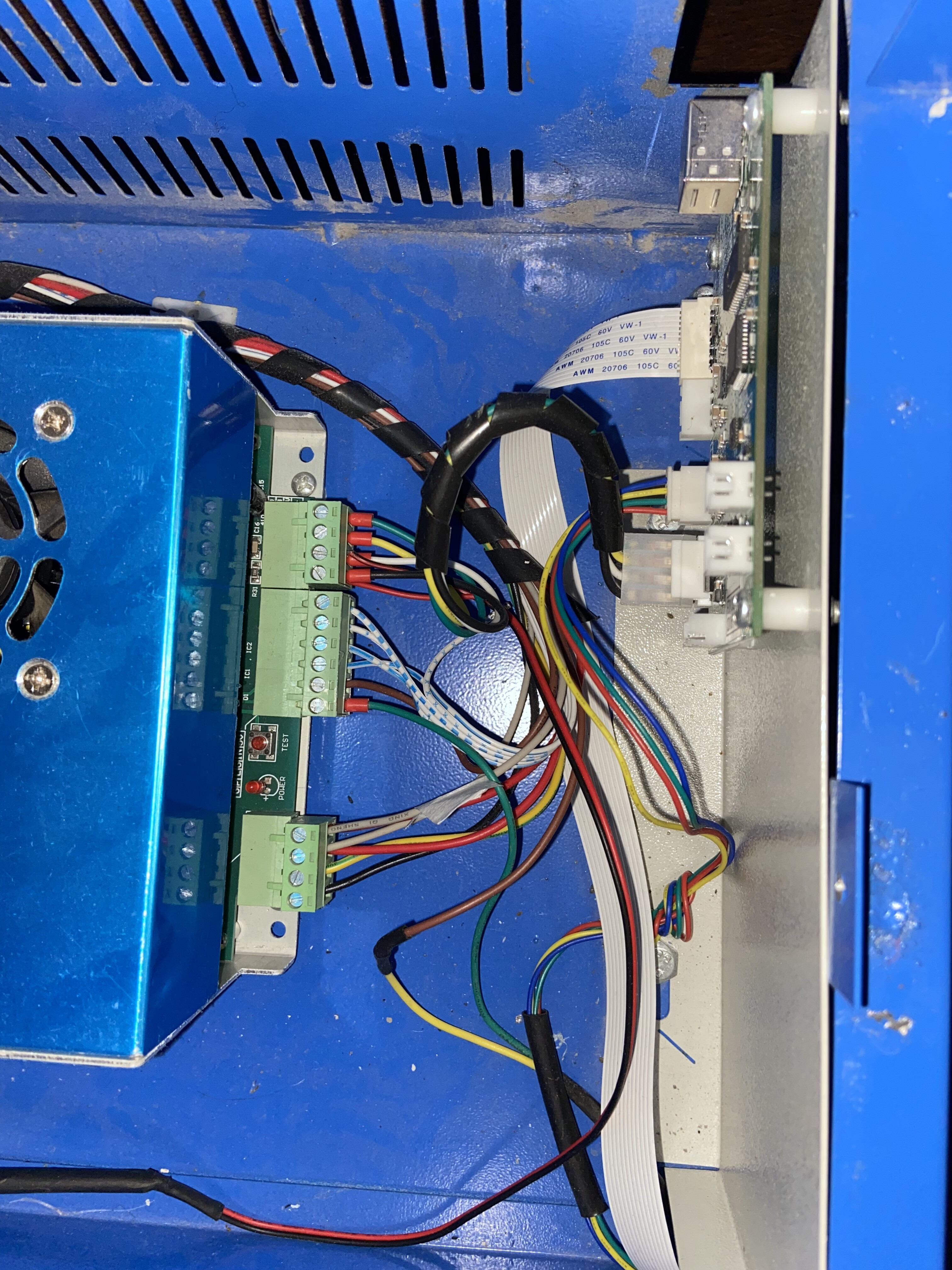

Close-up of your current LPS showing the connectors
Close-up of your new LPS showing the connectors
Close-up of the controller (nano) showing connectors.

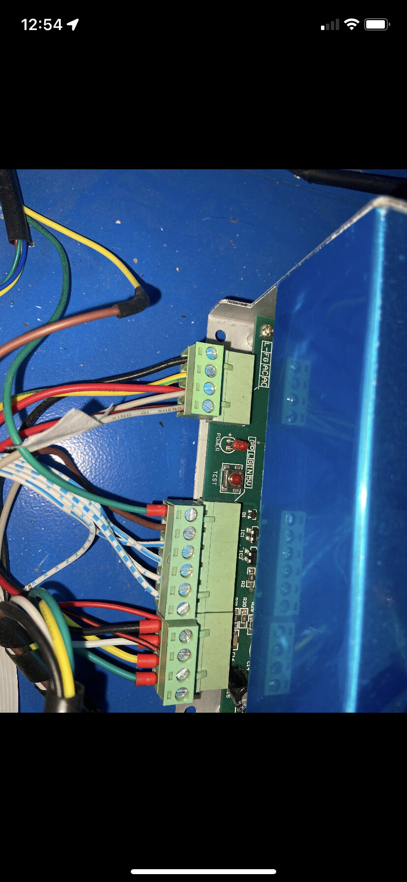

Is this ok?
Thanks I need a better view of the wire colors plugged into the Nano’s right 4 pin connector.
Can you trace and provide a drawing of the existing wiring from the Digital panel to the LPS? These are white wires with dashed highlights.
Is there a model # on the existing LPS?

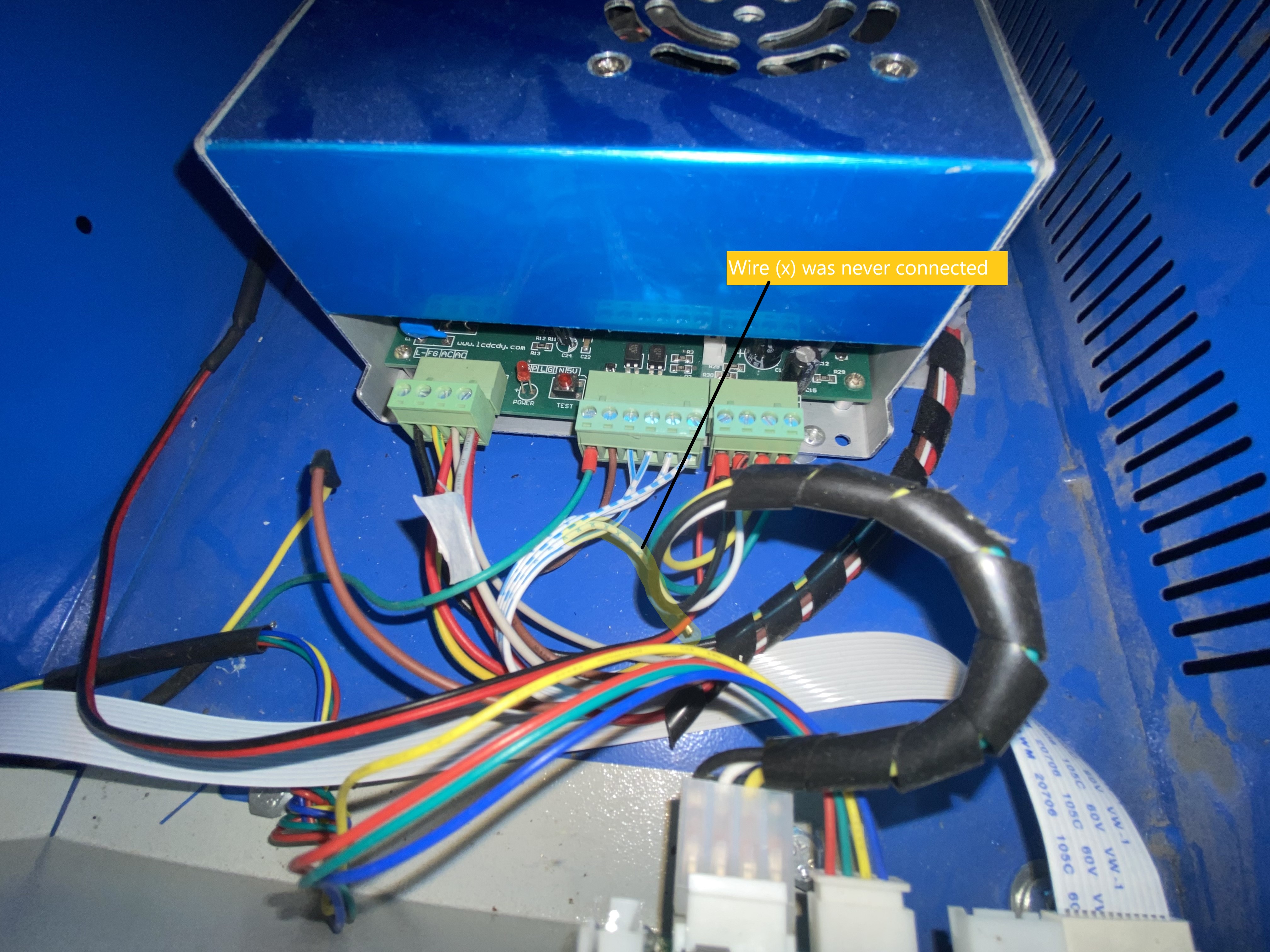

Hi, yes I’m going to include a current meter and am going to use a pvc housing for the laser tube. I was drawing a diagram and noticed K+ is disconnected (must have occurred when I was unscrewing the nano) and am unsure where it goes back in.

From your previous picture looks like wire (X) it was not connected.
K+ and K- are actually connected together internal to the panel so they do the same thing. Therefore having K+ the (x) wire NC is ok. However I would put heat shrink over it.

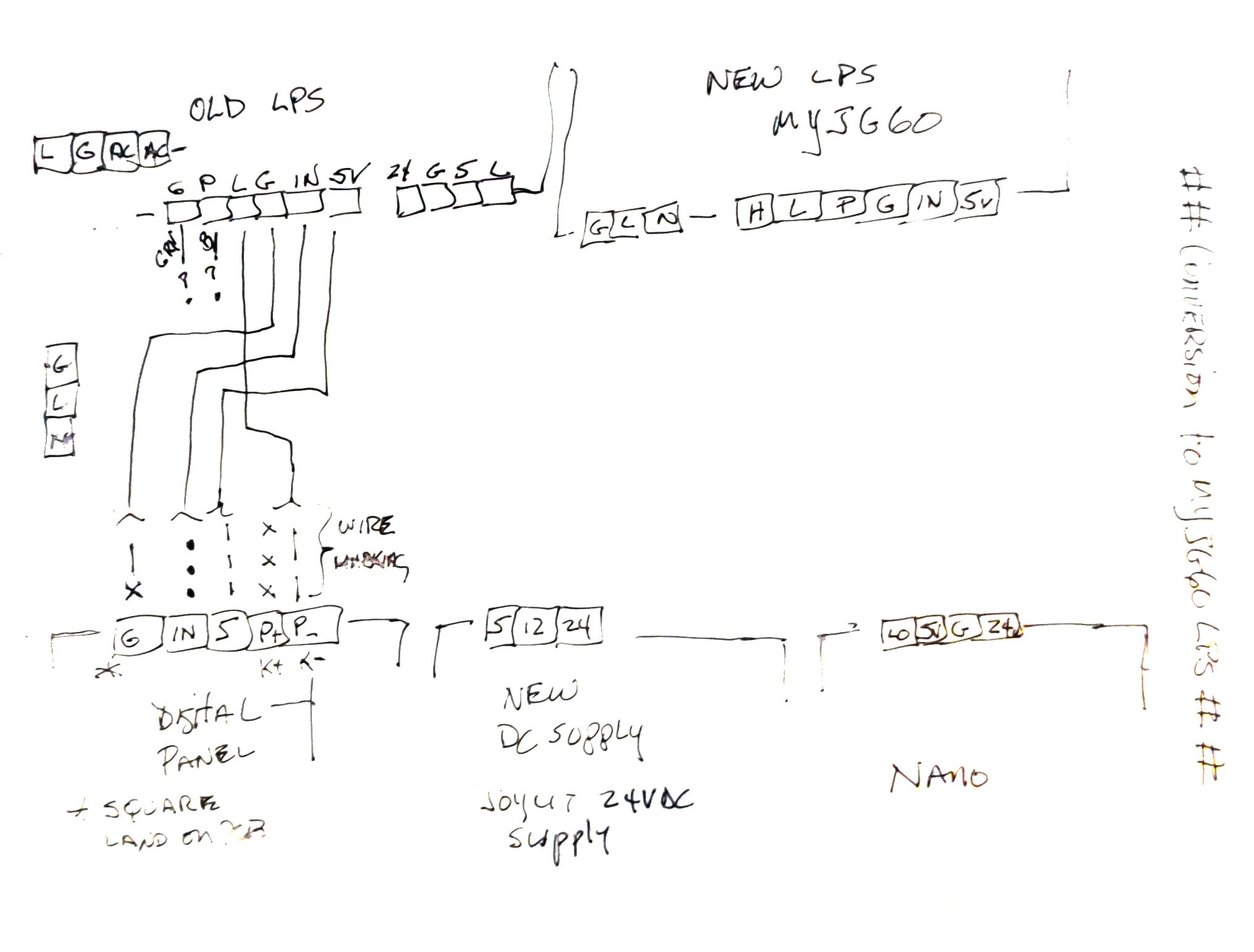

I need you to check to verify if my wiring diagram for the cable that goes from the LED panel to the current LPS is correct.
It is the cable with the blue markings.
Please check that my drawing matches what is wired in your machine.
Also where do these wires go:
  • Green wire on the LPS-G pin?
  • Brown wire on LPS-P pin?
The green wire goes to the safety switch and the brown to the power switch, also is the power supply ok? When I click the link it doesn’t go to a product page.
And yes just double checked the wiring in the diagram for the psu to control panel is right :slightly_smiling_face:
