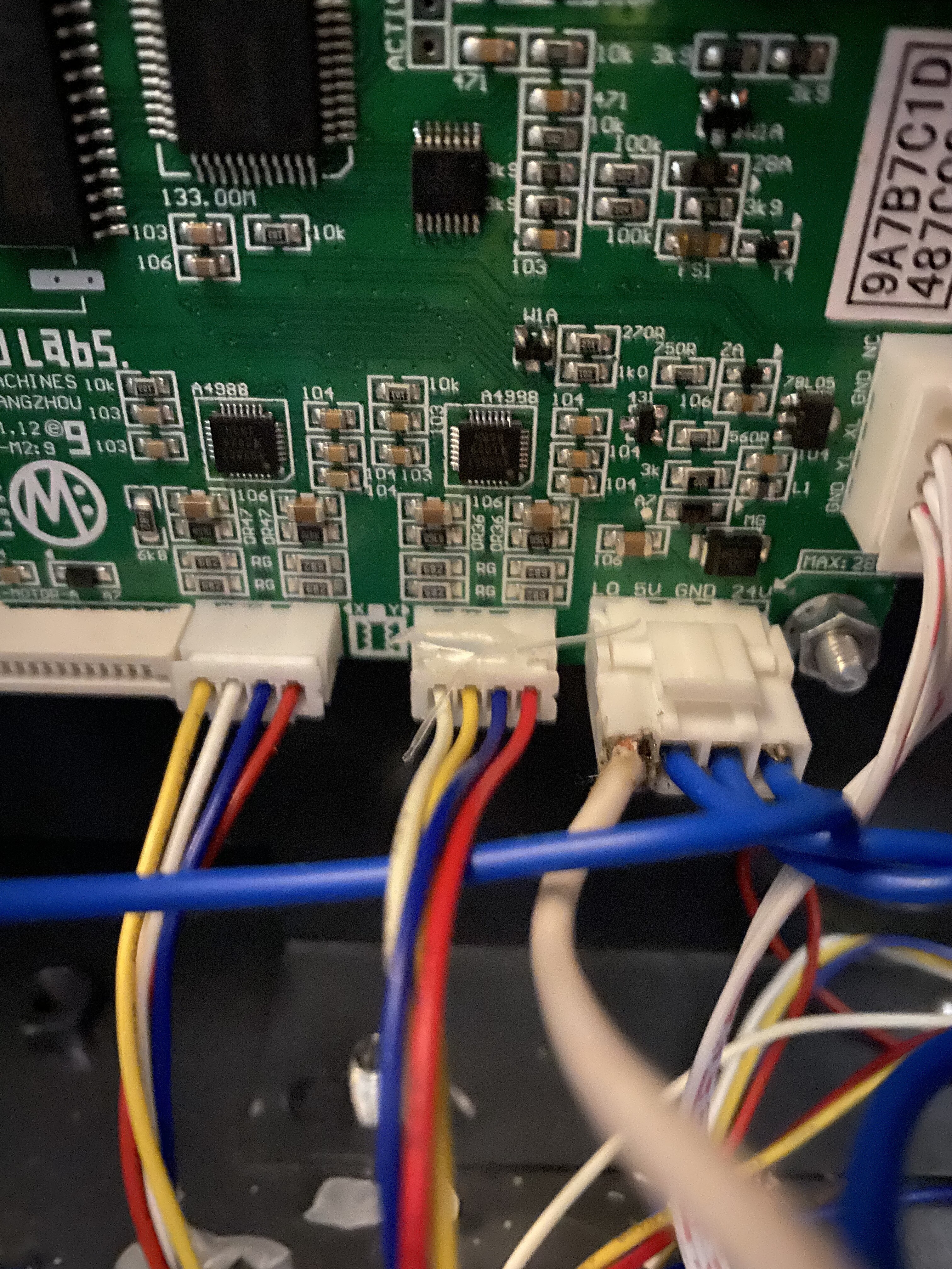

I will post pictures of the inside of the box, but they aren’t pretty as I used more wire nuts than I would have liked and bypassed the pump low flow interlock as I don’t have a low flow switch installed. Also, I don’t like how the manufacturers made all the wires from the power supply to the M2 Nano blue and how small some of the control wires. After stripping them, they had like 4 thin strands of wire each. I thought about replacing all the wires in the system with more easily identifiable wires.
I’m not certain 1-4 are entirely accurate. If I had shorted any components to ground, I would have popped a fuse or fried the new power supply immediately. Also, 4 certainly isn’t accurate as the Laser wasn’t constantly running, only ran while test firing it, and could be shut off by pressing the “Laser Switch” on the main panel. That being said, I’m almost certain some of what you said in 1-4 is correct as I was getting a 5v drop somewhere I wasn’t expecting. Unfortunately, I left my multi-meter at work and cant test which one that is at the moment. Tomorrow night I will certainly test it and update the forum.
I will try #1, but I’m pretty certain its only grounded because it should be connected to a low flow switch/interlock and the K40 system doesn’t currently have one installed. Also, the laser switch currently works.
I will purchase a 5v external power supply because even if it doesn’t happen to be required, its always nice to have more power.
I have previously verified the LPS, Nano, Nano Power Supply, 24V Power supply and the control panel grounds are all connected together by ground connections to ground. However, I was creative with this as I was an electrician before and used the WP terminal as ground since it was connected to ground (i.e. the same node).
There is no way for me to go back to the working software configuration I had before I blew the breaker. I had the drivers for LibUSB installed on the previous configuration and unistalled them as many trouble shooting videos instructed me to do prior to reinstalling them to try and fix communications issues with the laser.
Again sorry for these pictures. I would have never used all blue wires to connect to the M2 Nano if I had designed the system, but I was working with what I had. Also, one of the wires came out of the LO plug on the M2 Nano and I had to insert the white wire into it and wire nut it onto the blue wire initially inserted there. I have tested continuity between the end of the connector and the wire nut several times to ensure the connection is secure. This is the main reason I took the time to draw the schematic I used as it is pretty hard to follow without it.
Also, I’m not sure how to change my username. I checked the preferences tab and it seems like I can update emails, add information about myself, etc, but I don’t see a way to change my user name outside of setting up a new account.

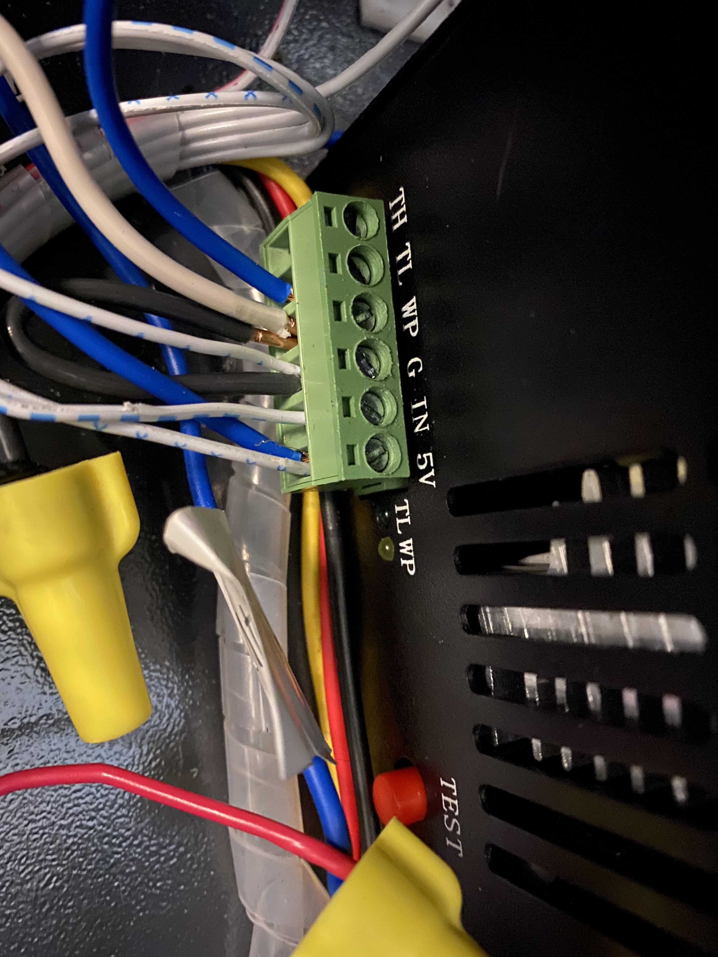

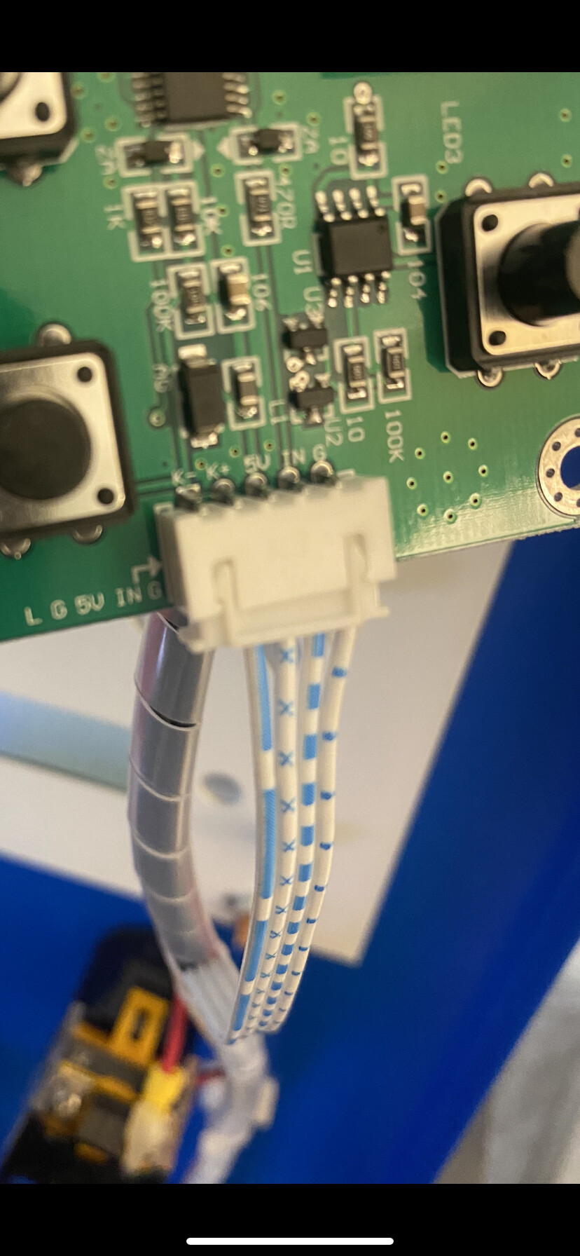

In regard to the K+ connection to TL
Keep in mind I am looking at photos of wiring while imaging the actual wiring :slight_smile:
This picture shows the connections from the panel.
Wires labeled as such:
Ground = . . .
In = --------
5V = x x x x
K+ = __ __ ___
Then I go to the picture of the other end I see:
The Gnd, IN & 5V connected to the LPS
I do not see the K+ connected to TL and TL has only one wire at the LPS
and one wire at the Nano.
Is this because:
  1. You removed them before taking this picture
  2. I am not seeing the whole picture
  3. The schematic is wrong

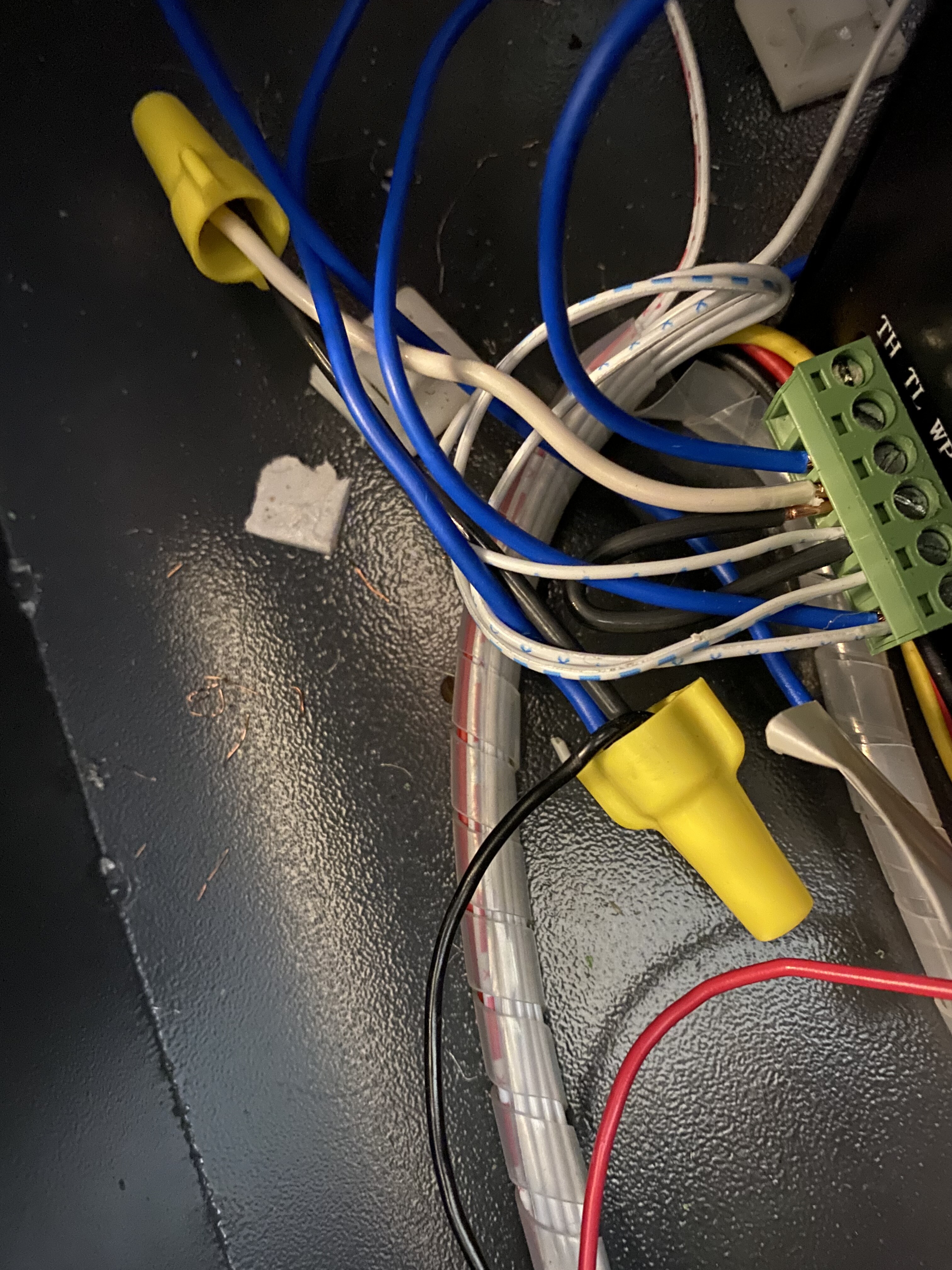

Other wiring observations:
This picture shows :
  • WP is connected directly to G
  • WP is connected through a white wire to a black wire
Where does that black wire go?

You are correct with regards to the wire connected to the TL from the control panel. I disconnected it from the the TL terminal on the LPS when you said it didn’t belong there to test to see if the computer could find the laser. However, I forgot to reconnect it prior to taking my pictures. Currently, I’m running a retail shop inside a swap meet in Las Vegas. We are only open on Friday, Saturday and Sunday. We are able to work on remodeling our booth on Thursdays and I expanded my shop two Thursdays ago. TLDR: I have been working/commuting for roughly 14 hours a day and that’s why its slow for me to respond. Its also the reason I spent roughly 30 hours troubleshooting on Monday, Tuesday and Wednesday of last week.
That is correct. I explained that above. Its required to be connected to ground to bypass the water pump low flow switch that is not installed in the stock K40 laser. The original LPS does not have a WP connection to even allow for this protective feature.
The black wire goes to the ground of the external 24V power supply.
There is a white wire connected to a wire nut from WP which is the same as ground because WP is connected to ground using the U shaped black wire. The white wire is
connected to a second black wire that is straight and connected to the blue ground wire from the M2 Nano and the ground wire of the 24V external power supply. From an electrical standpoint, the M2 Nano, the 24V External Power Supply, and WP are all connected to ground from the same node, I just used 2 wire nuts and two terminals on the LPS to do it. I previously said it wasn’t pretty, but it allowed me to connect the 4 things I wanted to ground (WP, the Control Panel on the top of the machine, the M2 Nano, and the 24V external power supply) to ground without having to put 4 wires into a single wire nut or terminal. I’m hesitant to connect even 3 wires using a single wire nut or terminal, but I didn’t want to add a third wire nut to the mix. If everything had worked after my connections were made, I would have wrapped all the wire nuts with electrical tape, but I left them un-taped in case more rewiring had to be done, which appears to be the case.
