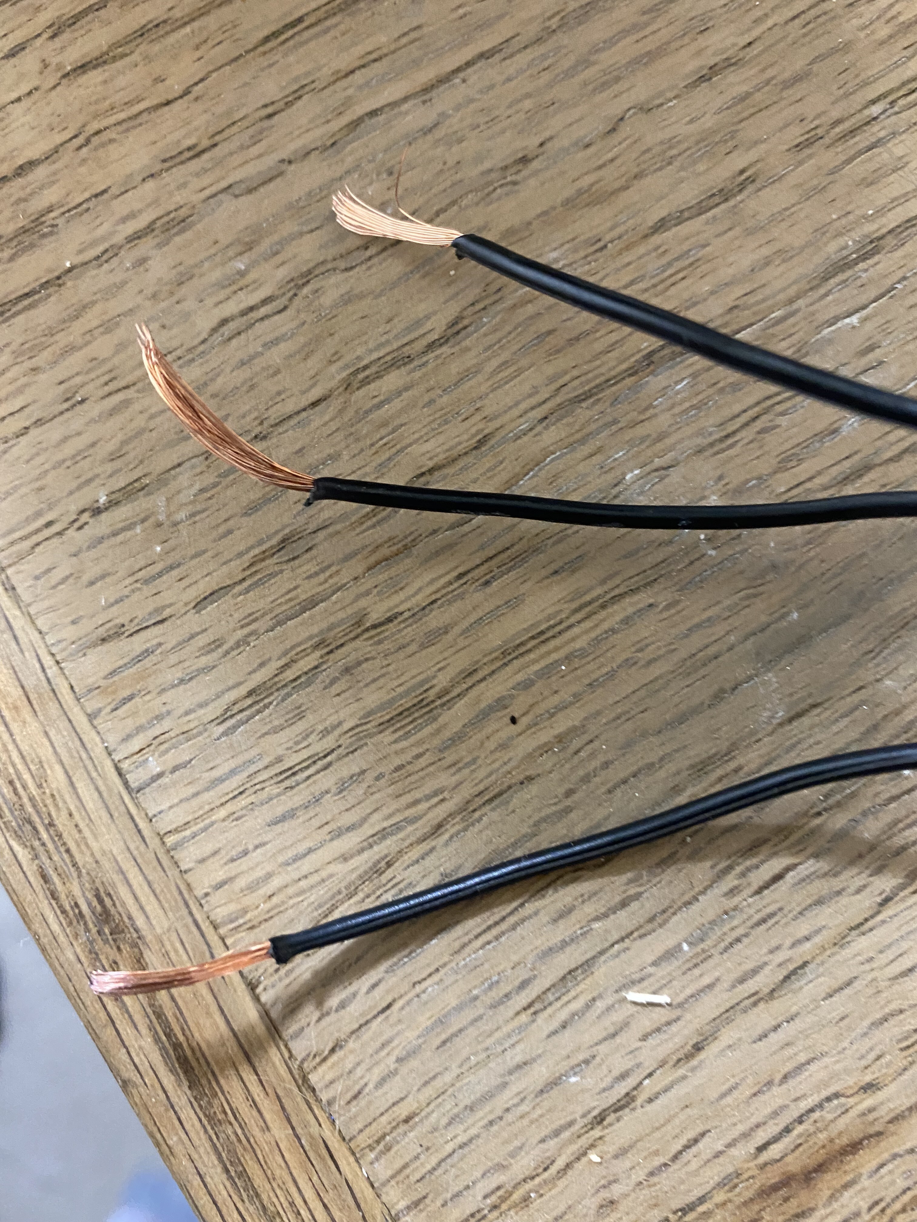

Okay. So the 5v power supply has 3 wires. I’m assuming, they are equivalent to red, black, and a ground on similar power supplies. When I tested the three wires, I get the following (I will use A, B, and C for simplicity):
A to B: 0V
A to C: -5.1V
B to C: 0V
Based on these results, I would assume I want to hook the C wire to the 5V input on the M2 Nano and probably the B wire to ground. Or is it correct to hook the A wire to ground?
These are all DC Volts by the way since I didn’t state it.

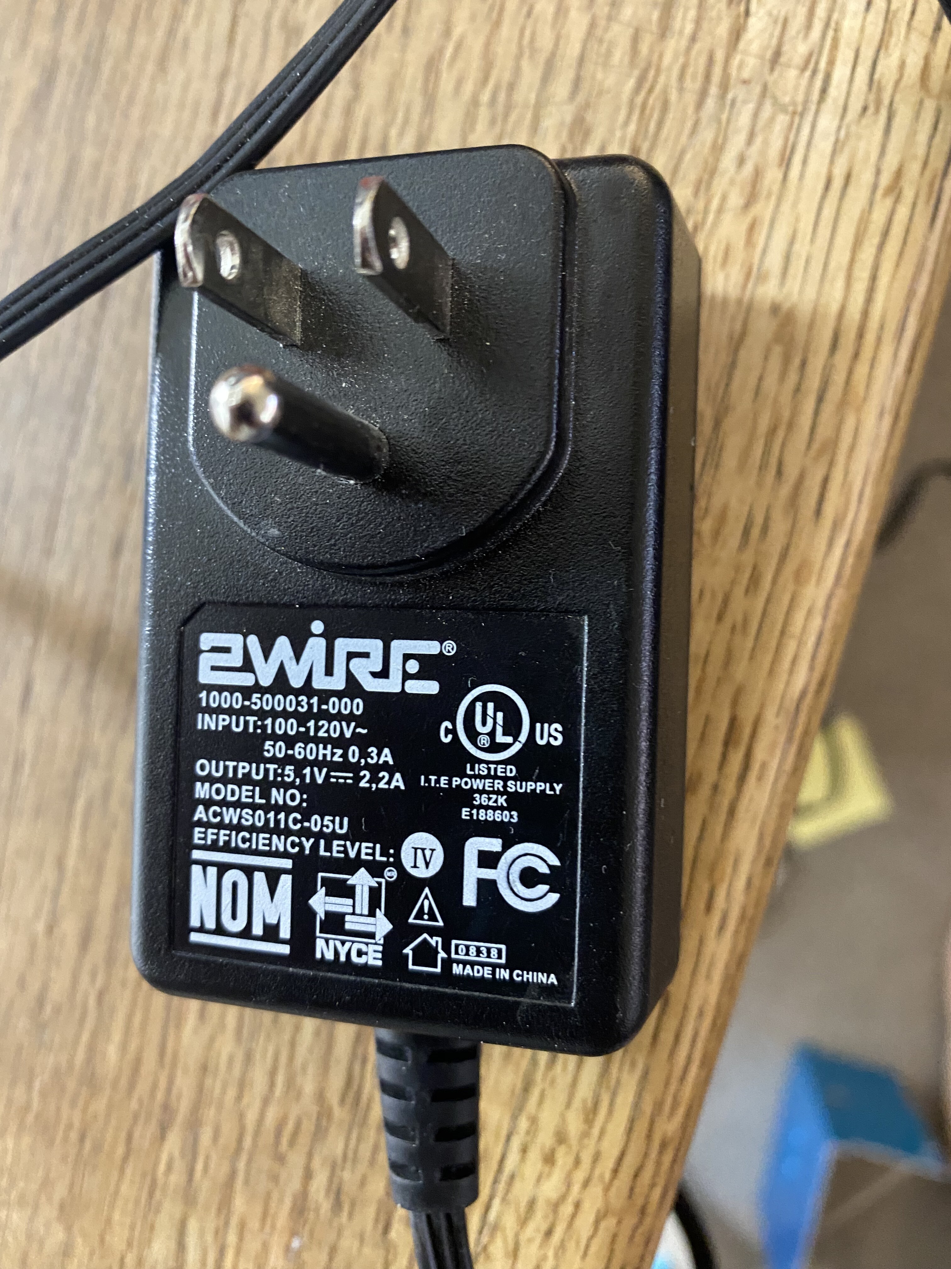

Can you post pictures of the supply one showing its label one other showing its wires and one showing the plug?
Not clear why that brick has 3 wires unless one of them is a safety ground?
Is it a 3 prong plug
What AC voltage are we working with?
Are you in US or other?
If this is a 3 prong connection we may want to verify which of A or B is connected to the ground spade in the connector.
We want the PS ground connected to the Nano’s ground and the safety ground connected to the frame.

Yes. 110V. In the US

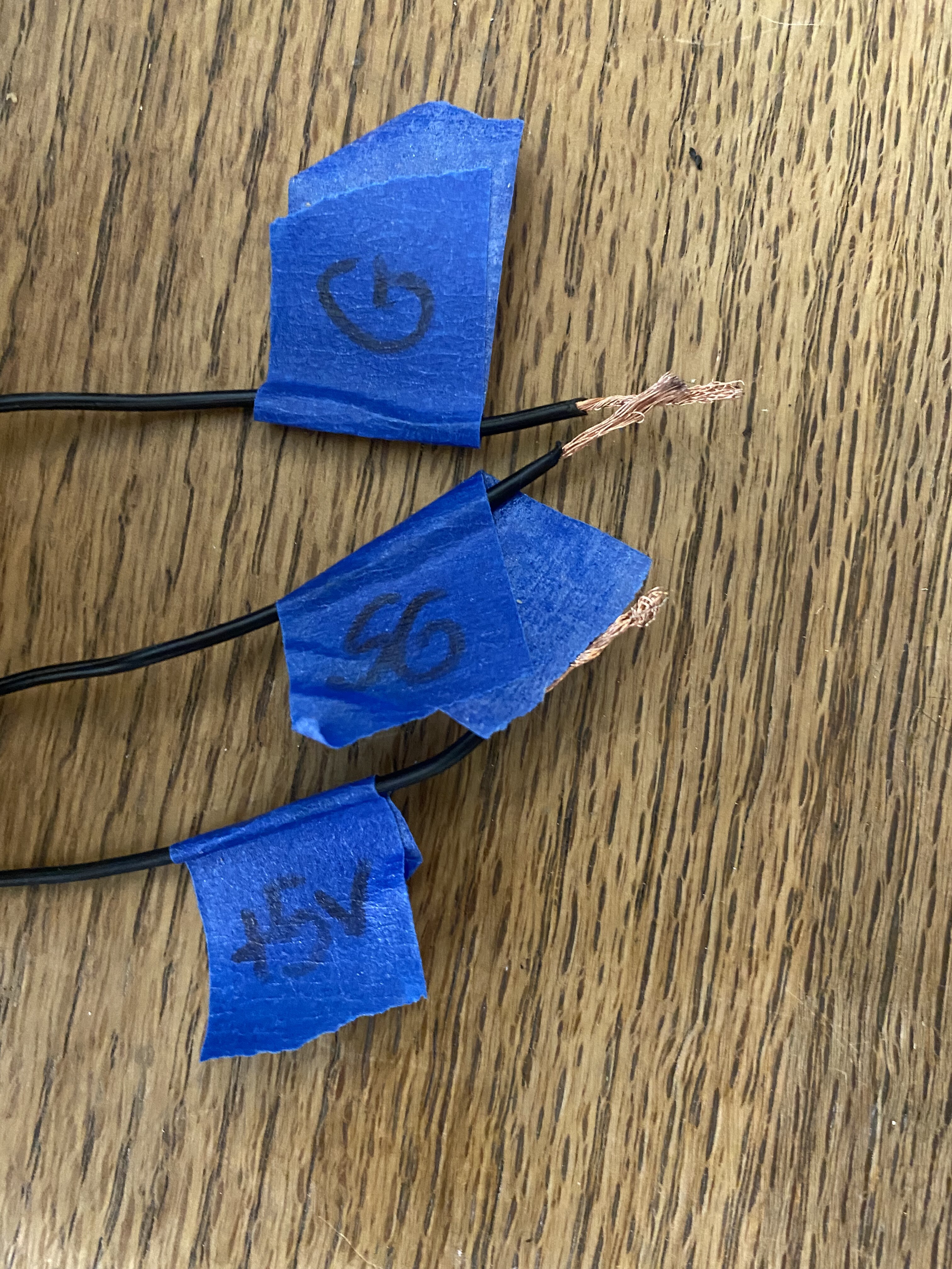

Okay I’ve identified and labeled the leads.

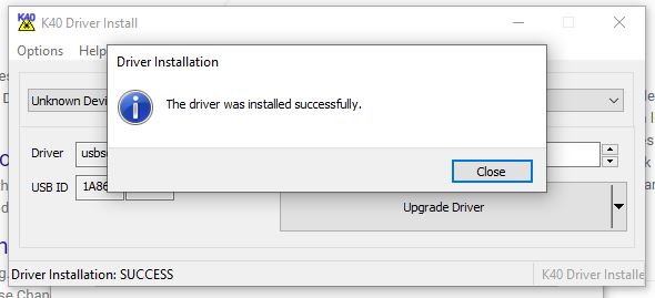

K40 Whisperer - Strange
Okay strange. Without changing anything else on my system, I was finally able to install K40 Whisperer drivers. Its nothing short of magic and I wish I could tell someone definitively how I did it in case they wander upon this forum looking for answers.
What did I miss, I thought we decided it was inadequate 5V power or a ba M2Nano.
