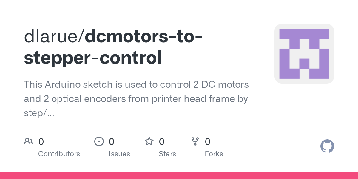

I don’t know if this is of interest to anyone but I saw a guy make a vertical cnc wall painter using old drill motors, custom optical encoders using tape strips and a bunch of custom software. It was a great hack but it felt like it might be more useful if all the existing software out there could be used to control this thing instead of the custom software and workflow. So I figured the machine would need something which could handle being commanded from standard buffer based cnc controllers which predominantly rely stepper motors and because this thing is big, and can be even bigger, large motors might be handy and geared motors even better so when unpowered the machine head won’t fall.
I ran across a project which hacked an old 2D printer in this way which relied on a few Arduino shields but felt direct control of the venerable L298N h-bridge might be better. So I hacked his code to use the L298N library.
The original project was forwarded to me by a friend and can be found here:
https://niklasroy.com/graffomat/
My repository for the Arduino Mega 2560 firmware is here:
Any feedback would be great.
This is now functional and soon I’ll post a link to a demo video but I’ll probably do another Fitzing drawing and reconfigure the demo so that it uses 2 L298N h-bridges. I’ve mentioned to a few friends what I was doing and they didn’t get it or its value until I explained how it scales to any size h-bridge and motor and their response was regarding the low 2A per channel of the L298N which is in the same ballpark as stepper motor drivers. By setting up a drawing with two L298Ns each configured for parallel operation( 4A capability ) it might make a better demo. I have powered automotive windshield wiper motors with an L298N in the 4A/parallel configuration in a high power servo project.
Another direction for this is to port it do another chip/board which has enough interrupts like maybe a Leonardo/32u4 or Teensy2 and a much smaller footprint than the large Mega2560 board.
