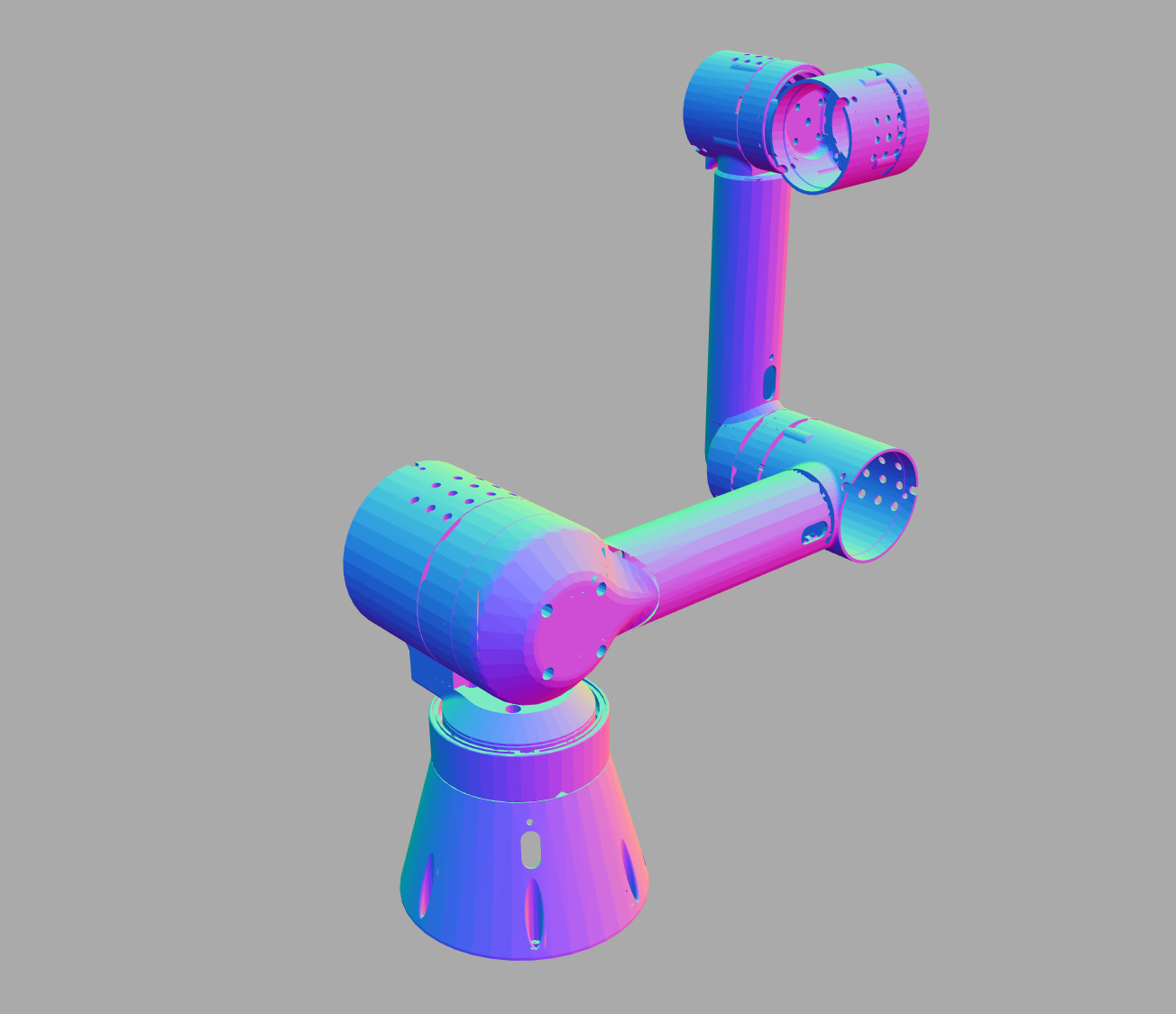

Hi folks, figured I’d post something perhaps interesting to the ChiliPeppr community. My goal with ChiliPeppr was to make an open source environment to let you control hardware. Early versions of that vision has worked with CNC control as well as programming IoT devices like ESP8226 and ESP32. One of the things I’m working on is a new workspace for controlling a 6 degrees-of-freedom 3D printed robot.
The idea is that the robot would have a workspace like TinyG or Grbl where you can see each of the 6 axes for the robot. Jog each axis much like CNC. The 3D viewer would show the robot like below:

Here’s the start of a new workspace. It’s kind of cool to checkout. You can rotate each actuator of the robot arm by clicking on it and then clicking on the rotate widget.

You can now click on a part of the robot and rotate it. The real robot arm then reflects the rotation. It’s like jogging from a 3D model.
