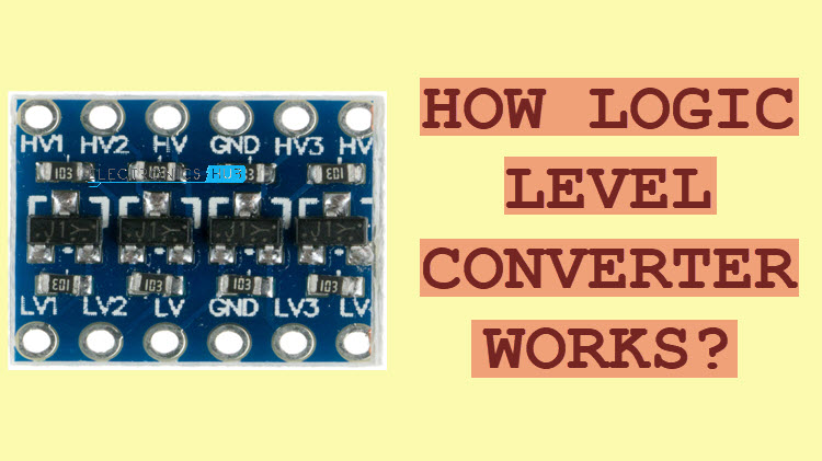

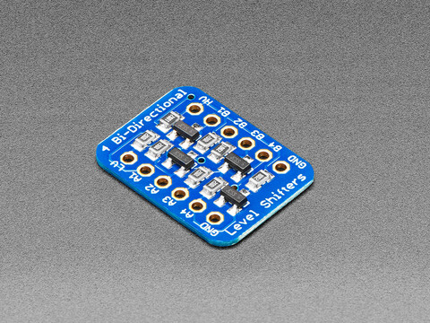

I would investigate these. I have used them for other purposes but understand they can be used to interface and level shift I2C:

Seems that the amazon 8 channel breakout is easier to implement than a bunch of discrete pullups :slight_smile:
