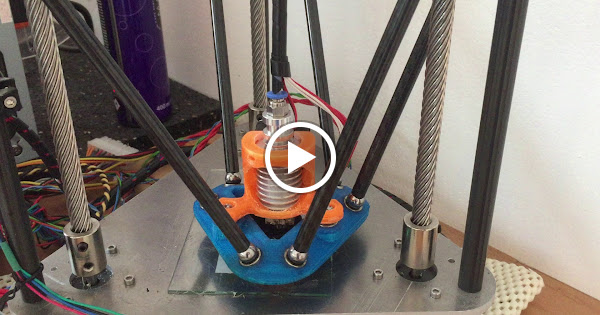

I have successfully used both with screw driven delta of different pitch:
