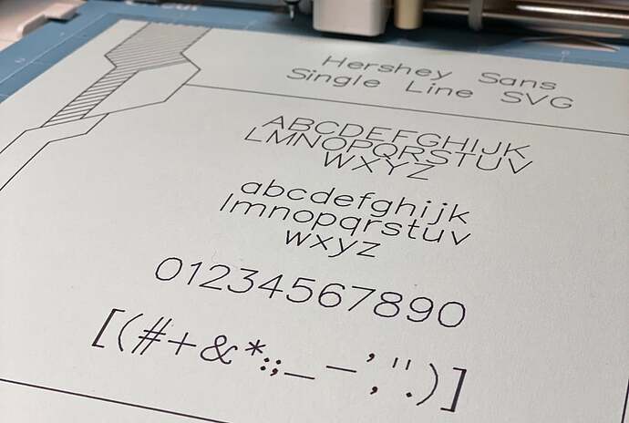

https://twitter.com/j0hnm4r5/status/1214764512454348800
Not a free font, but appears to be pay-what-you-want?
This font has only been tested as working in recent versions of Adobe Illustrator. You can give it a try in other programs, but it probably won’t work. It uses the relatively new OpenType-SVG color font format, so most applications will render the typeface incorrectly (or not at all).
