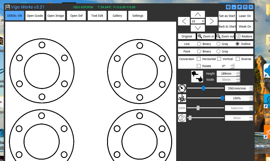

Hi all, I am struggling with my new Vigotech I won’t recognize DXF files, it will import them but VigoWorks says there is “no image present”. I have tried different flavors of Autodesk dxf, 2018 won’t work, 2012 imports then VigoWorks hangs, 2010 works but misses a section of the file. See pictures. I read a thread here that detailed a way of making the VG L7X work with Lightburn by downgrading the firmware but I can no longer find the thread. Was I dreaming or is this possible?

I’ve only had the VG LX7 for a short time. Neither DXF nor G-Code imports will work properly even with the latest version of Vigoworks. Flashing new firmware was frought with frustration, and now I’m back with Vigoworks and the original firmware. While flashing the firmware XLoader did not seem to complete the process for a couple of hours, so I interrrupted it, and when I turned everything back on it was all fine.
