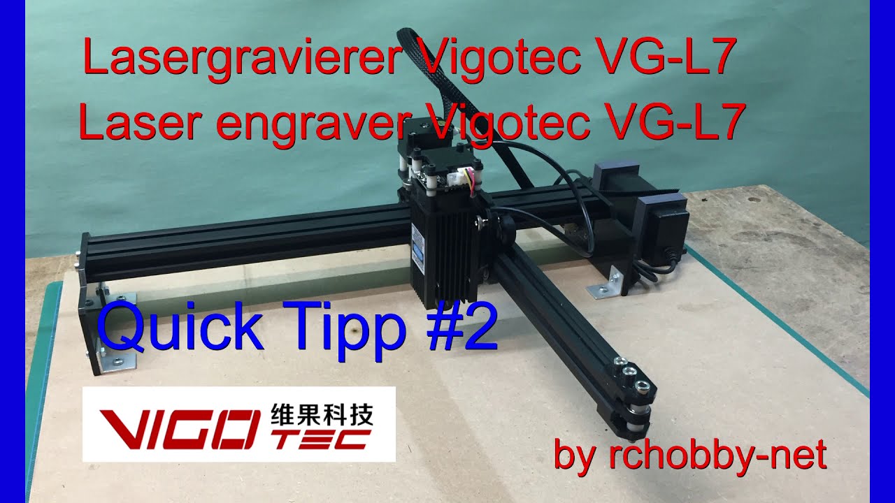

HI, wood again - I also have the vigotec LX7 (without Wifi) and have written Vigotec VG-L7 BX20 image sizing/ printable area
to tell about switching to Grbl - worked fine, except use of fan (which is always on).
Either I was very lucky or nobody tried to ‘just upload’ GRBL by using the China-Software.
In the meantime i have been working with laserGRBL for a few weeks without any problems. At the moment I’m working on Lightburn (with GRBL) on the Vigotec VG-7. That seems to work fine too.
