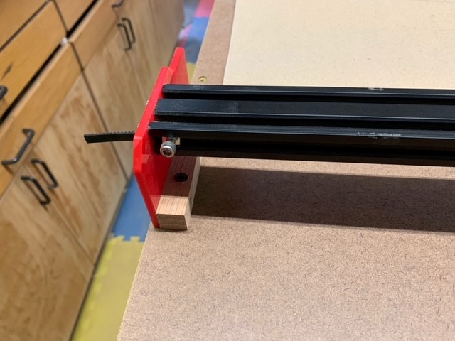

Here is a little more detail on the modification I made. I have tried to attach photos but can’t tell if the attachment worked.
I purchased two Items from Banggood:
Machifit 100-1000mm black 2040 v-slot aluminum profile extrusion frame for cnc tool diy Sale - Banggood.com
5m 2gt-6mm pu open timing belt s2m gt2 belt for 3d printer Sale - Banggood.com
I removed the belt clamp screws on the Y axis bar, removed the Y-axis bar and then replaced it with the 1000mm bar I purchased. It was necessary to tap the holes in the end of the bar to match the threaded holes in the original bar. I installed a longer belt and threaded it through the stepper motor the same way the original was threaded. I secured the belt using the clamp screws at the end of the bar.
I also removed the circuit card from the end bracket and fashioned a standoff bracket that could be attached to the stepper motor trolley. In this way, I was able to avoid extending any cables.
I am sure there are other ways you expand the envelope. I only needed to make longer parts so was it was not necessary to address the X-axis.
Hopefully, are present and they help.
Here are the photos
Bar End View Stepper Trolly Over all View
Good Luck.
