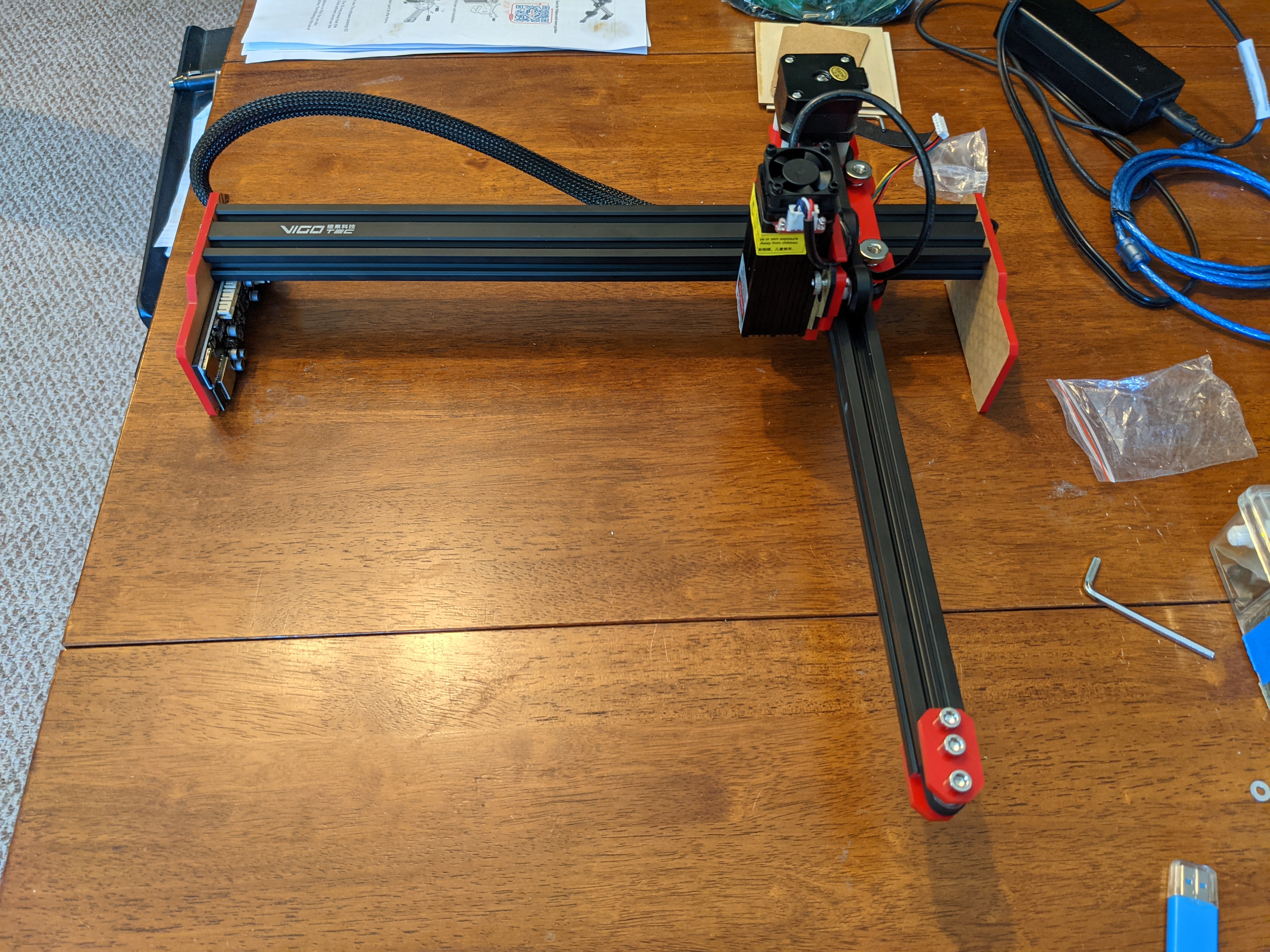

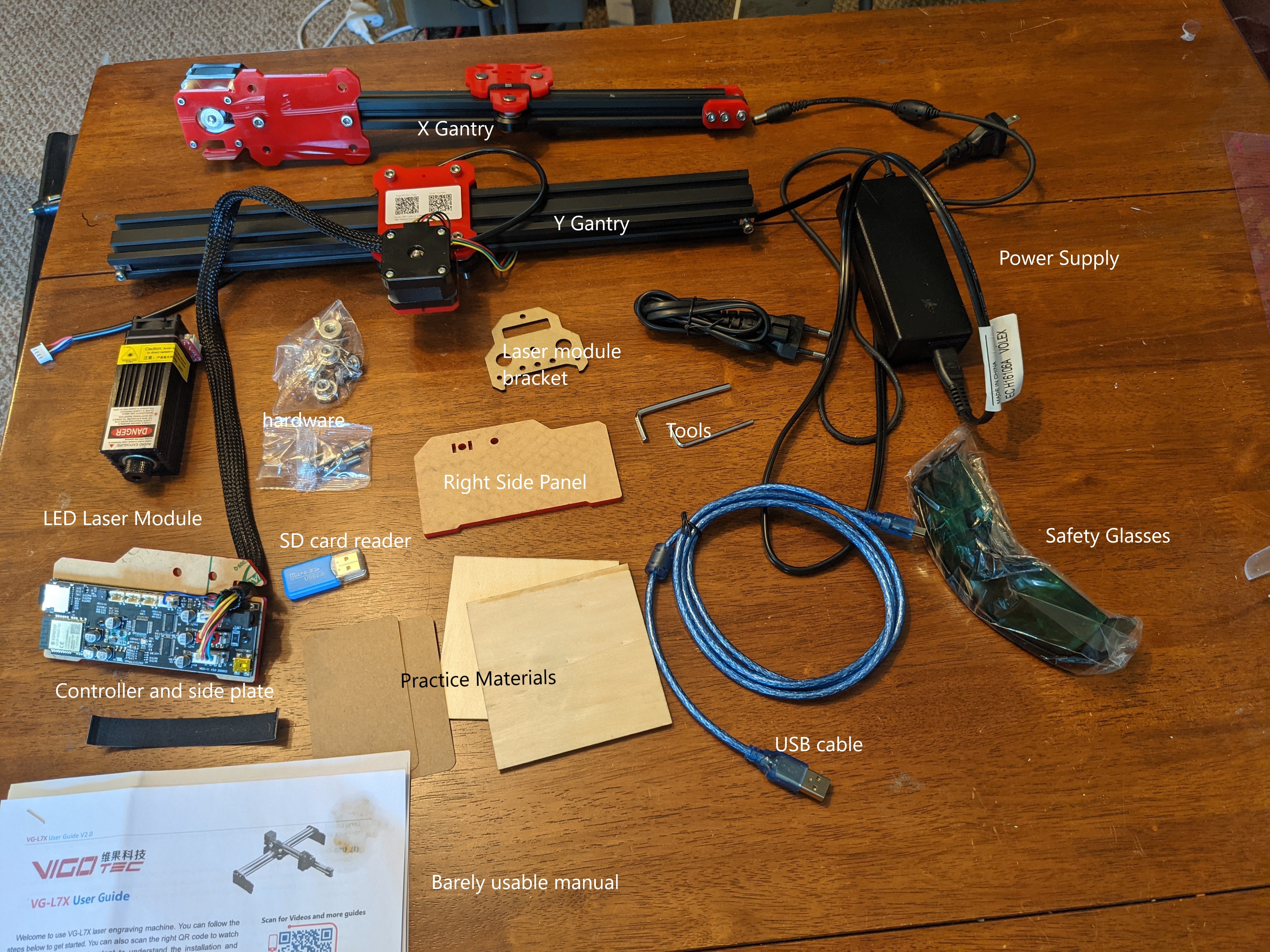

As I previously posted I bought a VG-L7X laser unit and started the project.
I have started the investigation and learning part of this journey.
I was impressed with how simple and small this thing is. We will see how well it actually works, the Bangood video ad was impressive. I can see that at double the power and the right add ons this could be a player for many shops.
General impressions:
  • The unit is attractively simple, Nice not to have HV, water, pump, coolant etc…
  • Comes with the essentials to get started
  • Do to preassembly, build time, <10min
The unit looks well built:
  • Keyed connectors on controller, steppers, laser.
  • Aluminum Extrusions
  • Protected cable harness & management
  • Solid controller mounting with integrated control panel buttons
  • Good gantry mounting, wheels, and bearings
  • Properly sized hardware
The missing [I plan to provide these]:
  • Replacement parts list
  • Schematics for controller
  • Wiring diagrams
  • Source code
  • Fume extraction
  • Air assist
  • Enclosure & safety interlocks
  • Focus adjustment
  • Mechanical CAD drawings
  • Laser temperature protection
  • Laser alignment instructions. The slop in the side plates and laser mounting allows the laser module to be tilted.
