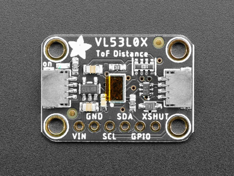

I have to connect four Vl53L0X with an Arduino Uno and read from all the sensors the corresponding measured data. All this is supposed to be done via an I2C bus. This is my previous code:

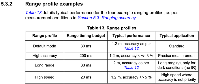

I wouldn’t expect it to measure 200 inches, since the datasheet says up to 2 meters, so about 78 inches at the most.

The demo shows checking status, and rejecting out-of-range, which with their library is indicated by .RangeStatus == 4
Looks like you are using a different library but it needs to have the same information. Go ahead and provide a link.

Do read the datasheet, because there are different ranges, and you have to configure it for the sensitivity and range you want if it’s not the default. (I’ve never used these components myself, just glanced through the datasheet after you posted.)

Looks like their examples don’t check for errors, unlike the Adafruit one. I’m afraid that this means reading code to find out how to check for errors with that library. The library you linked to says in the readme that it follows the user manual that I linked to, so you’ll really want to read both.
Maybe timeoutOccurred will help?
