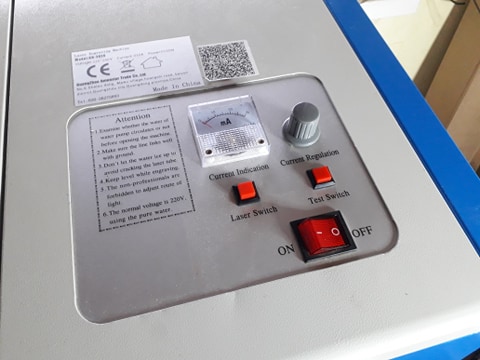

  • Your control panel

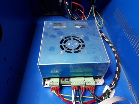

  • The connectors on your LPS

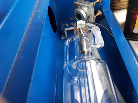

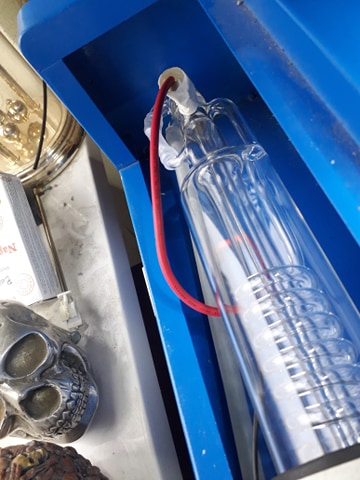

  • The laser tube compartment showing both anode and cathode connections

laser 3
Laser 1
laser 2
laser 4
Sorry, it will only let me upload one at a time.

Since the LPS power light is on and the test button on the supply does not fire the laser it is likely that the supply is bad somehow.
Sounds like a replacement is necessary.
