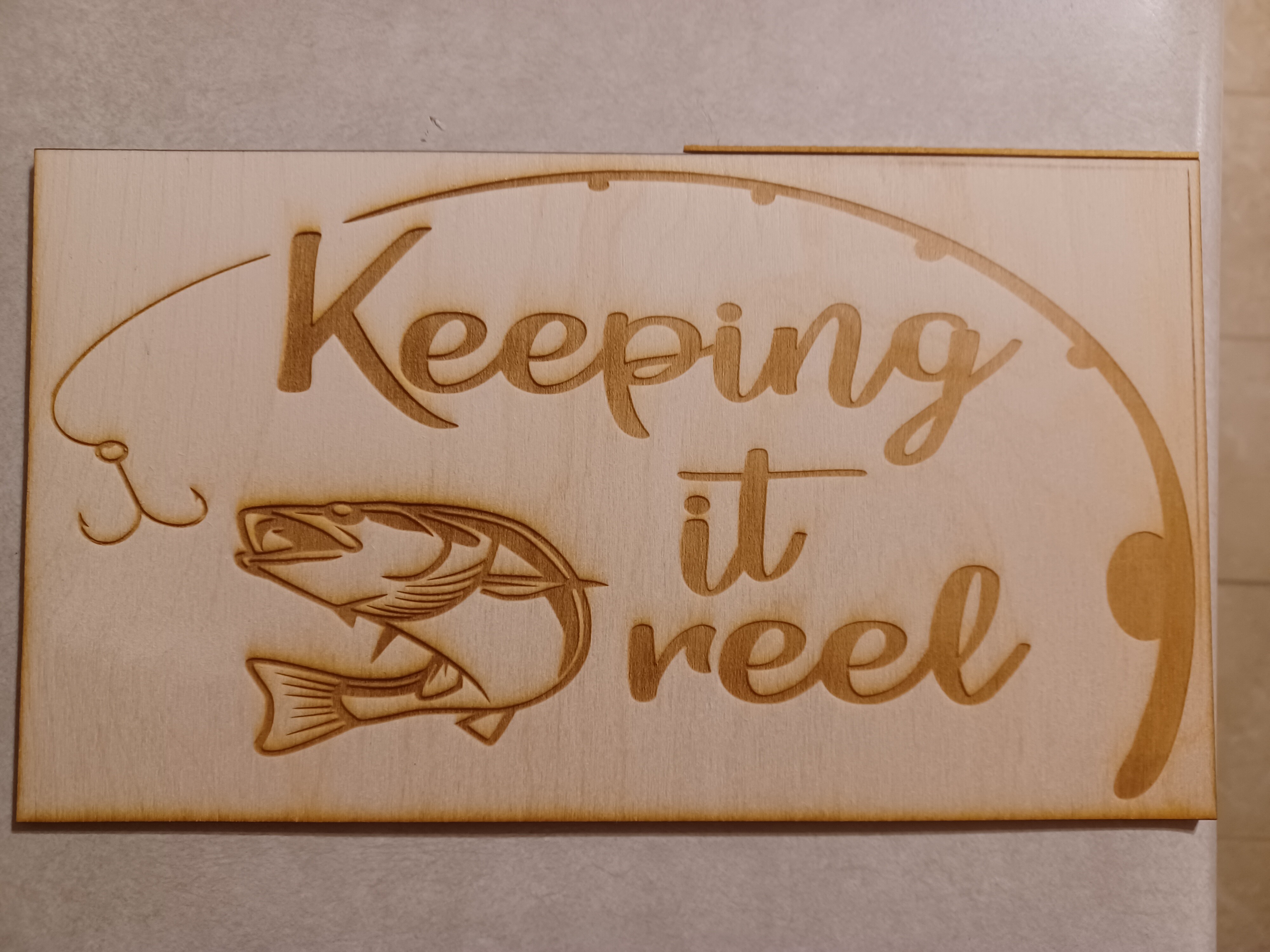

My K40 is cutting poorly on the right most side of the table. It is also burning a line beside a cut made down the far right side. Is this maybe from a weak tube or more likely a mirror alighnment issue or something else?
Varying based on location is definitely mirror alignment.
We have some alignment resources in the “K40 Intro” pages linked at the top of the page.
