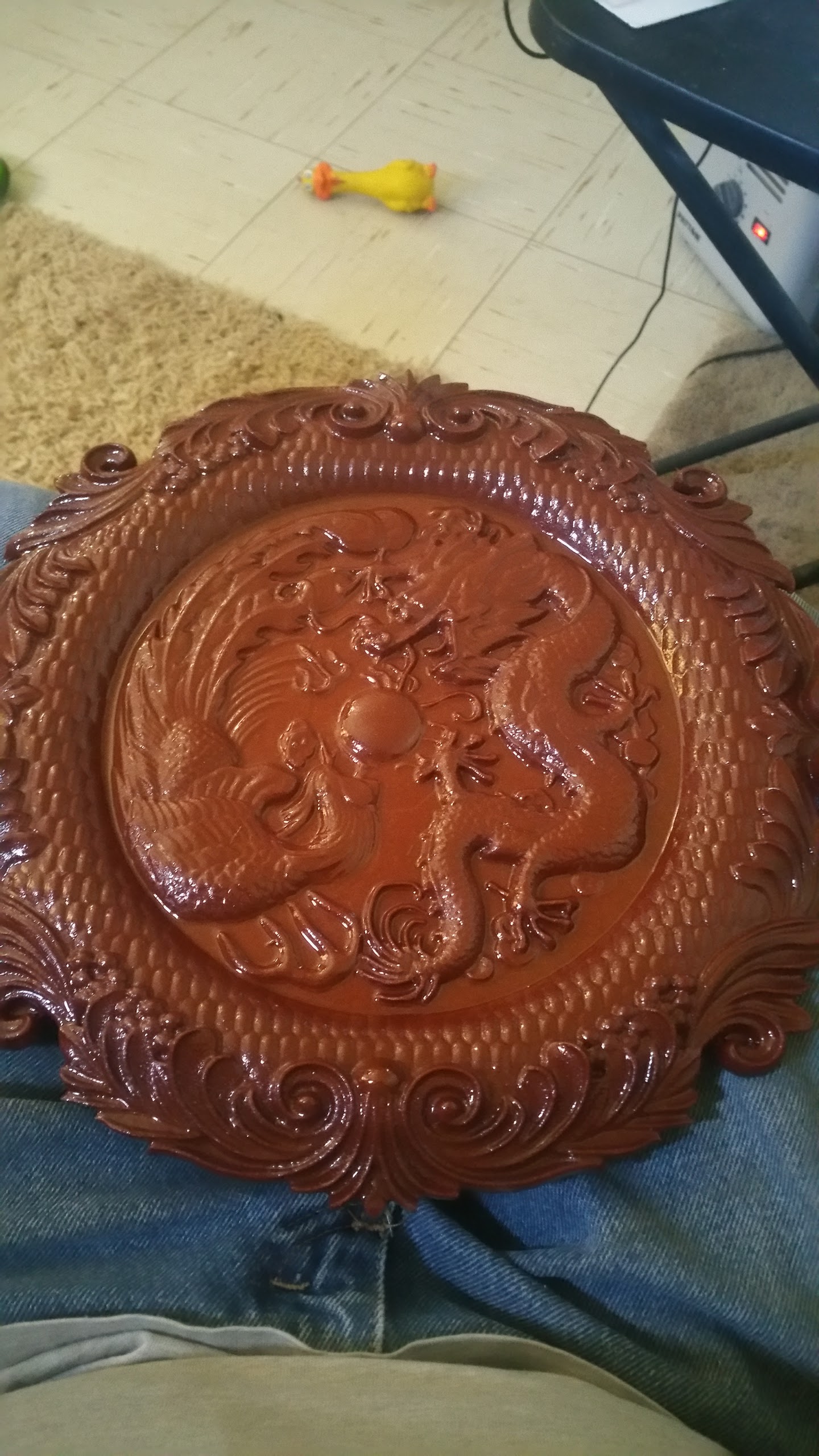

Well I finished the mdf asian piece. MDF sucks up stain and varnish like a sponge. I bought some sanding sealer to see if that helps. This one took 4 coats of stain/varnish and 7 coats of clear varnish to get the desired sheen. I also have come to the realization that dust collection is a must as the fine dust mad it into the clear coat from the other room of my shop so I picked up a harbor freight dust collector and will be making a collector shoe for the machine. does anyone have an stl for a shoe that splits to allow tool changes. If not I will post details on what I come up with.
Ammmmazing. One day might need you to teach me your ninja CNCing skills!

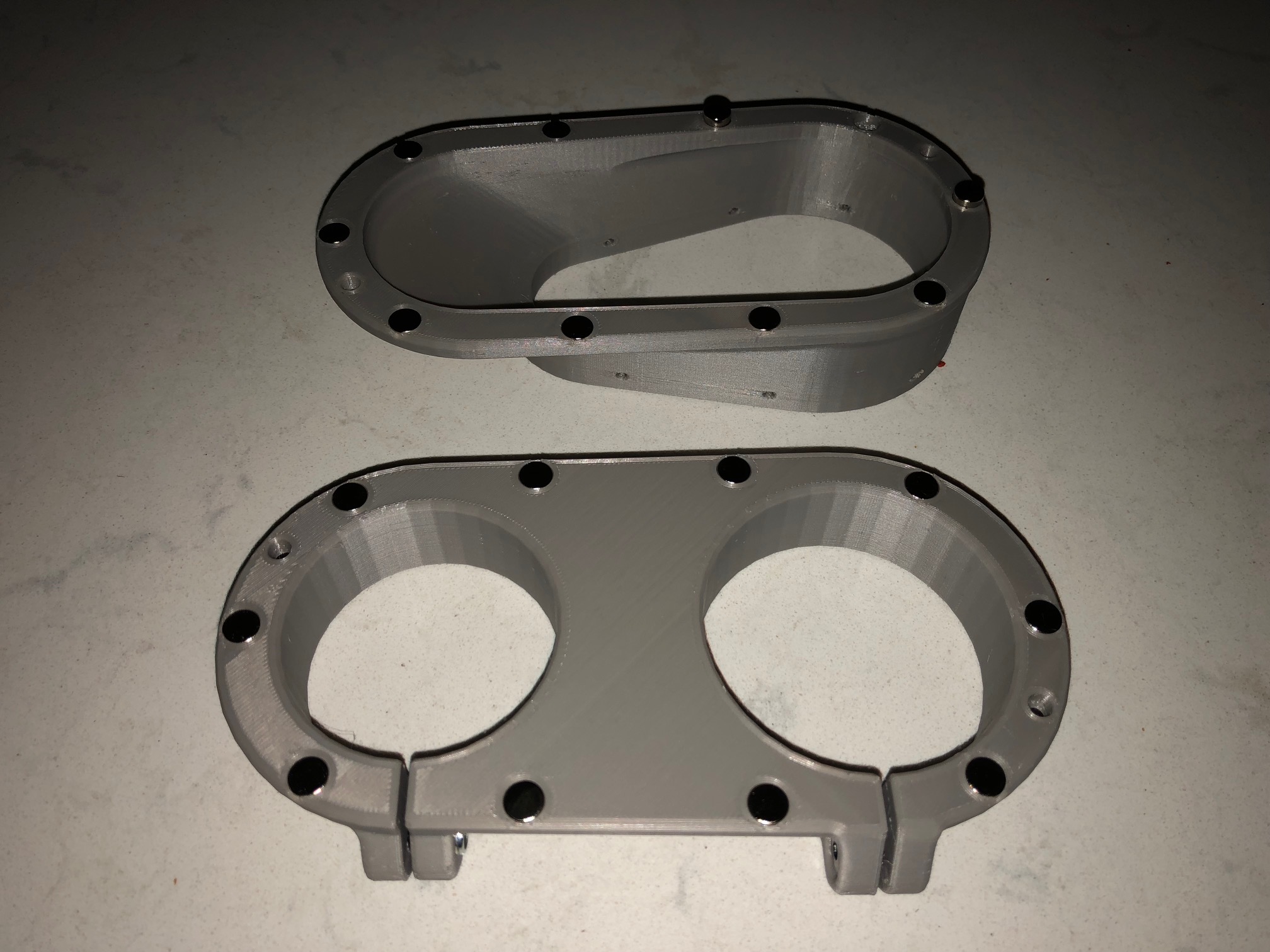

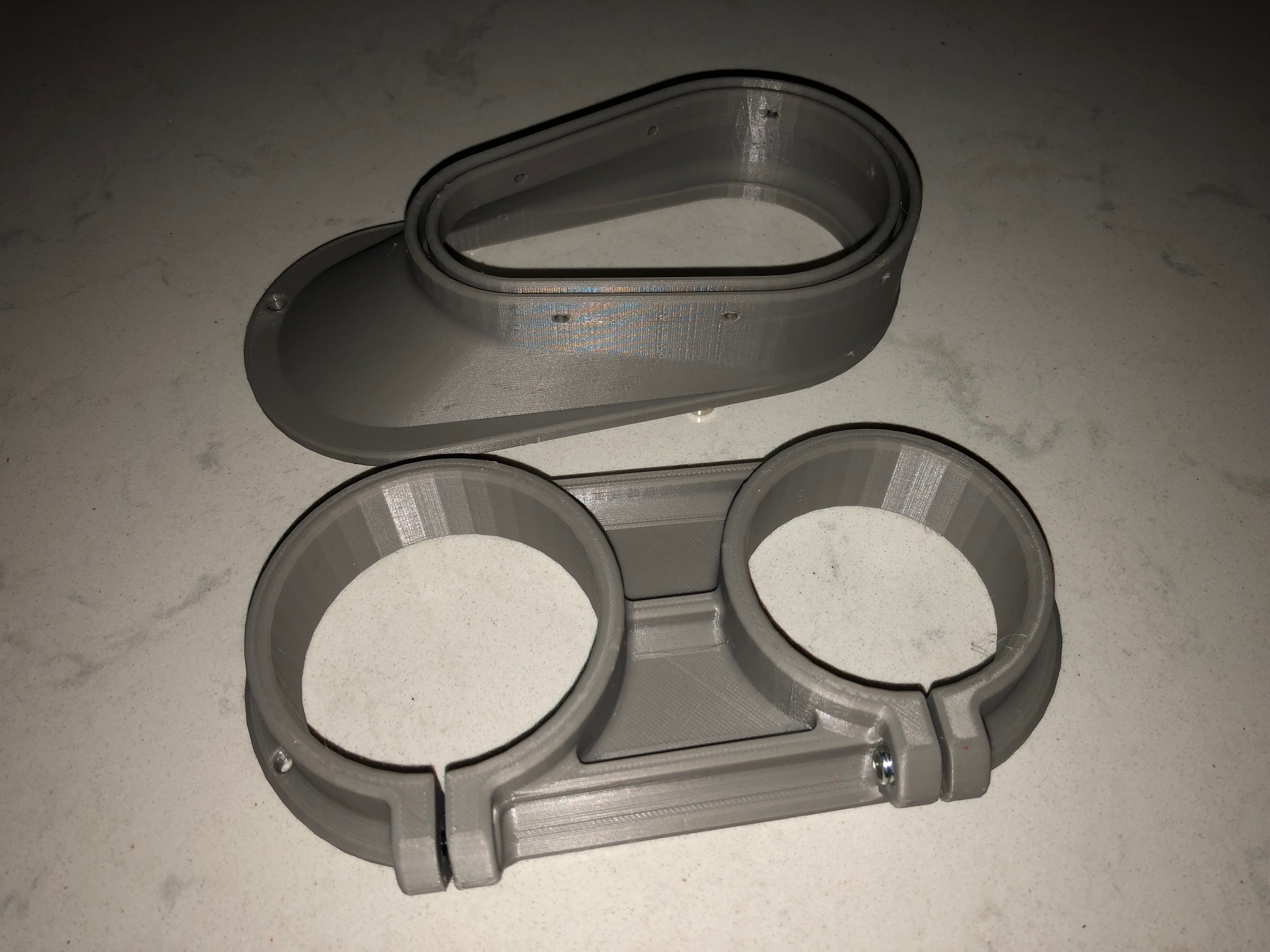

I have one printed now, but it’s a little large for my dust collection (but it might fit yours great).
I’d be happy to print and send you the upper and lower for $20 (my cost and assuming you are in the US). It’s printed in silver PETG. You would need to add magnets, (2) M5 nuts and bolts, and a skirt.
My only problem is it makes you mount your spindle lower. That and the size of the dust extraction (for me). I have a design in my head that will allow mounting on how your (and my) spindle is mounted.
But it might be a bit before I get around to it (probably January…).
I’ll post pics of it if you want. It looks really sharp in the silver PETG.

Anyway, 65mm spindle confirmed (it fits on mine). The dust port is 2.25". The magnets are lightly pressed in, they need to pop out and then glue in. To keep you from ordering the 8x3mm magnets, I can send them on.
$25 to jebc (at) (the letter “c”) (the number “4”) http://solutions.net – jebc@c4sol… Paypal
(assuming the dust size works for you and you want the magnets, nuts, and bolts)
You would need to add a skirt and the dowel shear pins.

Also you will have to mount your spindle lower… The backside of the spindle shoe will not clear the cbeam or end plate (maybe an inch to 1.5 inches lower).

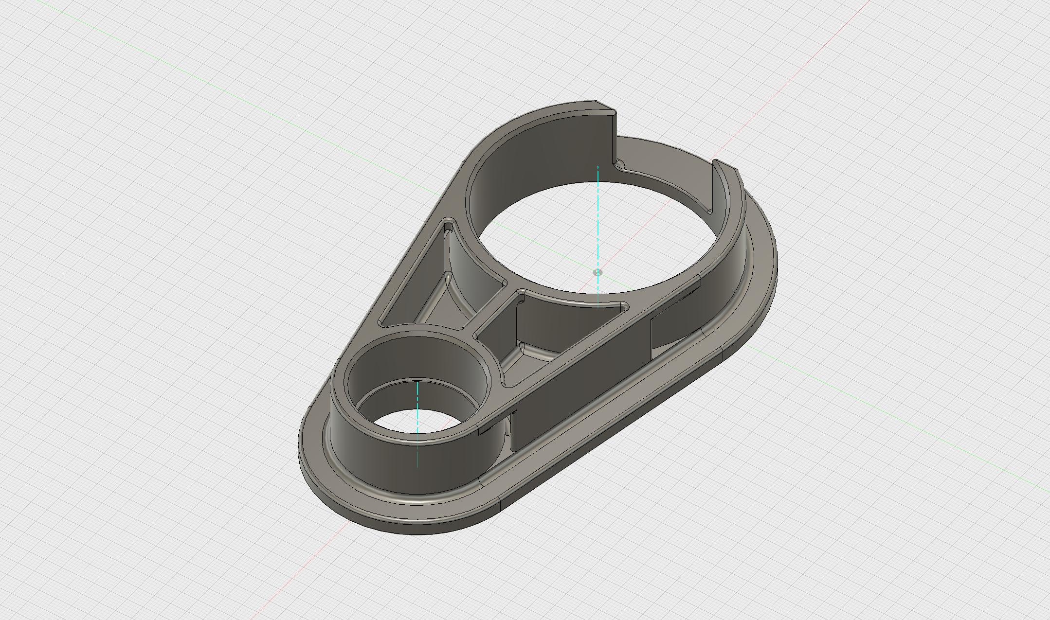

If that’s a problem, please see my next reply with screenshot of a parametric dust shoe that I’m working on that will minimize that.
(I haven’t put the final 2mm gaps in, but it will use band clamps).
Fully parametric dust shoe (notice the 2 sizes in the dust port since I have 2 smaller dust vacs).
The back is cut to allow it to ride much higher on the spindle, then a band clamp to secure it.
@Jeb_Campbell Looking Great. Yeah, my design works on my CNC… but I also have the printed spindle mount that makes that possible. Brandon’s aluminum mount is so compact… he didn’t give me much room to work with making that work with my shoe. Looks like you might have found a great solution.

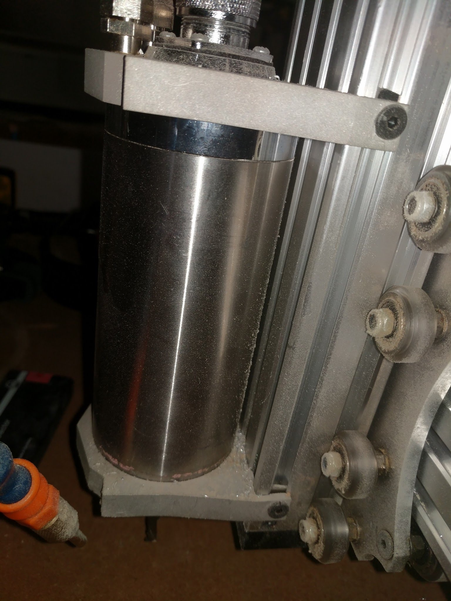

@Ben_Delarre do you have the short or long spindle clamps? You came on early, can’t recall.
@Brandon_Satterfield not sure… Here’s a pic
Short.
