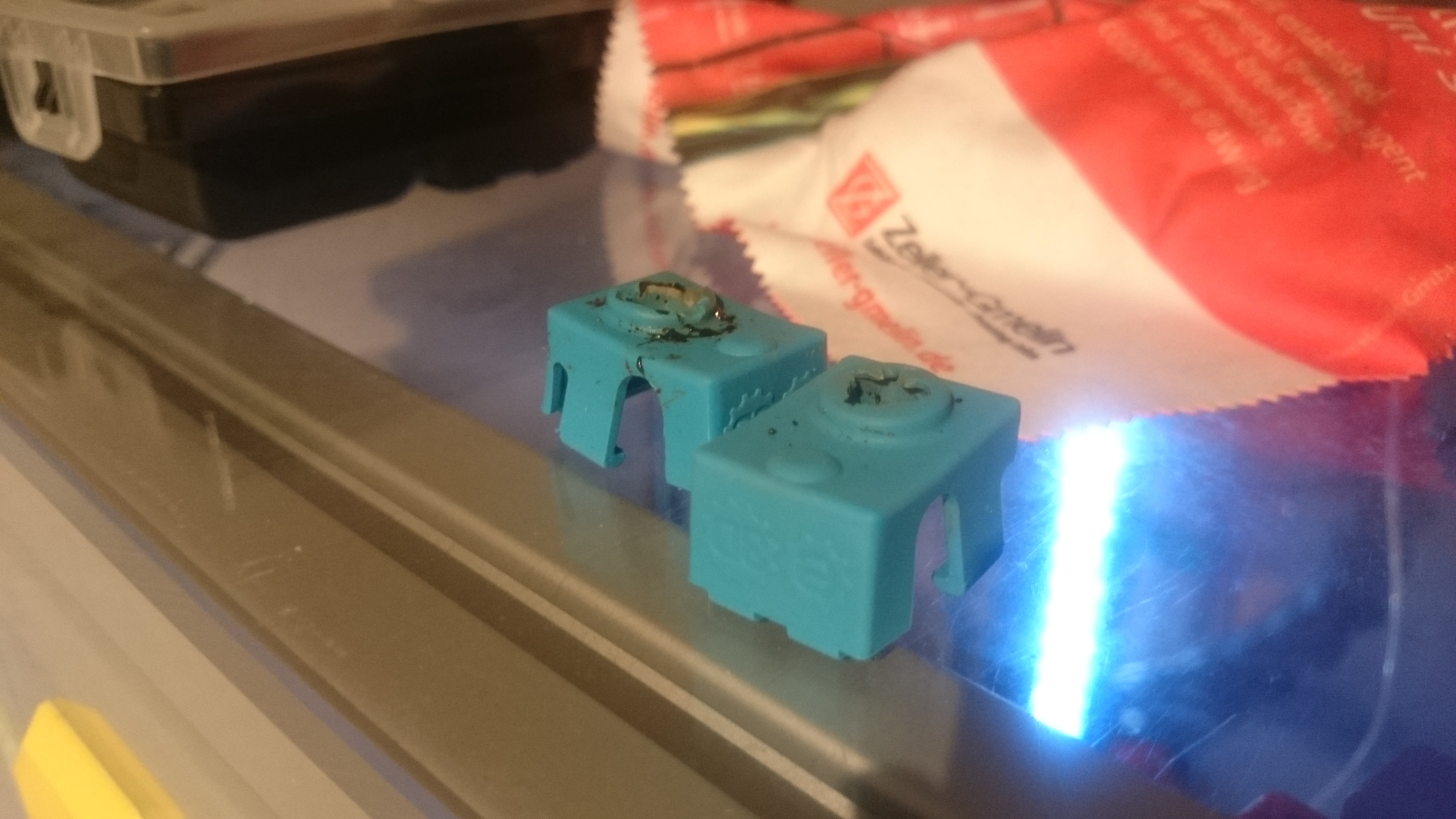

Well youll need to improve them e3d.
Well youll need to improve them e3d. They come lose on one side and bits over the nozzle get torn down. With the heatercables sticking out I cant really fix them (and that would not be the purpose).

@Jeremiah_Coley yes i had that post and naw gave it up when I saw these. Dont know why they fail. They do improve printing well actually. They are in use for about four weeks or so.

I have one on my lulzbot mini, and I had to cut it up for the endstop wire. It barely hangs on, and almost falls off during the cleaning routine. Now I realize that the modifications I made are mostly at fault, but it was pretty flimsy and loose to start with.

It’s having some adverse affects on my Kossel Mini. In practice so little of the nozzle protrudes (basically none of it) that the sock/boot rubs on the layer being printed, slightly. This isn’t helped by the tabs being, I suspect, ever so slightly too long so that the sock hangs down very, very slightly.
So I’m finding that the top layers of a small (say 15mm diameter) shape aren’t dragging over the fill properly – the sock causes the hot filament to instead work its way into the fill honeycomb – it needs about five top layers to sort itself out – which is about three more than without the sock.
I’ve made the nozzle-hole larger, so more of the nozzle protrudes and I’ll see if that fixes it.
I really want this to work as it’ll stop bits of carbon dropping onto my print jobs, which can be very annoying!
