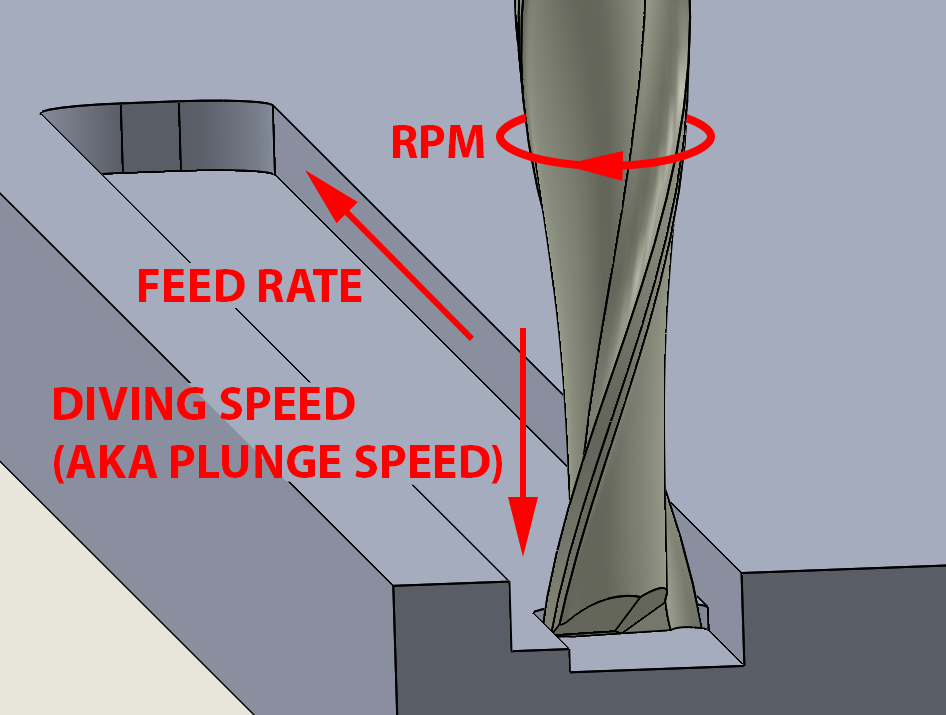

Fig. 1

Depth of cut: See figure one. On a milling machine this is how far the end mill goes into the workpiece in the vertical direction per pass. CNC operations will have the end mill enter the work piece to the specified depth then start moving horizontally at the feed rate (less we are ramping). Most end mills we purchase for our DIY CNC machines are center cutting, we won’t dive into that here, meaning they will dive into a material without issue. A large depth of cut should be reserved for larger diameter tools and visa versa for small tools. I.e. you can take a full millimeter depth of cut with a 4mm end mill but you certainly would not make it anywhere with a 1mm end mill trying to cut a 1mm depth slot, meaning depth of cut and diameter are related.
Diving speed: Diving into your material has a specific feed rate as well, we know… more unknowns to fill in. The feed rate here we have found is not as important, why? Well as stated most end mills will dive without issue even at improper feed rates. Too slow and no harm done, on metals you may chatter, next operation speed this up. Too fast and you may not know it till it is too late. We will typically use 10% of feed rate if we are in a situation we must guess and 50% in soft materials like wood. Depth of cut is where cutting speed and feed rate come together are can be related to chip load.
