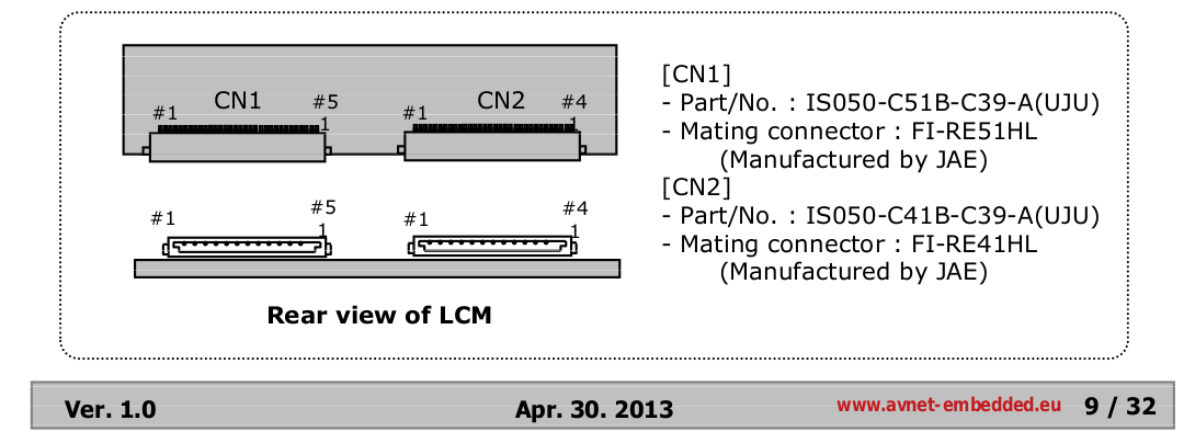

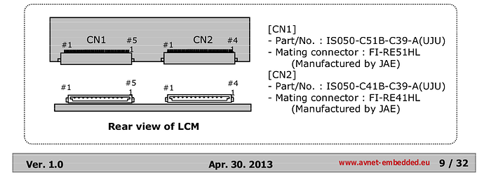

The part is listed as LM270WQ1-SLC2, so a search for LM270WQ1-SLC2 datasheet as several hits; looking at the first makes it clear that it uses two connectors for signalling:
That gives you more search terms: S050-C51B-C39-A(UJU) FI-RE51HL IS050-C41B-C39-A(UJU) FI-RE41HL

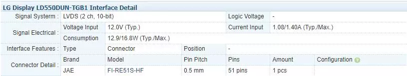

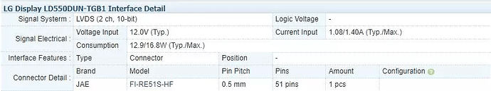

The second panel has more information called out:
But you would still want to look for the datasheet and read through it.
