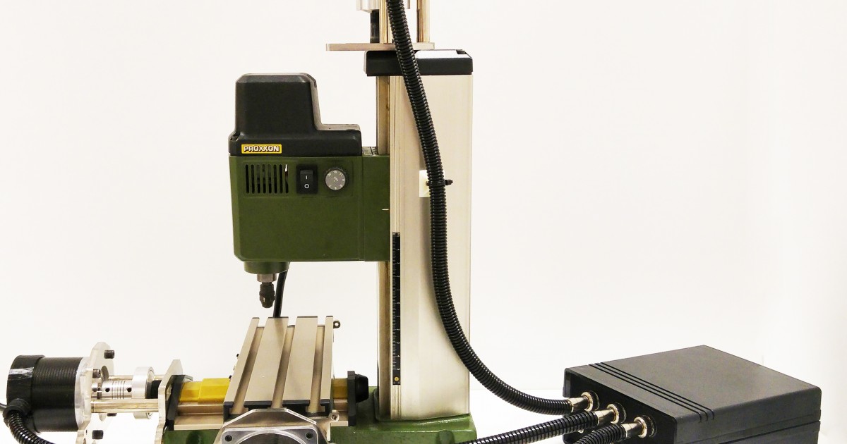

Or, a better idea, you buy something someone else made. For example:
I wrote lots of advice on all the things you would need to do, and then discovered this kit:
That uses an 8-bit arduino-based Synthetos gshield (see g2core and TinyG) controller instead of the Smoothieboard, but it shows what components are there. The Smoothieboard is a good idea; 32-bit processors are better for cutting arcs. The kit is basically adapters like the amazon link, three stepper motors, electronics, and a housing.
Here’s another writeup:
The instructables author purchased from mbbilici. I don’t see a MF70 kit on his site, but I have purchased from him before and recommend his work, and he has responded to email. You could ask.
