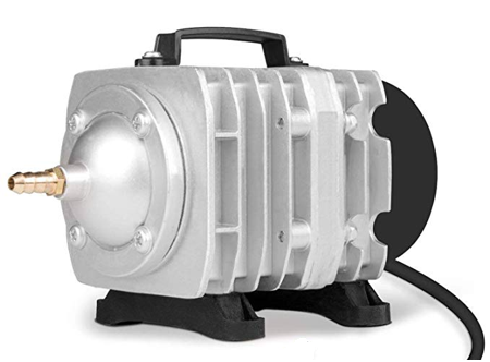

There is strong agreement among experienced K40 owners that the first addition you need (beyond the minimal requirements for safety) is air assist. This is a jet of air blown right at the focus point. Air assist does at least a couple of good things. One is to forcefully clear away smoke and globules of debris from the cutting/engraving spot and make better cuts. Another is to actually blow out tiny flames at the focus spot, reducing fire risk.
Air assist is usually done by buying a biggish-capability aquarium air pump ($30-$100) to supply the air, and then routing a tube along the X-Y framing to the moving head so it can blow through either an after-market focus cone on the moving head, or a metal tube aimed at the focus spot. The picture shows one of the common of this type pump. This particular one is on Amazon for US$39 at the time of writing. Even smaller US$10-US$20 pumps are thought to be an advantage. You can go deluxe with the Zeny airbrush compressor with the small air tank for about US$70, and get into airbrushing at the same time.
The air from the pump is conveyed to the laser cutting head through a plastic tube which needs to end at the cutting head, and there is some mechanical work involved in getting the air tube to follow the head without impeding its motion while cutting.
