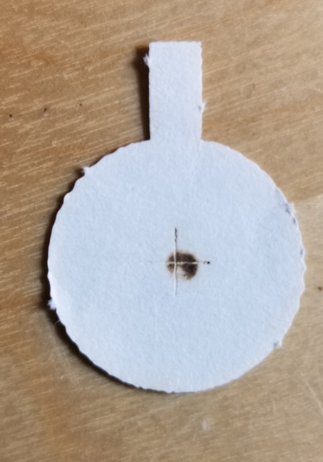

I have a China Blue (50W) but the tube only put out 44W and was 880mm in length. I have the replacement in my room here, it’s a cr type.
The original tube is going south. It’s drifting out of TEM0 mode… and it was centered…

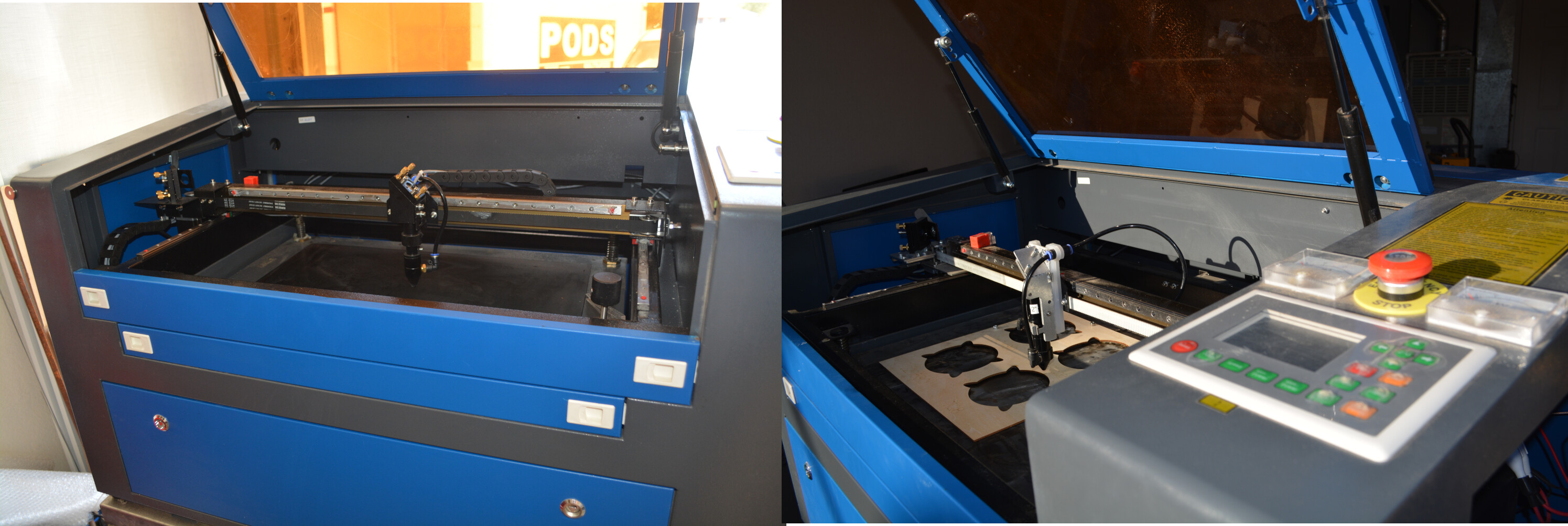

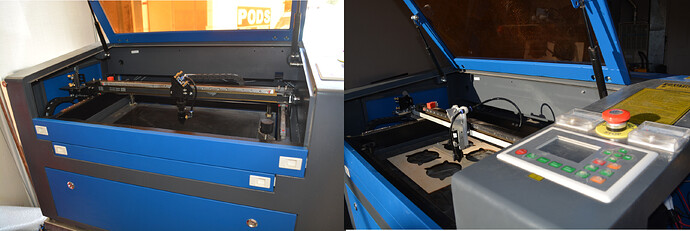

I guess it’s been a couple of years since I got mine… I got it to learn how they operate, so I’ve made a few mods to mine.
I just ordered my new laser from Cloud ray, arriving on Feb 6.
Watch this Sadler video and it will answer your questions about where to purchase and educate you on B grade tubes that are commonly sold to us…
Here is my machine… pretty much how it came (minus the honeycomb) and what looks like now.

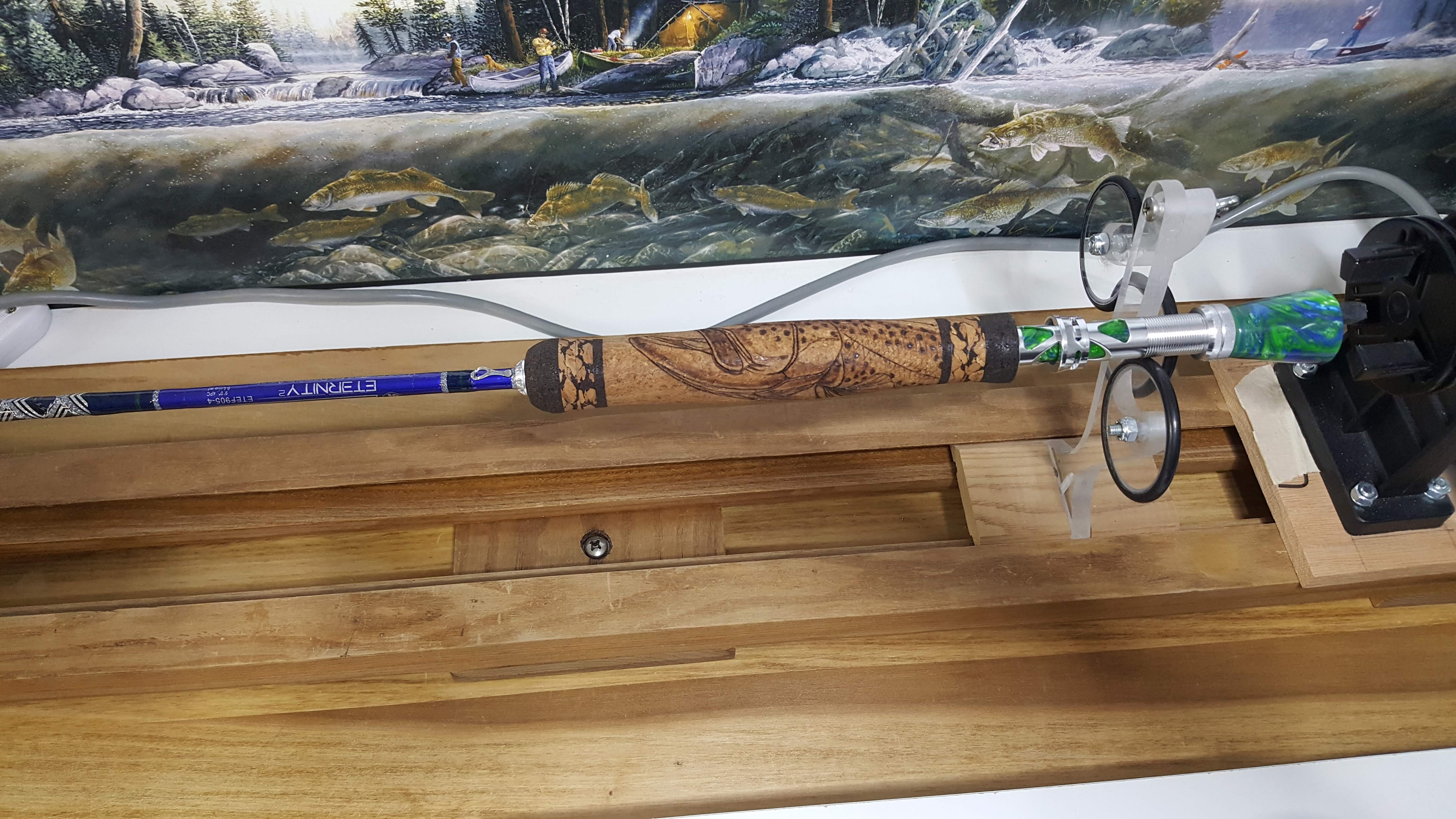

Very interesting video and like what Russ has to say…makes sense! All I’m going to do is engrave Cork and acrylic, no cutting. I use my band saw and wood lathe to cut. But still feel the Better quality tube will improve the engraving quality as I have heard .could be wrong . Just curious what modifications did you make to your existing machine? Looks like the control panel and mirror hardware and laser Head? What do you hope to get in your new laser, more wattage and cutting capability?
Thanks for information and kind comments! I make my own custom Cork-acrylic grips but have a artist to do graphics on cork. Just like everything else , his costs have doubled and so for me to have him complete art work has increased from $250 to $385 with shipping per grip which many of my clients will now not consider so I’m going to create my own art work with a laser, sure not as good but most fisherman just want an interesting grip to look at while fishing is slow. The K40 has been a major investment for me as I’ve had to upgrade power and add vent system on my wood shop plus all the K40 costs but in the end it’s going to be worth it and I have an interest in laser engraving.
Russ Amato
Sweet rods!!!
Not going to cut… ?
Seems like the perfect pair, inlays. Cut the pocket then cut out the inlay…
Sounds good to me…
Seems like you have a nice long antenna to put to use … lol
Good luck … post some more of your beautiful items…

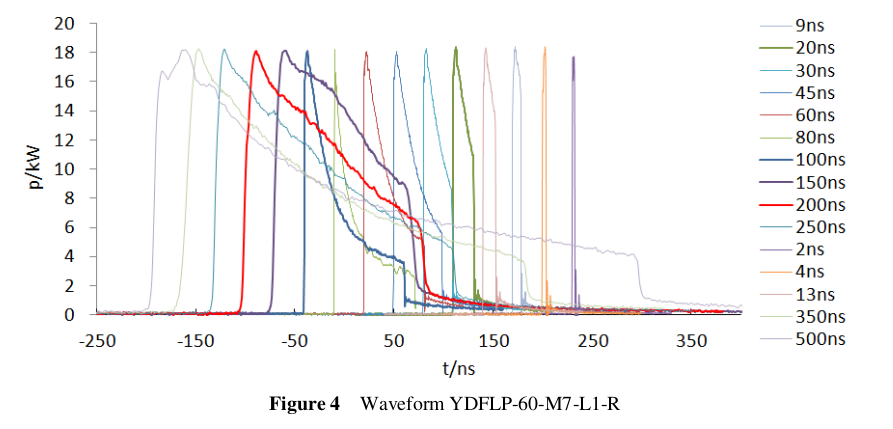

Fiber lasers are for man made materials, like metals, plastics, etc… CO2 and most of the visible light hobby are for natural materials such as cork, wood etc… These ‘overlap’ each other, a CO2 will cut acrylic very well … not really a natural product.
Also, your laser is a CW (continuous wave) laser, meaning it stays on… relatively long. The fiber laser is a pulse laser … the manual for my source laser, it’s 60W, shows with a 4nS pulse it will deliver 18kW of output power… you can only have this range of adjustments with a MOPA (Master Oscillator Power Amplifier) type laser source.
These are the various power levels, pulse times. There are a number of different parameters to these… I’m sure it’ll be quite a ride :grin:
