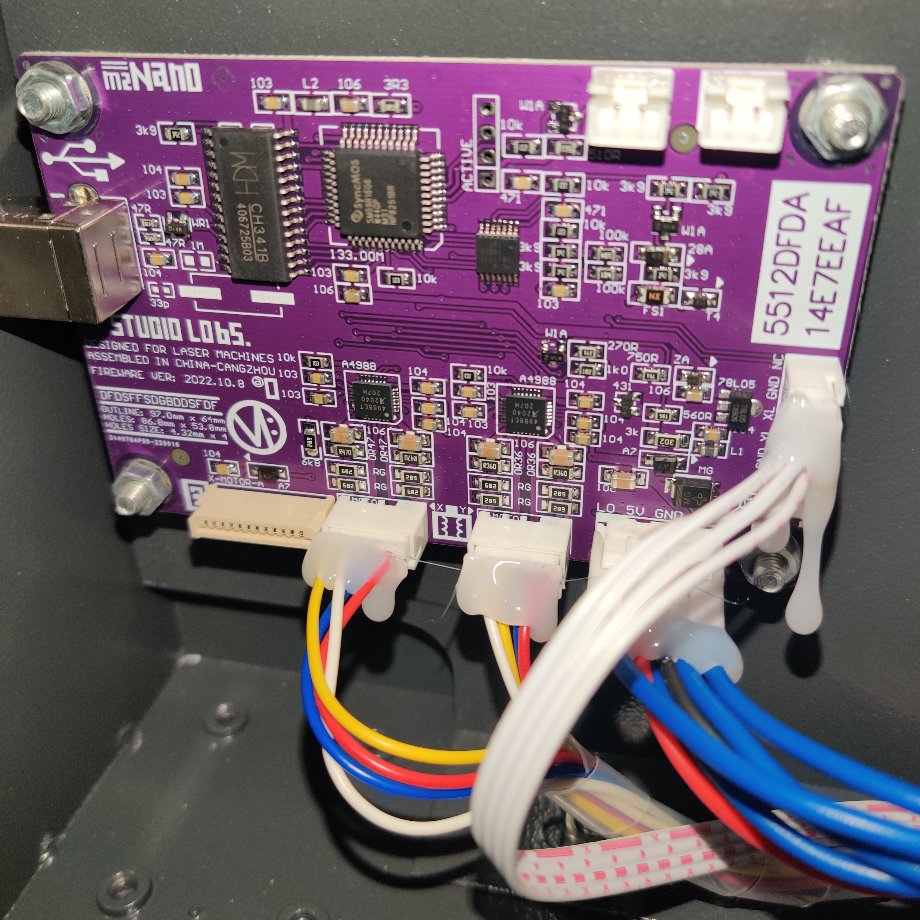

Russ, have you already upgraded the controller on the K40 and if so which controller are you using? The M2Nano controller which comes stock with most K40s works well with K40 Whisperer but to turn LightBurn many upgrade to GRBL or Smoothie compatible controllers for which LightBurn charges $60 for a license(any OS version - one license). The Ruida controllers are nice but not only do they cost almost as much as the K40 itself they require additional driver modules and often a 24V power supply too and the LightBurn license is 2x the price too.
So what controller do you have in your K40 now? Picture?
Doug,
This newbie is taking things a step at a time. Step one is to test my K40 “as found” for warranty and return basis. Therefore I am currently using a stock main board and K40 whisper and laserDRW. See photo requested of my motherboard.

Once my “as found” K40 stock system is fully tested then I have purchased both the LightBurn software license key, Windows compatible along with their recommended Lightburn compatible motherboard for K40 as follows:
K40 BOARD UPGRADE
Download The Manual
K40 LIGHTBURN COMPATIBLE: This upgraded K40 motherboard makes LightBurn work with your K40 laser engraver. The 24V K40+ control board is packed with cutting-edge features to bring new capabilities to your 40W laser engraving machine.
COMPATIBLE LASER ENGRAVERS: This K40 motherboard upgrade is compatible with all OMTech 40W Desktop Laser Engraving Machines. For other laser brands or custom builds, you will need a type B USB cable to connect your control computer. Also check the specifications section below to ensure pin compatibility.
SUPERIOR FUNCTIONALITY: This circuit board’s open source Smoothie firmware comes preinstalled and preflashed on its 512MB MicroSD card, able to work with your Windows, Linux, or MacOS edition of LightBurn to create breathtakingly intricate photorealistic grayscale images as quickly and easily as standard patterns.
Aware of the other Ruida controllers and want no part of this g for my K40.

Good work Russ, you are doing exactly the right thing by getting to know the K40 and getting familiar with laser cutting and engraving terminology and workflow. I do recommend you work with your K40 with K40 Whisperer for a few months before doing the controller and software upgrade. There’s lots to get to know. And please, please, please read through the K40 Intro link at the top of this page. I went through all sections of the Quick Help sections on this page when I started and learned lots about what I had, what I needed and didn’t need to operate the machine safely and so it lasted a good long time. https://k40.se
