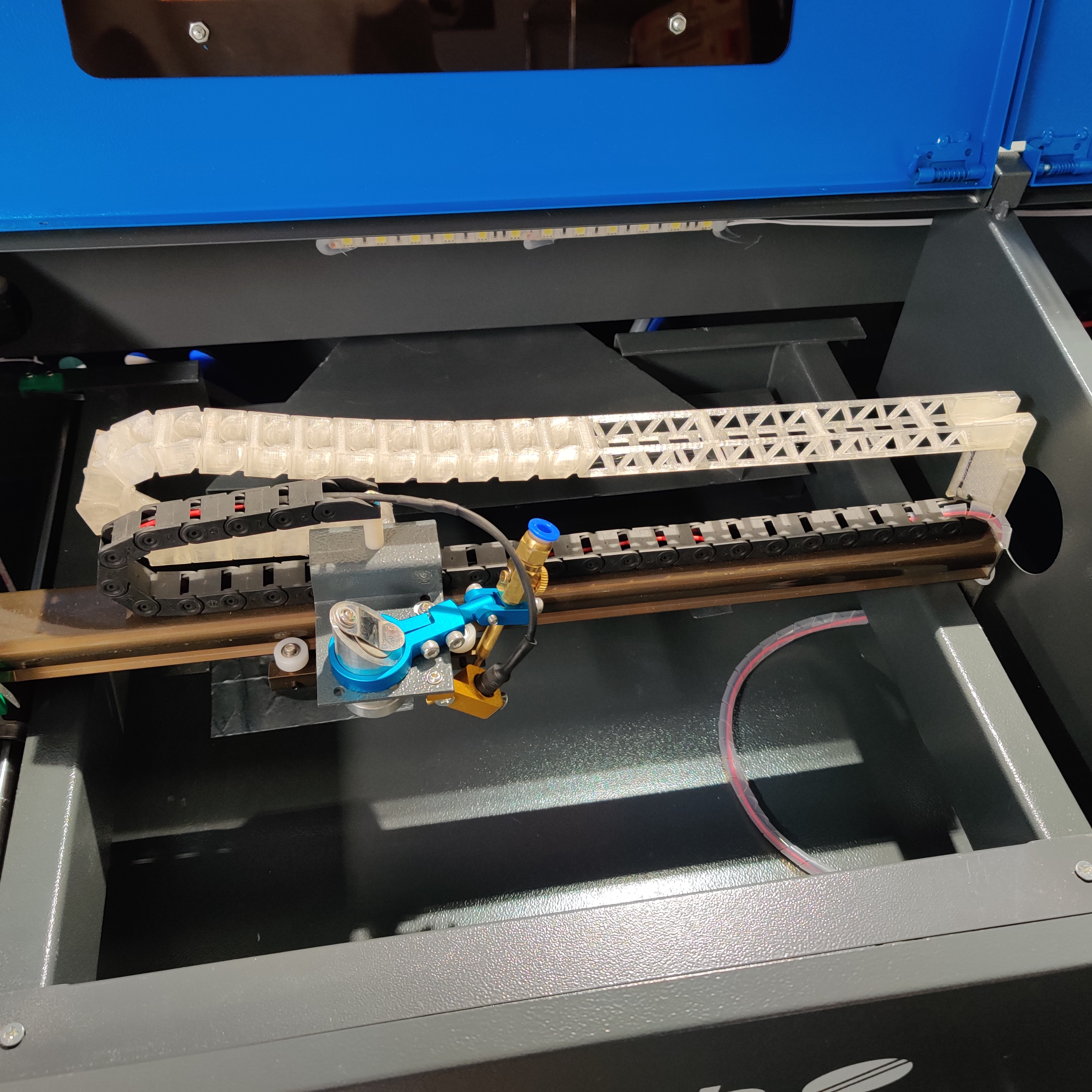

oh gheesh, I got off on that whole tangent of how I got to where my machine is and forgot to mention the drag chain thing. Some people put a drag chain along the Y axis and along the X. I opted to put a drag chain attached to the back right corner and with a small loop it attaches to the laser head. I had to adjust how it attached to the laser head so that it stayed out of the laser path when working at the far back of the machine. The trick for air assist is a flexible hose but also one which will not kink.
Thanks Doug. Can you share a photo of your setup when you get a chance? Attached is what I’m going to try with all the concerns you mentioned in mind ie to keep out of the laser path and also in my case my red dot guidance system when came standard on my K40. My air assist nozzle has a swivel bracket that can be adjusted to your needs . Have not completed this yet work in progress and still considering other options. The drag change I purchased attached to x axis gantry rail with some modifications.

I went out of my way to get rid of the drag chain entirely… :face_with_spiral_eyes:
Don’t need to haul all the extra/useless mass around…

Then where is the air line hooked to on the K40 enclosure internal wall or is it just hanging loose?
I hear you on the mass and going to clean up my setup after I test it . What size air Assist line did you use? 4 mm or 6mm?

Mine isn’t a K40, so it’s a little different, but same game. My air assist that come with the machine, was just an aquarium pump, nothing holding the air lines anywhere, except through the drag chains. There is still a drag chain on the Y axes. Losing mass on the X axes also causes less mass on the Y axes.
6mm X 4mm from Amazon.

Got it…Makes sense …I made mistake of purchasing a poly line that was too stiff. Ending up using this on tail end to connect to my compressor.
