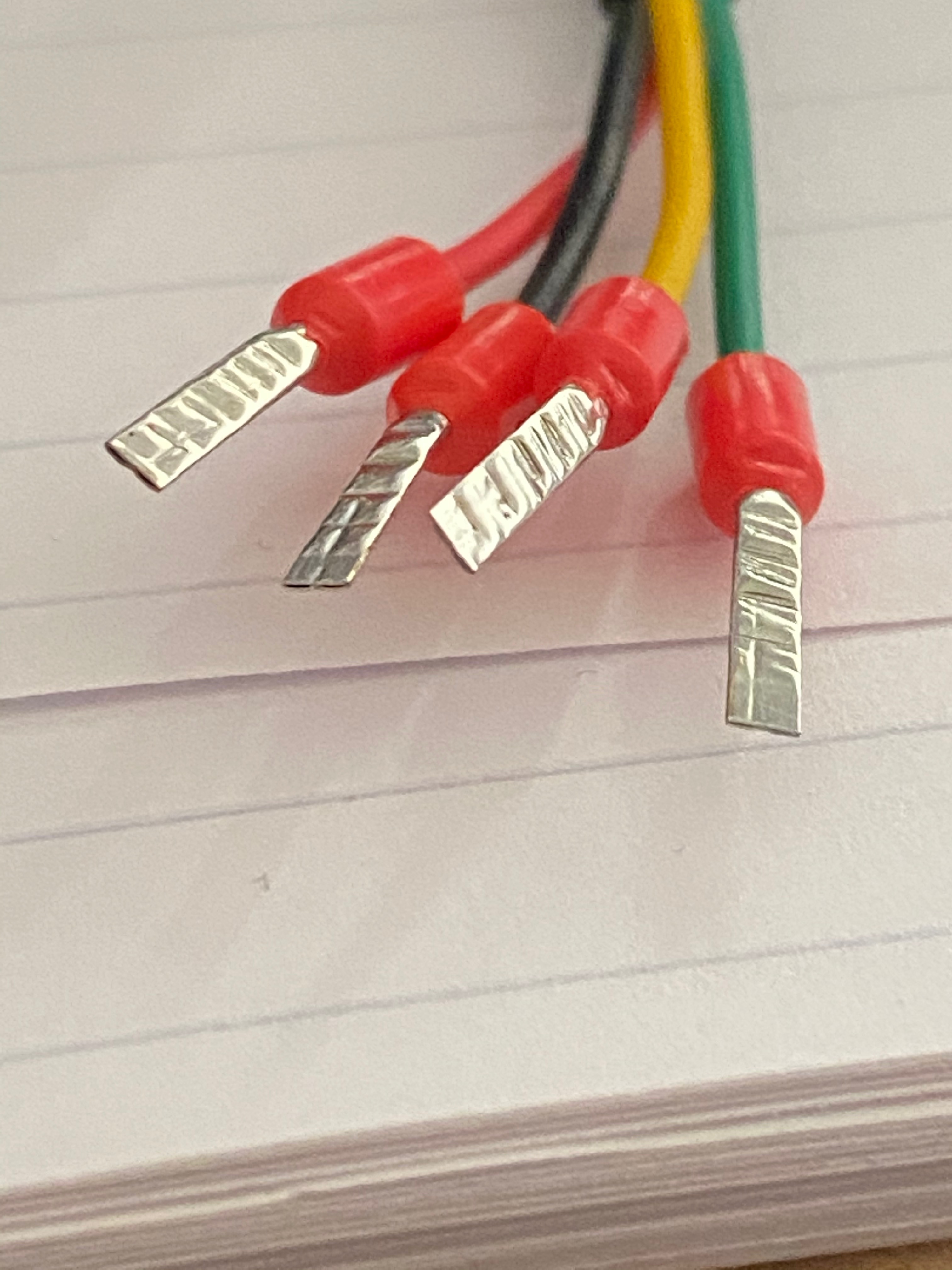

What kind of "ends" are these on this SHT30 sensor, and, are they meant to work with a plug-and-play connector?

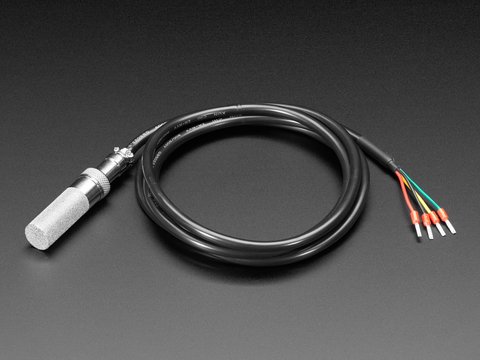

Hey guys. I picked up a few of these:
They work great, but right now I snipped the ends off and soldered it onto a prototype board for the Raspberry Pi. I’d like to get some PCBs made, and am trying to create a situation where this cable is on a male connector, that’s mated to a female connector on the device.

Those looks like ferules for screw mounting. What am I missing?
I’d never seen things like those before. Here’s a better pic.
Was wondering if there might be a quick solve to get it onto a user-friendly connector.
I think those are just crimped ferules for screw mounting.
I was wondering whether the other end is internally a DIN / “Aviation” connector though. The shell looks familiar. Something like this:
But I don’t think there’s any shell that would just hold those ends that you are showing.
Those are PIN terminals (or sometimes called ferrule terminal) used with screw terminals.
Actually they are a convenient way to connect wires to a PCB.
I use a pc board mounted screw terminal and crimp the pin terminals to the mating wires.

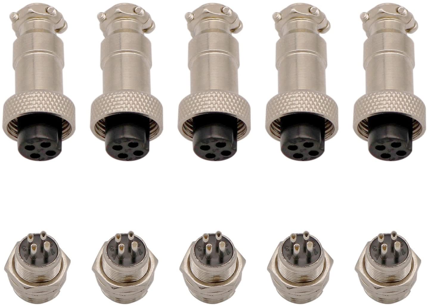

I was secretly hopeful there’d be some magical means to connect them to something like a GX12 4-pin for the finished product, those aviation-style connectors give a nicer “finish” to the product.
Conversely, to your credit, the screw connectors avoid all that snipping and soldering…
