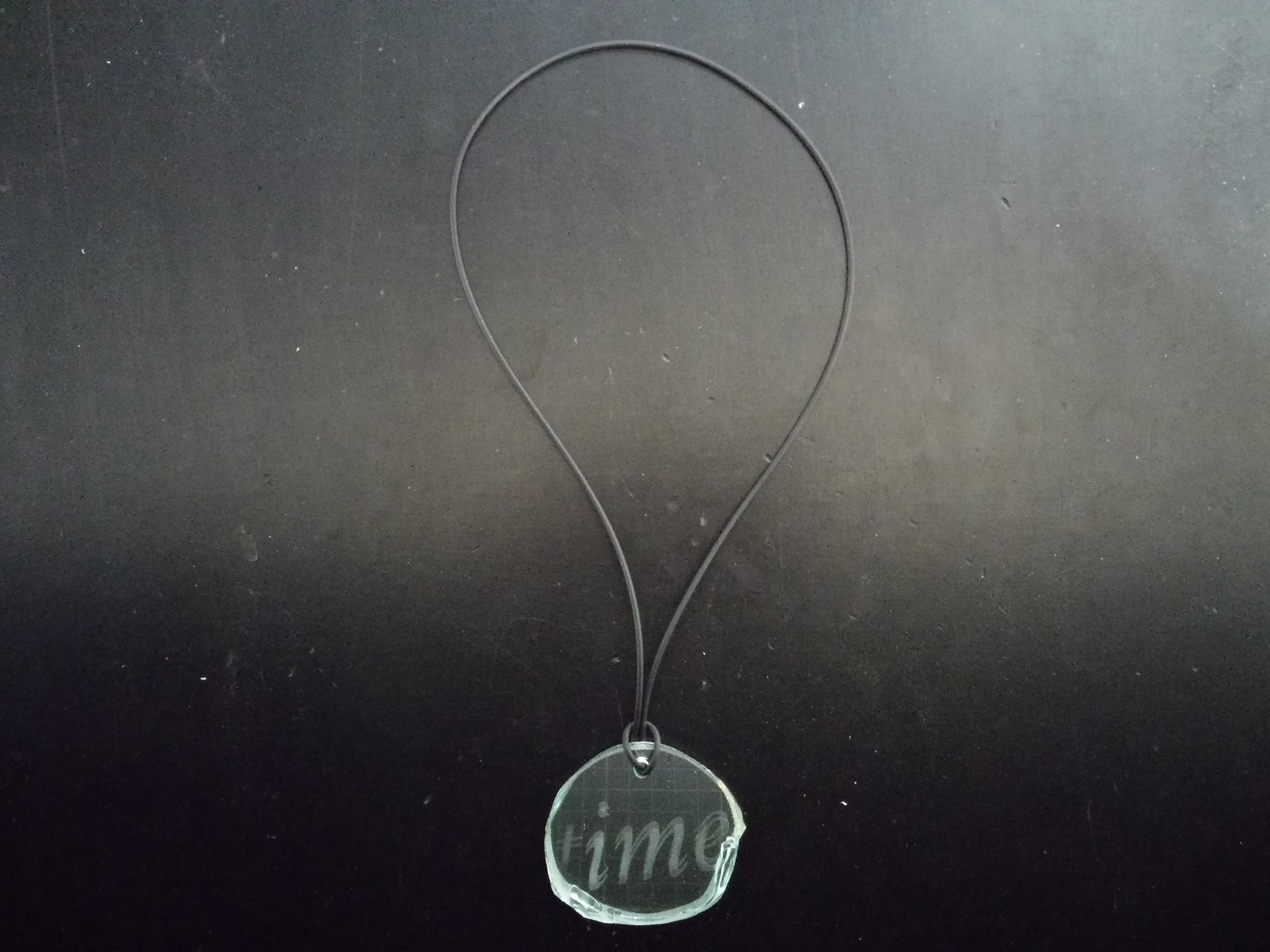

Right. Some materials are harder to cut, though. Glass would be an option, but it will crack when exposed to the beam for a longer period of time. A few years back, I tried cutting a circle into a mirror using a Trotec Speedy 400:
The hole for the pendant is drilled. While there are CO₂ laser cutters for glass, I recall they only work for very thin material, for example glass covers for displays.
