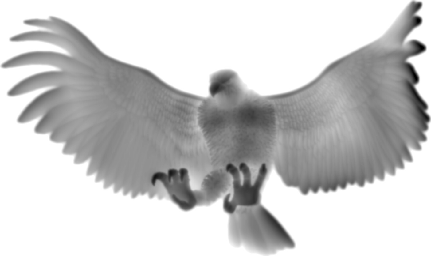

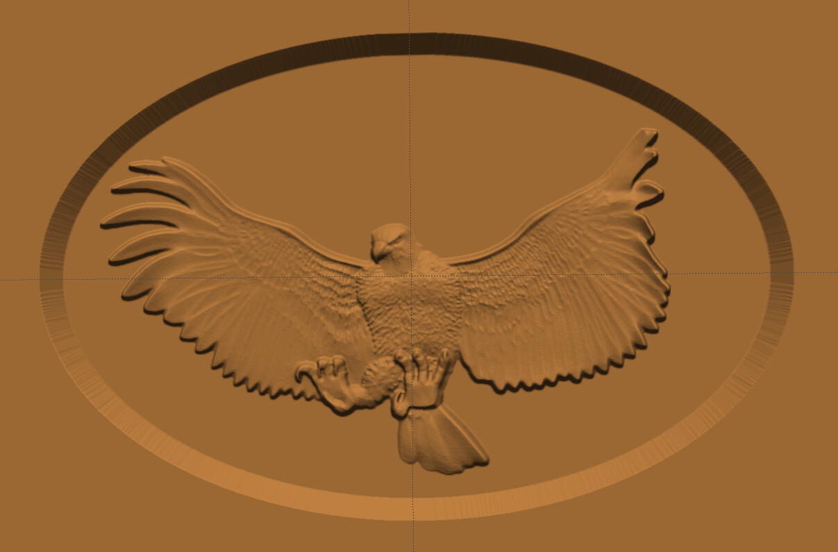

The pattern I make will be shared as a grey scale height map image and also test carved to ensure no issues.
At some point I need to make a Youtube video on how to use Blender 3d (free) to make a high quality 3d file for cnc carving from a height map image. It kind of sucks that VCarve Pro can’t do it. Aspire can. Zbrush can also make high quality 3d files from height maps.

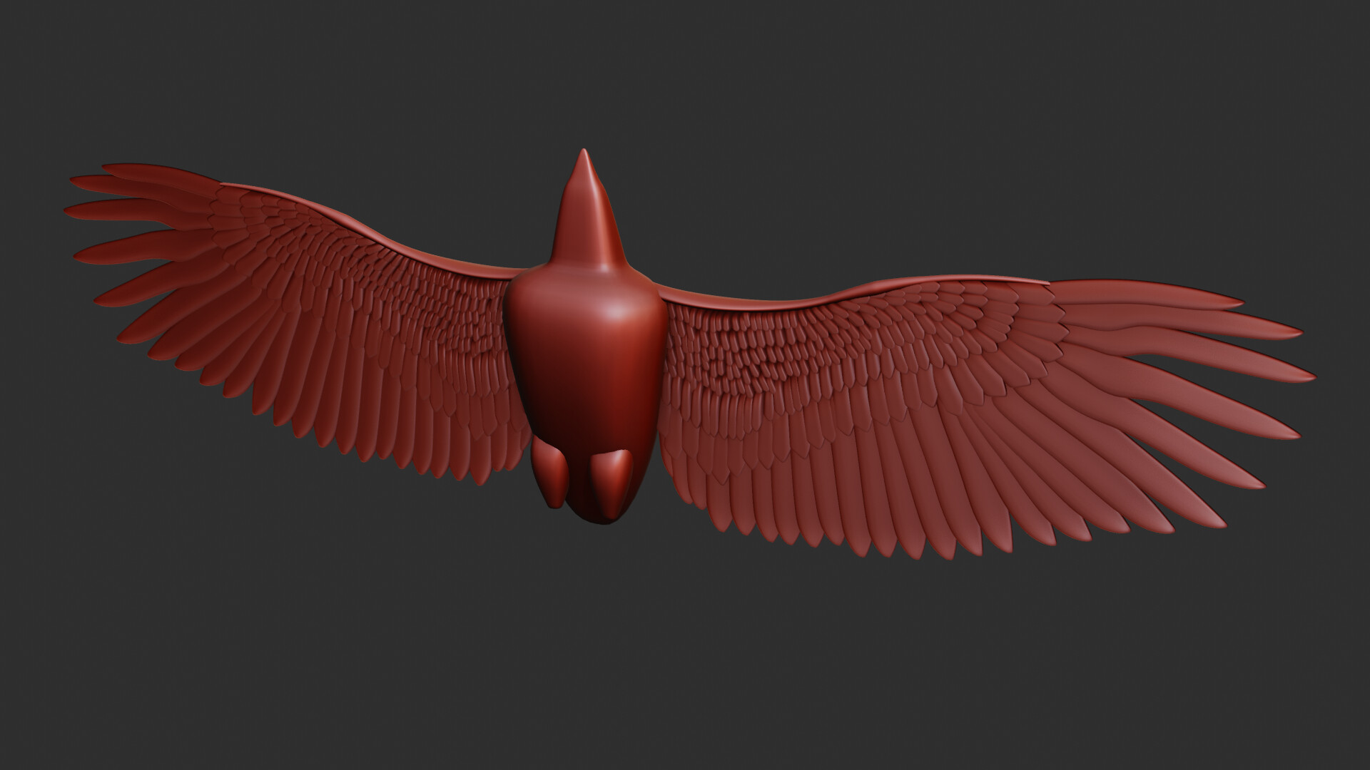

I’ve started the eagle base. Wish me luck. I think I am going to need it.

Hi, I don’t share the STL’s because typically they are very large files. Blender 3d, which is free, is also very good at creating geometry from height maps. You can then save it as an FBX, STL, or OBJ.
Its a 3-4 step process in Blender.
  1. Add a plane (subdivide to ensure enough detail can be achieved)
  2. Load the height map as a texture map (Texture properties tab - add new texture)
  3. Apply texture to the plane (Modifier properties tab- displacement modifier)
  4. Clean up model (optional depending on model)
This is what I ended up with. I lost a bit of detail in converting to 2.5d and reducing the file size. Started at 3GB for the full 3d model. I’ll test carve and see how it looks.
It carved okay. Good experiment build on how not to use particle systems for a cnc pattern. Looks amazing for 3d animations but is too massive on geometry to generate good patterns.
