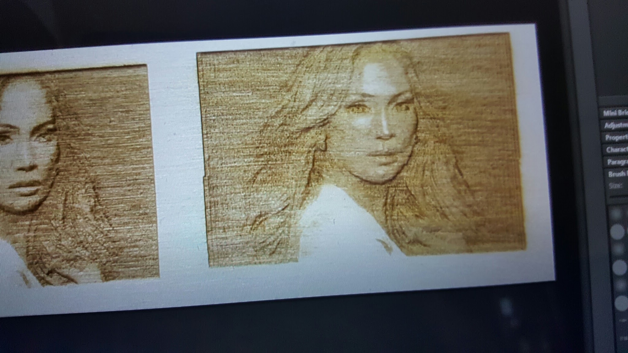

Claudio Prezzi The image seems to shift in the laserweb raster about 2/3 of the way down. Do you know what causes this?

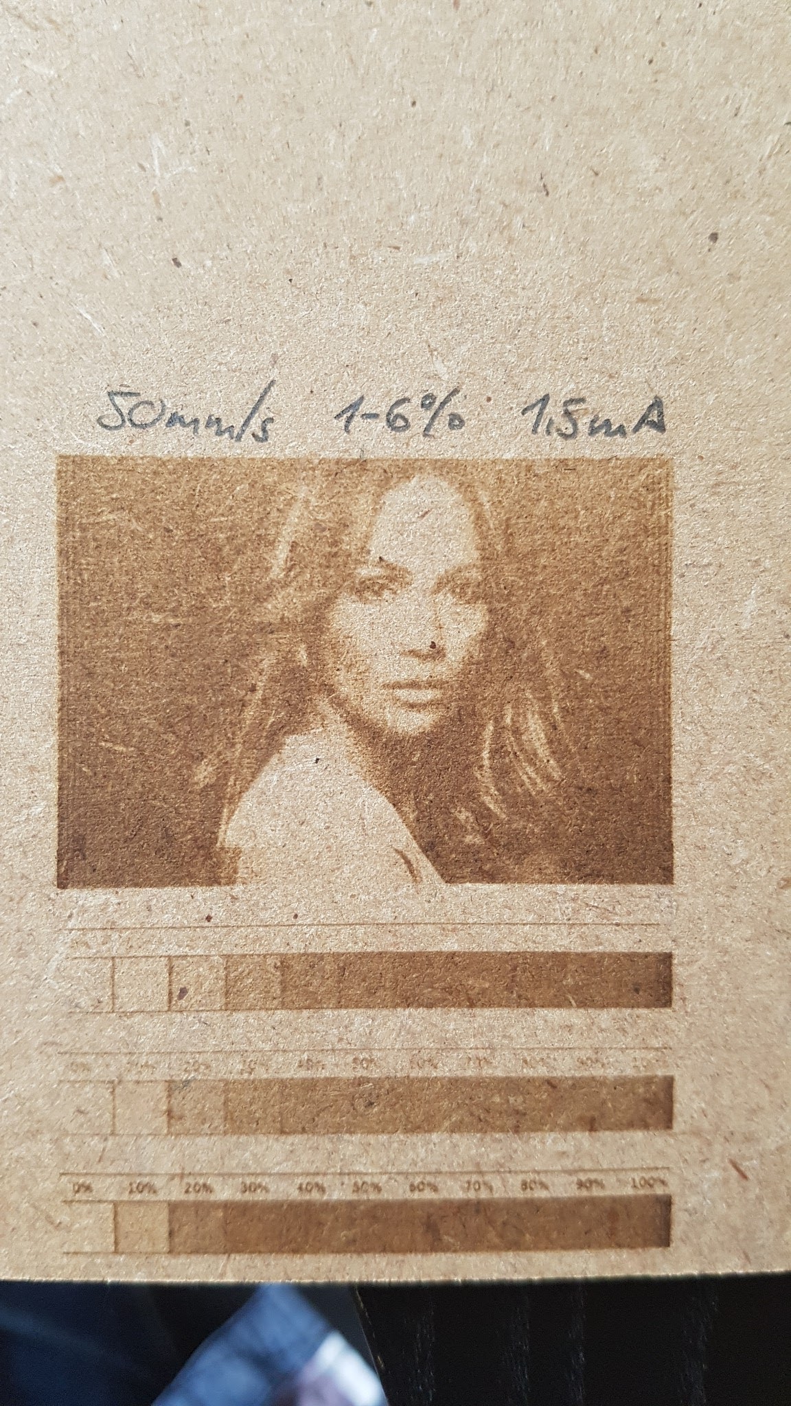

Pleeeease share settings! Will put as Claudio’s finest at LW materials
@cprezzi different material? Now MDF?
@Jorge_Robles The settings was 0.1mm laser diameter, 50mm/s, 1-6% power, ~1.5mA (als low as possible), pwm 200us.
@Ariel_Yahni_UniKpty Yes, mdf seems to deliver better grayscale.
@cprezzi also seems to be less prone to burning to black or deep
@Bonne Wilce I was not able to do any engraving with more power on pot. I only get black coal with 10-15 mA, no matter how low I set the power % in LW. Do you have the same type of LPS?
