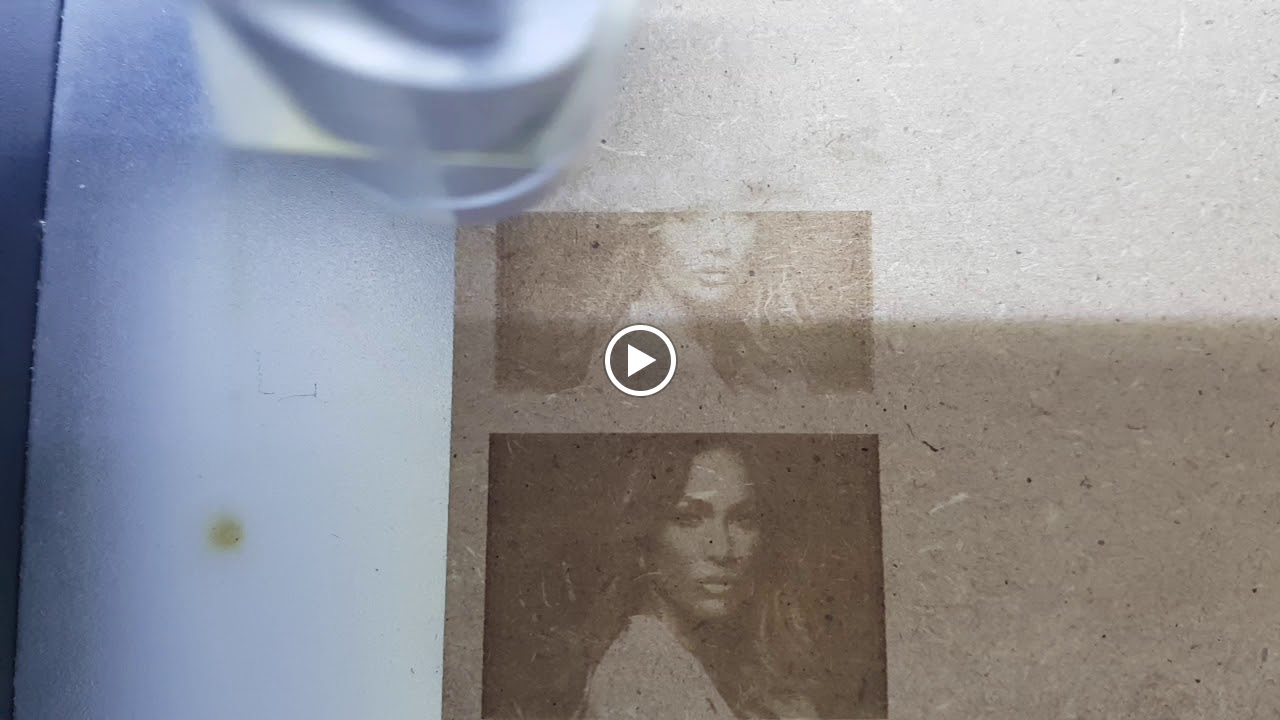

Today I got GRBL-LPC working on my K40 and the results are very promissing. 3x the speed of smoothieware! Nothing else was changed, only the firmware.

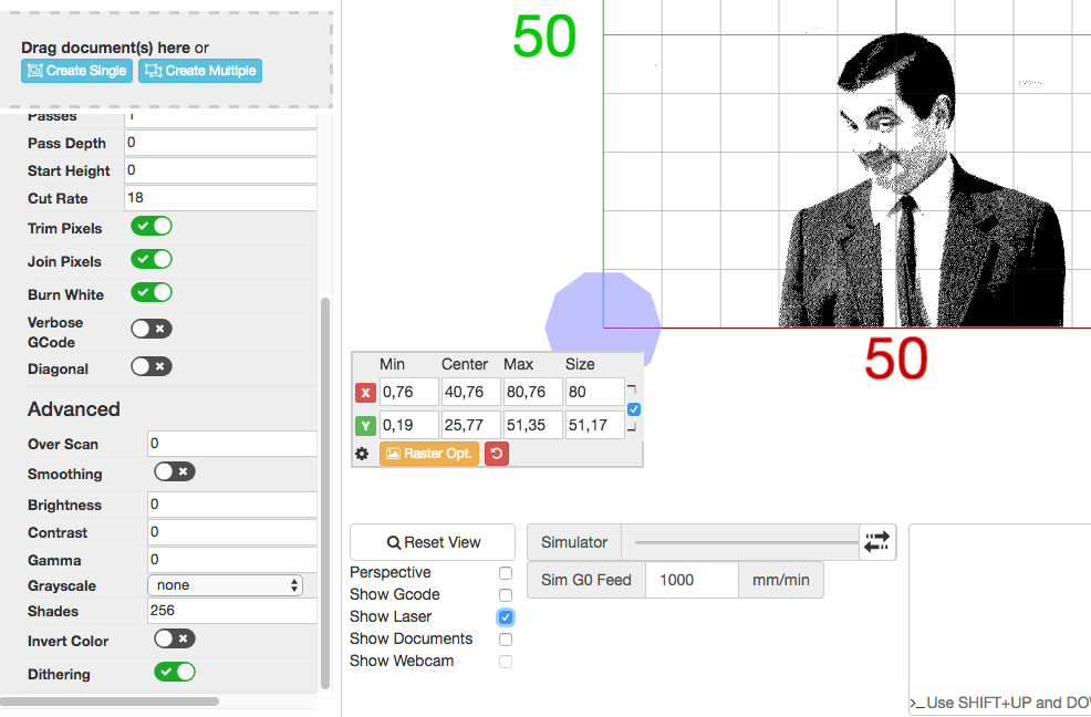

Btw. I’m about to add dithering to lw

Jitter free movement @ 140mm/s with grbl-LPC compared to 40mm/s with smoothie! Nobody could say anymore that Windows10 with it’s drivers and LW4 is not capable of these speeds.

@Jorge_Robles @Bonne Wilce I have compiled my own bin, because @Todd_Fleming s default PWM frequency (40kHz) was to fast for my K40 to get any grayscale. I use only 5kHz (=200ms, like on smoothie).
In the meantime Todd has added a 5kHz version to his bin’s
