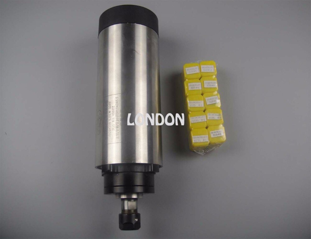

I consider a motor something like this one:
(I have a 1.5Kw Toshiba VFD).
Air or water cooling?
All the same or should I consider a special brand/model…?
Other spindle I should consider (not to expensive) ?

I use a 65mm 1.5kw watercooled spindle on mine with a VFD drive. I made a cooling tower for it that you can ckeck out on openbuilds
http://www.openbuilds.com/builds/spindle-cooling-setup.4080/
Water cooled will run much quieter than an air cooled spindle, and bearings seem to last longer.
I updated my CNC with one of this 800W air cooled.
The standar cooled required a min speed of 7500 rpm and recode the VFD to 2 poles motor. Max speed is 24000 rpm.
I use these 1.5KW chinese water cooled ones with a cheap 400Hz Hunanyang VFD and I control via RS485 from MACH3.
Works very well.
Don’t use an air cooled one unless you don’t care about the terrible noise for hours and hours. I’m currently planning to upgrade to an expensive ATC spindle that needs a 1000Hz VFD and won’t use mine anymore.
Huanyang Inverter is the brand of my VFD. I have spoken to other makers who use the same VFD and they all seem to be pleased.

Go 2.4kw so you get a 13mm collet and water cooled is quiet.
