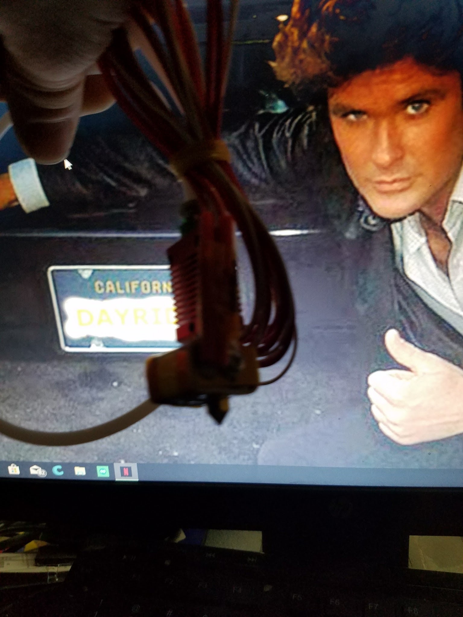

I replaced the thermister and heater with a set that I know works, seems to be running fine.
@DayRider76 Honestly, just toss the old ones. Not worth the safety risk in keeping them around.
@ThantiK I hear ya, one of my other printers is still down from a fire almost two months ago. I have it back together but this printer has been eating my time?
