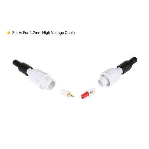

If you just want a connector, try:

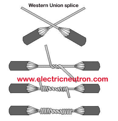

For more information, including how to splice two high voltage wires together without a connector, read:
