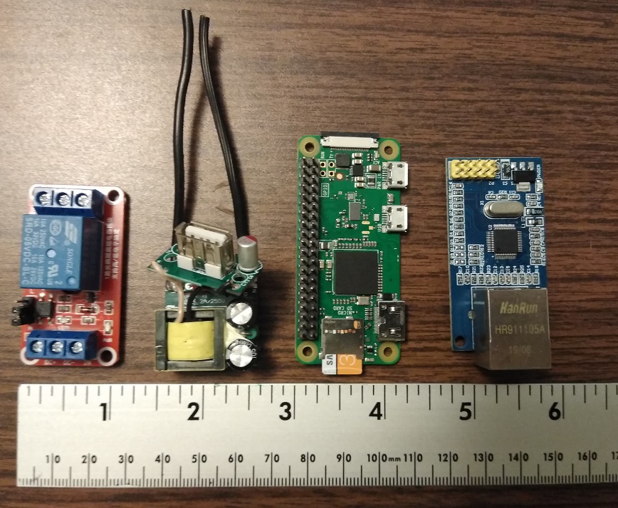

Hi guys, I’ve got a pretty simple device but I’d like to make it smaller.
The largest components are:
  • Pi zero - which I’ll replace with a nanopi or some other cheap/small SBC.
  • W5500 Ethernet board - which maybe could be replaced with something like this but I don’t know if you can just wire that to the gpio(?).
  • A relay - this one looks smaller.
  • USB/AC/DC power adapter (just disassembled one I had lying around) - I’m really lost on this one. I got a little help here but I’m still not sure what to buy.
Finally, if possible I’d like to just get all of these things put onto one board (with the possible exception of the nanopi). Obviously cost matters so for example, I wouldn’t want to spend $10 more on a slightly smaller relay.

Key decision time:
  • If you base your work on the ESP32 (not capable of running Linux, but has a RTOS) it’s easy (as these things go) to grab an existing design and modify it. This is what https://project-hermes.com/ has done to create a single integrated board for ocean temperature sensing.
  • If you want Linux, look at complying with the standards for breakout boards for your platform. For Raspberry Pi, look at the PiHAT; for BeagleBone, look at capes
Note that using Linux on ARM means also learning device tree, not just “big banging”, typically. I recommend getting a copy of Derek Molloy’s Exploring Beaglebone for BeagleBone, or Expoloring Raspberry Pi for Raspberry Pi.
Getting started is a bit easier on ESP32; you can start with Arduino if you are already familiar with it, but can also choose lots of other environments, and all you need to do is explicitly and directly set up port mappings. And you’ll get wifi and bluetooth out of the box, and you can add ethernet by connecting a PHY to the correct ports; see https://kazkojima.github.io/esp32-phy.html for example schematic. See https://leanpub.com/kolban-ESP32 for more information on ESP32.
ESP32 is also easier to integrate into a single board, in part because it’s designed for that purpose.

Processor:
You could reduce size by combining processors and device libraries. Most of these single board configurations are built for generic use. Customizing the hardware, removing unnecessary components, can reduce space. To provide advice the amount and type of processing necessary would need to be defined.
Relay:
Smaller relays are available and you can replace the relay with a small Mosfet. The characteristics of the load your are driving would be needed to design the driver or substitute the relay.

The hard work here isn’t laying a component on a board and routing some traces. It’s designing the schematic for the circuit, looking for flaws in the schematic design, working out a board shape that will hold the parts and meet your physical constraints, selecting appropriate design rules for the application domain (which, given that you are talking about a relay, includes being specific about voltage and current capacity, and current capacity depends on physical constraints for dissipating heat), choosing components that meet your needs (including connectors that will be safe given your constraints), laying out the board, checking the design for defects including thinking through potential failure cases, etc. You bring up a relay, so you are probably doing this in order to switch a high-voltage and/or high-current circuit, possibly switching AC.
As a hobbyist, I’m inconsistent in knowing what could go wrong — there’s a reason for engineering certifications here! I know some of the things that can go wrong here, but I’m not trained in all the things that are reasonably likely to go wrong. I can imagine some things? What happens if your relay welds closed and doesn’t turn off? Does it create an unsafe condition? Have you properly separated low-voltage and high-voltage sides of your circuit board? If you are switching AC and decide to replace a physical relay with a solid-state relay (SSR), do you know that its common failure mode is to fail on? I’m not giving legal advice of any sort here, but if I personally were selling electrical devices I would be getting advice on liability…
Reality-check, since you say you are in it for the money: The high-value things you can do in the market with an embedded network-connected computer and a relay are vanishingly small. Make sure you are aware of what people are doing with sonoff switches, which are based on the 16-bit ESP8266 predecessor to the ESP32, before you invest.
