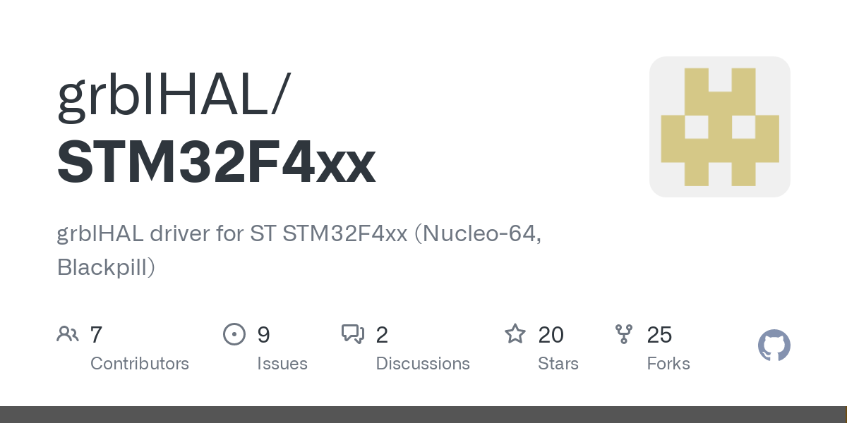

It has a 32 bit stm32f4 chipset so would GrblHAL run on this board with the pins allocated accordingly?

It’s not listed here that I can see:
It is supported by Klipper and Marlin so the information is out there, but it looks like it would take development work to support that board in particular. That development would probably mostly be a pin map, but I haven’t looked into how to do that.

it ships with Marlin and I would expect the source for Marlin they used which would have the pin mapping defined in those sources. I don’t see why ohming out pins would be needed.
that’s a fair comment doug, I’d just have to make sure the grblhal pins correspond to the Marlin ones I suppose.
