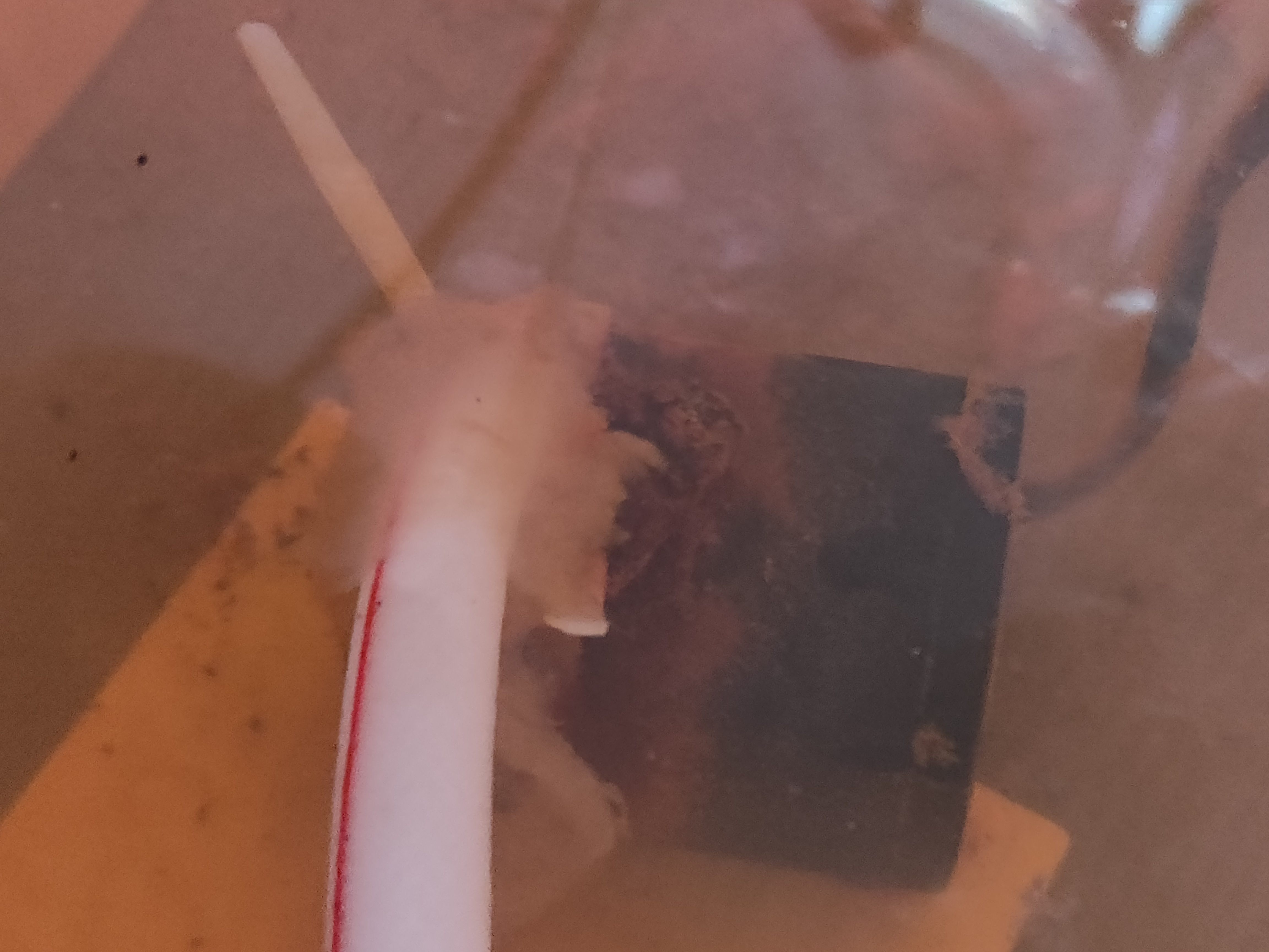

Thanks for the link to the article! Concerning Tetra Algae Control: In our case, mold seems to be the bigger problem. On the bottom of the tank, there is red slime. Growing from the pump is white slime. The inside of the tubes is covered with black deposit.
I read that some use a small amount of bleach in the water. Originally I was thinking that this is a bad idea as it is corrosive and it can damage the rubber seals and tubes. However, after seeing the mold problem that we have, I’m reconsidering. In the end we probably have to replace everything.

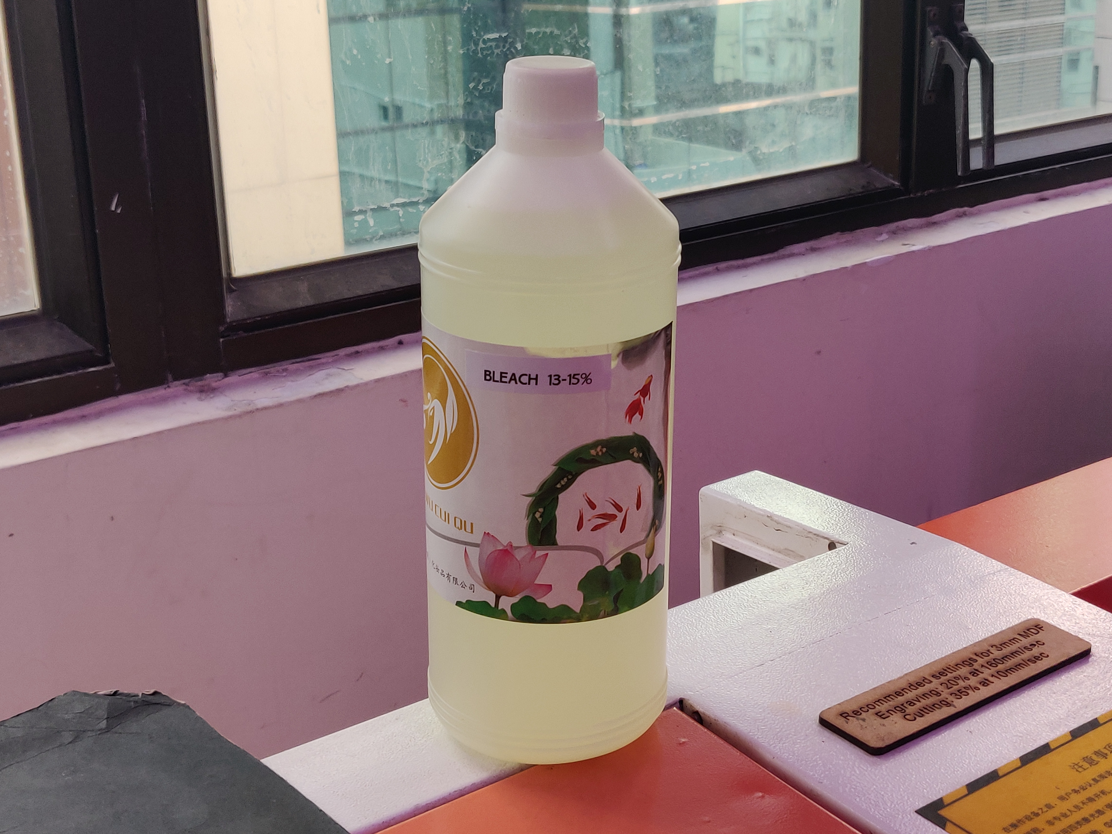

Indeed it now has happened: Within weeks, maybe even days, we had stuff growing in the water cooling system for our laser. So I went to the chemist and bought some bleach:
This should have no additives. In the article LaserGods article Laser Water Coolants & Additives it says: “Testing has shown that 6 ml of Clorox with 5 gallons of water gets a conductivity reading in the neighborhood of 40µS/cm and this is a sufficient amount to inhibit the growth of bacteria and algae.”
I know there is varying, even opposing information on the web, but yesterday I decided to go for bleach. That is, after replacing all the tubing again, including the pump, which is now much stronger at 45W. I did this also to move the water tank to a more accessible place, which requires longer tubing.
