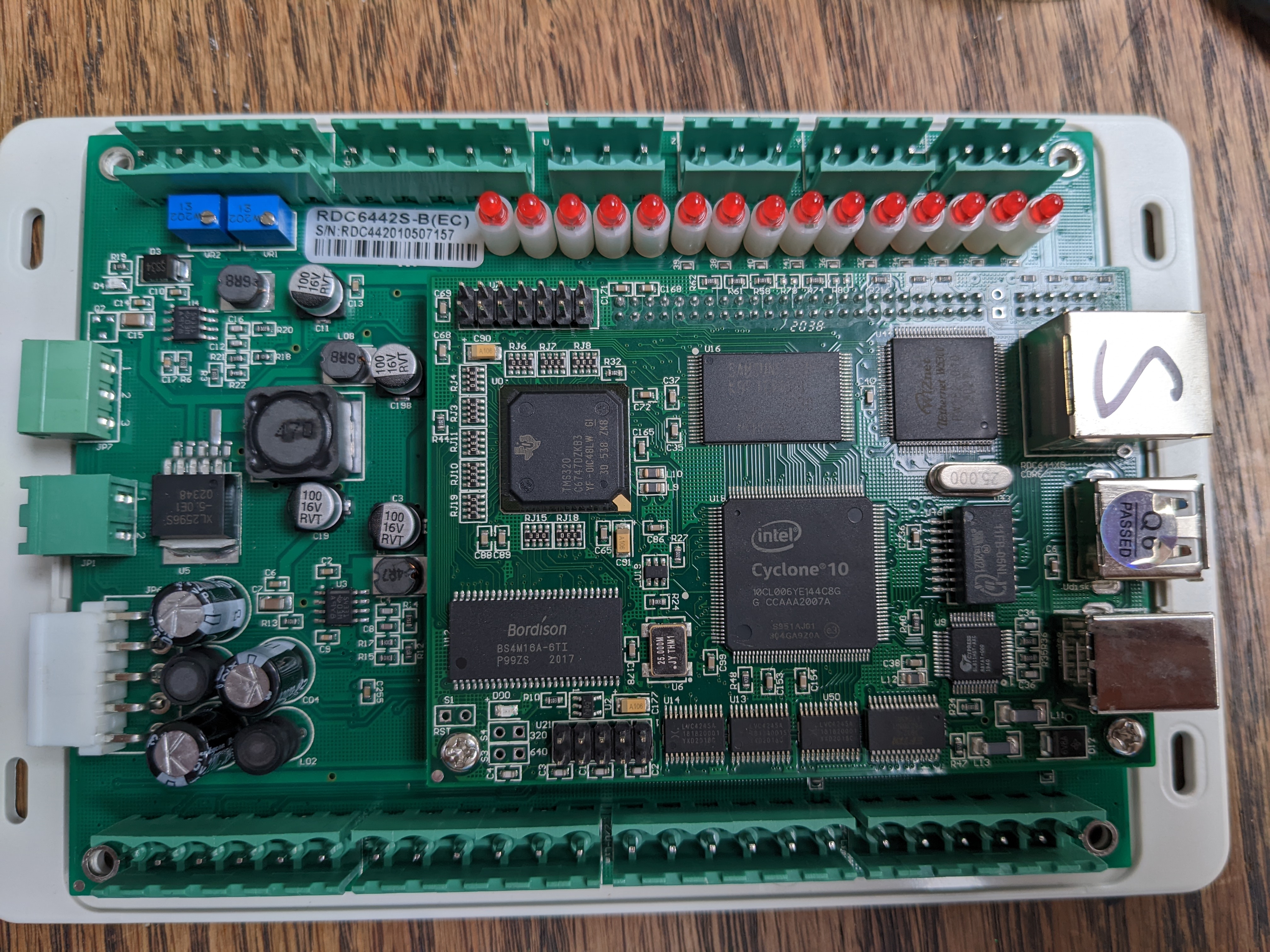

for specs of the Ruida hardware I’m finding the following interesting chips in the 6442S. There are other support chips like an 10/100 Ethernet controller and USB2.0 not listed but you can probably find them in the image below. Info: RDC6442S/G | RuiDa Controller
TI 320C6747 DSP 456MHz
Intel Cyclone 10 10CL006 FPGA
Samsung 028 K9F1G08U0F 1Gx8bit flash memory - 256MB x32bit
Bordison BS4M16A 4Mx16 DRAM
