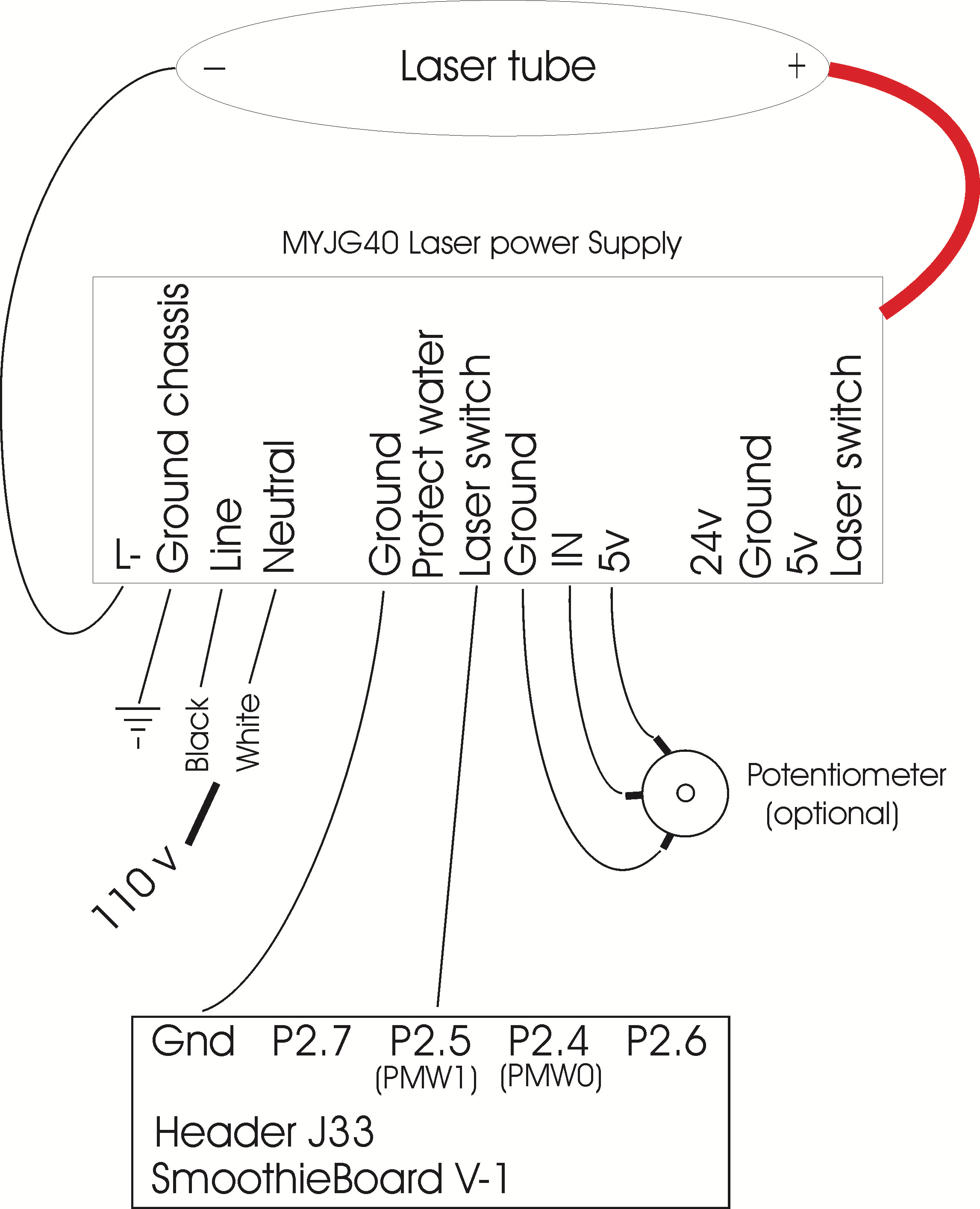

Please forgive the rookie level of understanding.
Thought it best to ask for guidance before making connections and powering up.
For me … pictures work better then verbal descriptions.
This is my version of a schematic.
Does it appear correct ?
Still confused regarding the water protection circuit.
Should it be connected to ground if not being used ?
Can a potentiometer be used in conjunction to PWM ?
Thanks in advance
Steve

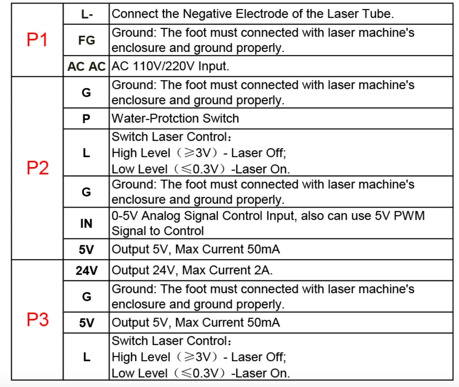

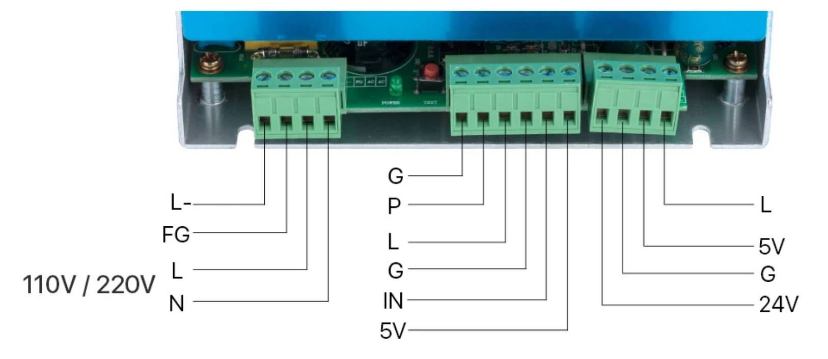

This in the PSU connection
The pinout function list
