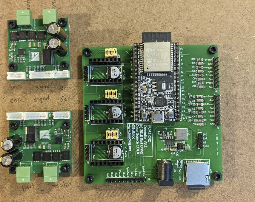

With the two Tarocco servo control boards and Bart Dring ESP32 controller board mounted, I wired it all up. The Tarocco boards take STEP/DIR, so I made JST-PH-6 (2mm pitch) to dupont male harnesses for STEP/DIR on one side of the step sticks, and GND/5V on the other, ignoring the rest of the positions. I hooked up X and Y limit switches with a few dupont female connections. I connected the encoders from the servos which required making JST-PH-4 harnesses. I hooked up a MeanWell 24V power supply to the barrel jack on the ESP32 CNC board and each of the servo boards using bootlace ferrules, and connected the motor power wires also with bootlace ferrules. I put a fused C14 plug on the supply side of the MeanWell.
Using dupont, JST PH, spade connectors, and bootlace ferrules meant that I had to use four different crimping tools. This is the geek life!
This wiring looks so ugly that I didn’t bother taking a picture; it’s meant just to let me try out this board. I’m expecting to migrate to a different board soon.
I watched my DHCP server to see what IP address the ESP32 would come up on, so that I could connect to it and configure the system. However, the ESP32 never seemed to request a DHCP address, so I thought I’d look for debug messages via USB. I connected the ESP32 usb port to my laptop, and my laptop screen instantly went black and the fan started going full speed, and the power button did nothing even when I held it down for 15 seconds. This was scary; this is a relatively new laptop, only two years old, and I really really don’t want to buy another one… Fortunately, the reset button worked and the laptop is back, but now I’m reconsidering my choice. I think I need to pull the ESP32 dev board out of the carrier and take this one step at a time. And maybe I’ll connect it to a different computer first.
My hope was to quickly get to running gcode just to move the X and Y axes, but that’s looking less likely now.
Having calmed down a bit, I powered the board back on and poked around with a multimeter. I measured 4.9V on the 3.3V bus, which is provided by the ESP32 board from a 5V supply. When I remove the ESP32 board, the 3.3V bus has no power. Either:
  • The 3.3V LDO on the ESP32 board is fried, or
  • One or both of the servo boards is feeding 5V down what are supposed to be its STEP/DIR input data lines, or
  • Something is mis-wired, or
  • Something is mis-labelled.

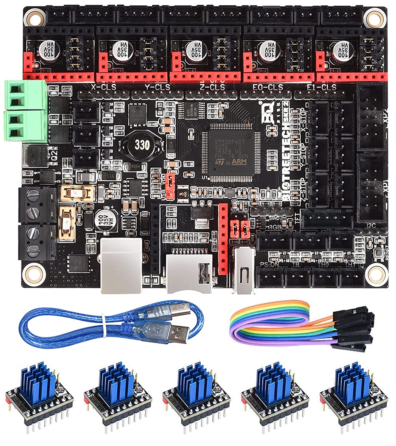

But I’m thinking that spending $50 or so on a better board might make sense… Here are some possibilities in that range.
The Octopus explicitly calls out Klipper support. I ordered it for that reason. I’m guessing that Klipper support means it’s likely to be easy enough to support in Remora at some point, but also I could do a switcheroo with my MKS sbase if I needed to.
The Octopus uses an STM32 and Remora runs on the MBedOS platform which doesn’t yet support STM32. We’ve been sticking with testing LPC1768 and LPC1769 boards. I think that means any of the Smoothie based boards. The SKR v1.4 and v1.4turbo are the easiest to support and have replacable drivers. TMC2208 and TMC2209 are currently supported with TMC5160(?) in the pipeline.
I “like” how the BTT SKR 2 calls itself “SKR V1.4 Turbo” in the description, then, since it has a STM32F407VGT6 processor.
Looks like this would run Remora:
But when I’m using only external drivers, buying 5 2209 stepsticks that I’m not expecting to use is annoying, and I can’t find it bare. Not even on aliexpress…
I’m curious, though; MBedOS looks like it supports the STM32F446ZET6 on the Octopus — am I missing something? It’s explicitly listed in supported debug tools at Mbed — PlatformIO latest documentation and if I grok the naming convention right this is the target:
Similarly for the BTT SKR 2 with the STM32F407VGT6:
Not saying that makes Remora magically support either. I see #include "LPC17xx.h" and I’m sure more work would be needed. But is it actually related to MBedOS support?

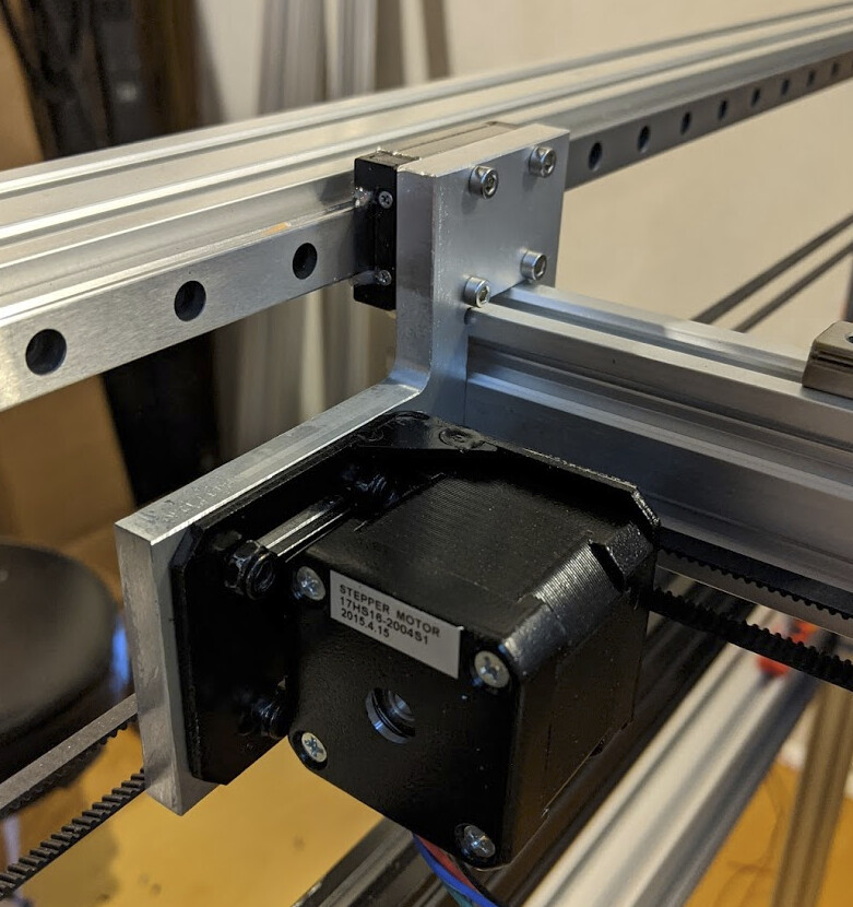

I made a new left gantry mount out of 8mm aluminum stock. Now almost all my X gantry hardware is aluminum rather than plastic; I just have a few belt clamp pieces still printed. No need to replace them; they are working fine. The new gantry mount has slots to mount a NEMA17 angle mounting plate, such that the shaft is in the same place as the servo shaft previously was. I do need to re-route wires. I’ll have to disassemble the dupont connector at the end of this 1M integrated bundle to feed the wires through the drag chain.
Next step is to mount the Y stepper where the Y servo was under the first mirror platform…
Milling out the slots to accept M5 hardware is a hair-raising business:
(Very easy, but look at those hairy chips!)
I used a repeatable setup and did this for both X and Y motors.
I have four screws through those slots into slide-in T-nuts in the shelf that holds the first mirror:
I got it roughly positioned, then was able to snug one screw just barely enough to hold it in place while I slid the motor out of both the pulley and the mount. Then I made sure the mount was square, and tightened all four screws holding the mount to the shelf. With that fixed in place firmly, I slid the motor back in, shaft going through the pulley, then put the M3 motor mount screws through the face of the mount into the motor, and then finally aligned and tightened the pulley on the shaft.
This view lies; you can’t actually tighten the mounting screws near the back of the motor.
This view shows why. What was amazing was that I was able, with a ball-end hex wrench, to tighten one of the front screws enough to keep the mount steady for disassembly.
The belt is tight but not over-tight, and I now have the physical part of my X/Y motion platform back.
