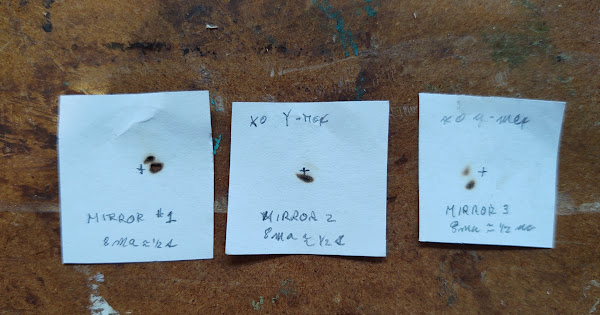

There are two beams coming out of the tube to mirror #1. Here is a link to the test strips from all 3 mirrors with 8ma drive for about 500 msecs. It occurred to me that the beam could be piercing the test paper, hit a defect, and then create the second hole by reflection. To test this, I also pulsed the laser with a piece of veneer. Two dots with nothing on the back side. Two beams are coming from the laser. The other strips are taken with the carriage at the extreme X and -Y positions. Not perfect alignment, but also two beams coming into the third mirror.

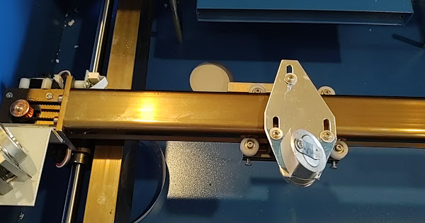

I checked the squareness of the X-Y anodized bronze rails. They are about 2 m.m. out of square over total travel. It doesn’t seem possible to maintain accurate alignment of the beam with this distortion. I could feel no looseness of the rails or means to square them up. It doesn’t sound like a bind that’s creating the noise, but could a misalignment of the rails trigger asynchronous operation with the steppers?
I thinking of taking the drive mechanism out of the case and squaring it. Have you done this or know anyone who has? While it’s out installing the air assist would be easier. In short I’m thinking of a minor rebuild of the system - alignment, mirrors, and air assist. OTOH, I hate to “solve” a problem without truly diagnosing it.

Your loss of power is most likely tied to the double beam coming out of the laser tube. You either have a damaged mirror on the tube itself or your tube has shifted to a different TEM mode (TEM01 gives 2 spots). Either one is not repairable and would require a new tube. If this is a new machine I would contact the seller.

In the video is the head suppose to be homing? Is your home set to the back left? I ask because the sound is still heard even after the x-axis motor has stopped. If this is the case I would suggest checking the y-axis belt tension and any couplers present going to the y-axis motor. (note there is a belt on both sides of the gantry for the y-axis, the one on the left is typically the drive belt)
If you need to tighten the y-axis belt there is a small hole in the back of the machine inline with the y-axis belt. The pulley at the end of the belt has a screw tensioner that you can access through the hole with a long screw driver.

I took the X-Y assembly out of the machine and found the right-hand Y axis belt was completely slack. I tightened it as well as the left-hand belt and the grinding noise is gone! Thank you, again, for all your help.
