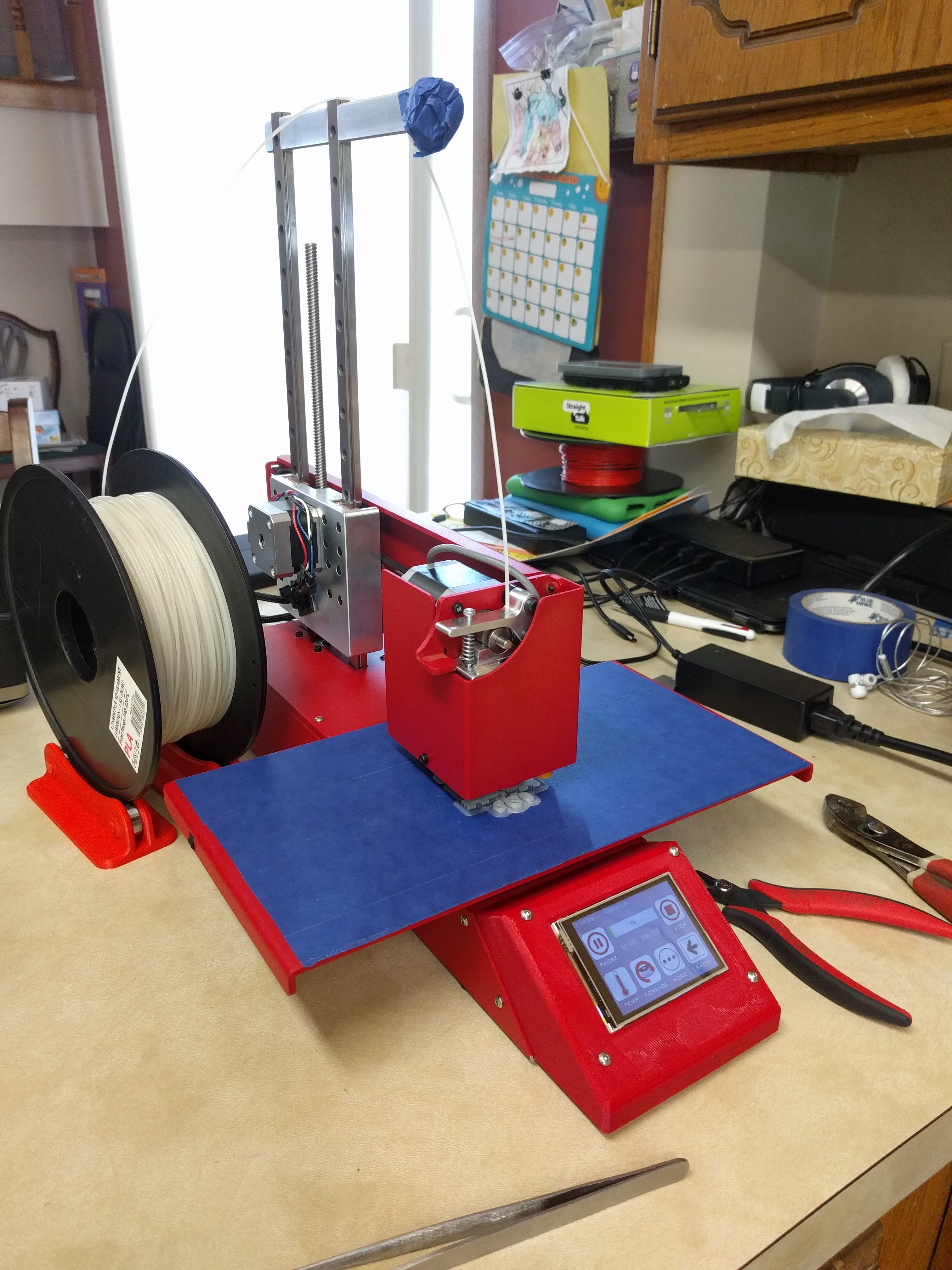

Working on wrapping up the adoptabot for the local Robotics club at a school
Working on wrapping up the adoptabot for the local Robotics club at a school my friend teaches at. It was a gracious frame donation by @Brook_Drumm ​​ and the amazing group at Printrbot. It looks to have been a prototype simple pro. But this one is rocking a printrboard F5 instead of a G2.

@Sonex128 MKS TFT28 (LCD touch screen and they have an esp8266 module that can plug into it). Just connect via TX/RX/5v or 12V/Gnd. The LCD has its own OS and can stream control commands and gcode to the printer. I like it because the graphics and configuration is customizable, including custom buttons (gcodes macros). I did a full skin mod of it for a printer design for SMW3D.

Great job! I love the blue tape hack on the handle!
@Brook_Drumm yeah, spool location and path is one of my last things to tackle. But the blue tape is working while I come up with something. I would do a rod on the side of the handle like the regular simple pro, but my wiring on the outside of the y-arm makes that a little trickier:

@Jeff_Erenstone It is a Printrboard F5. I had to solder on some pin headers onto EXP1 location on the board, then hook up TX/RX/5V/GND.
